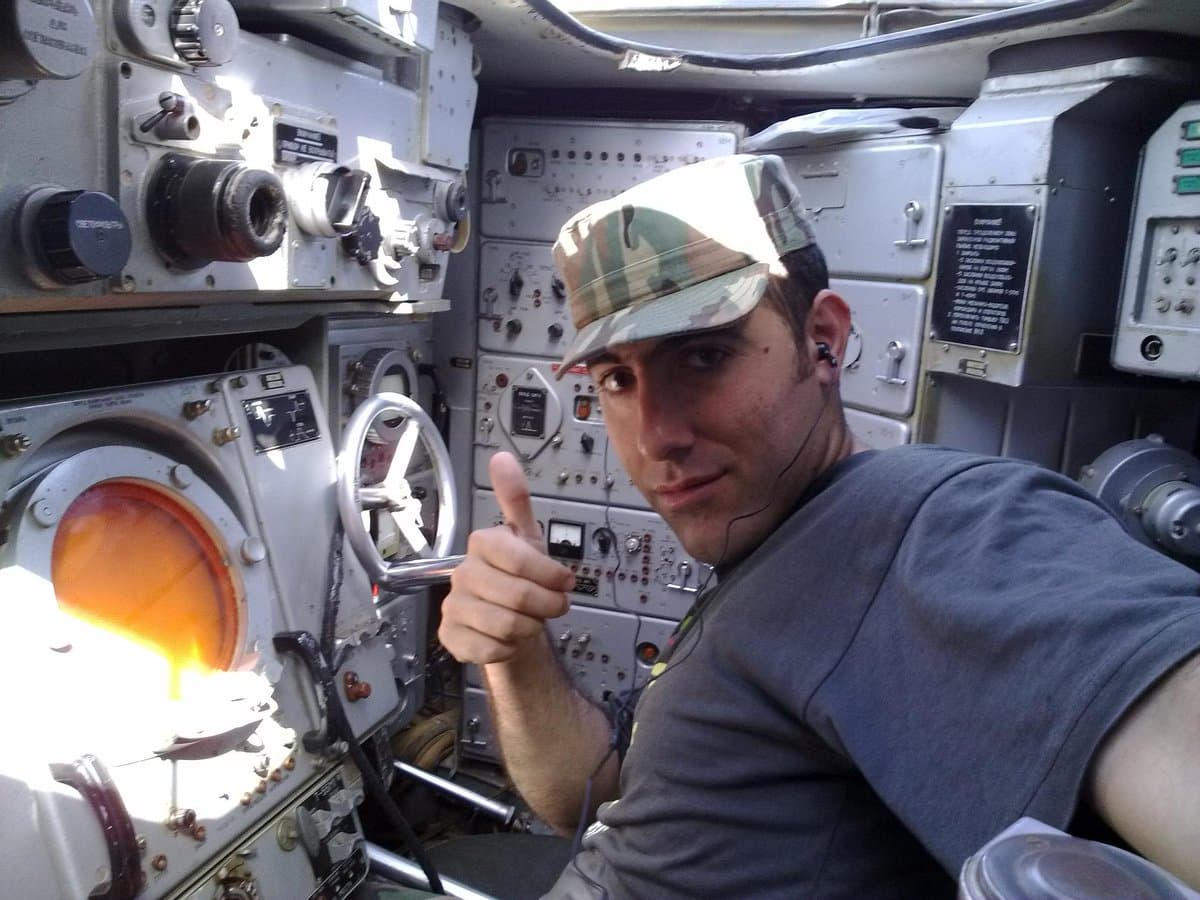

The actual crew area looks pretty small. It appears to be similar to a ZSU-23-4 where there are a bunch of screens and dials, etc. in front of the crew. The area around the hatches and on the side walls would have vision blocks, intercom boxes, lights, seat controls, radios, etc.
ZSU turret interior looking forward from operator’s seat/position. No idea who the goobers are, just lifted them from the web.
I bet a wall of instruments with a couple seats and other bits and bobs listed above would do it.

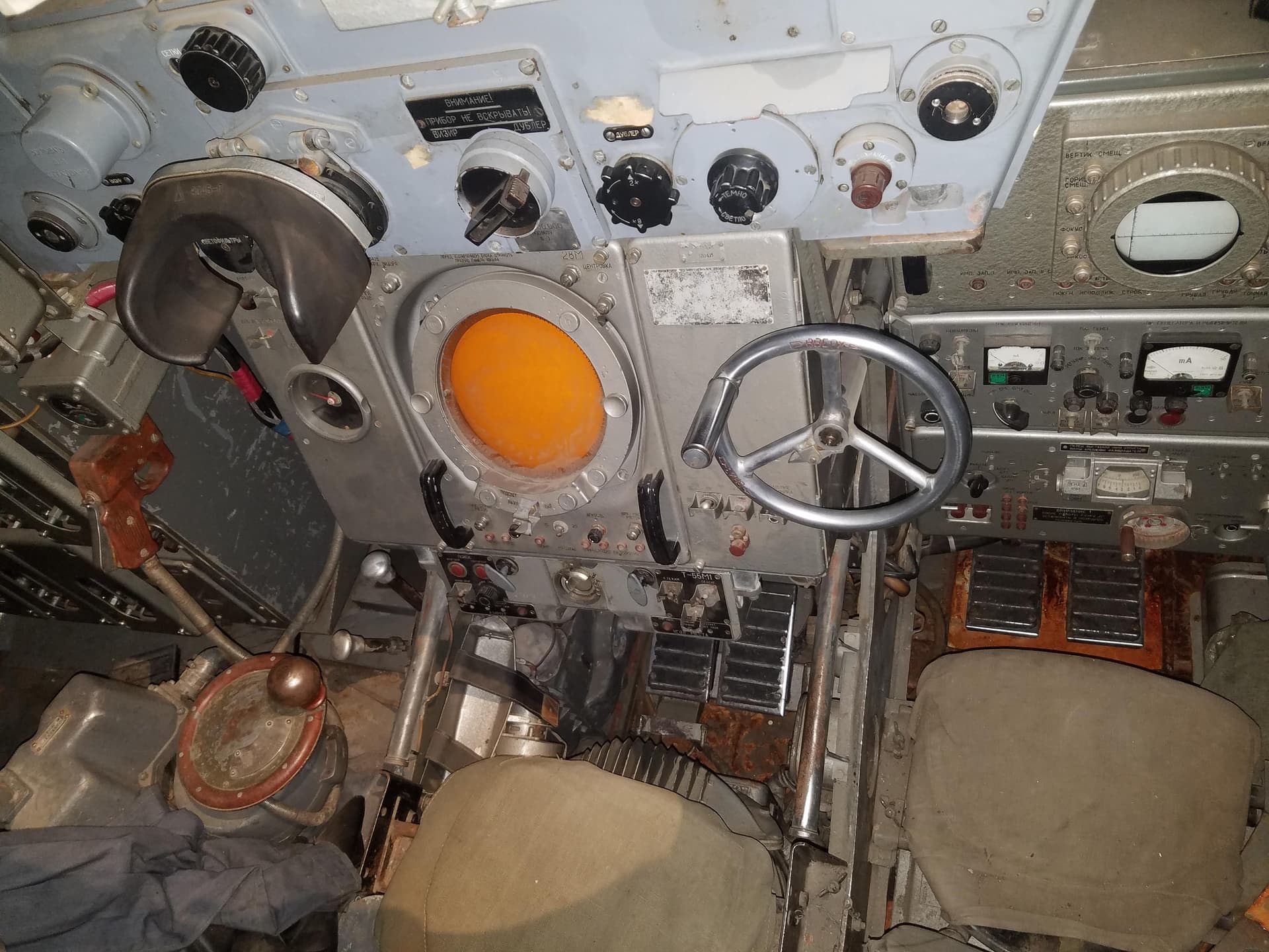

This may help

Wow! Thank you all. That’s extremely helpful.
The videos do seem to prove what Gino had said about the crew being separated from the main guns by a wall of screens etc.

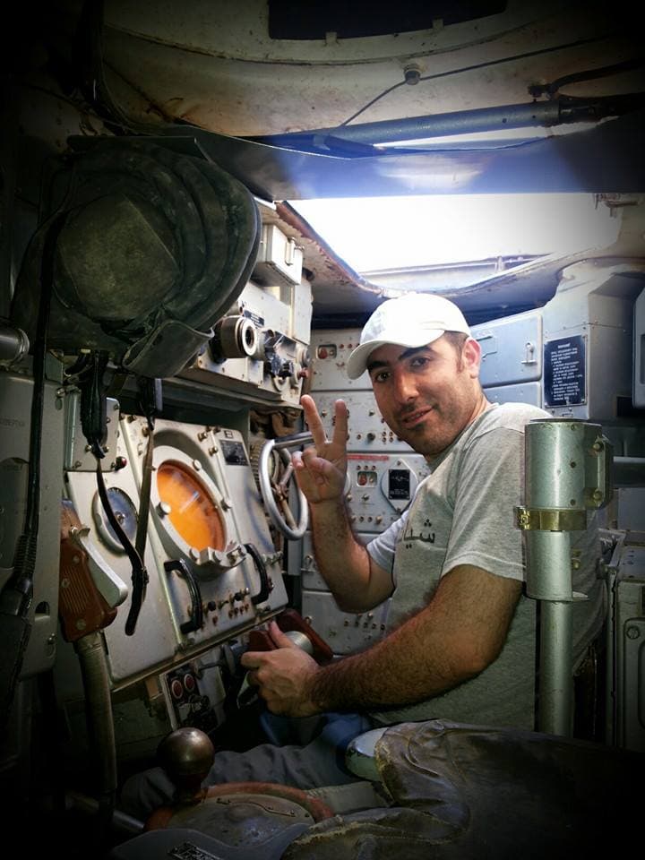

That is not an M247 SGT York. I posted pics of a Soviet ZSU-23-4 interior as a contemporary example since I couldn’t find any M247 interior pics.
My mistake. Thanks for letting me know. :smile:
