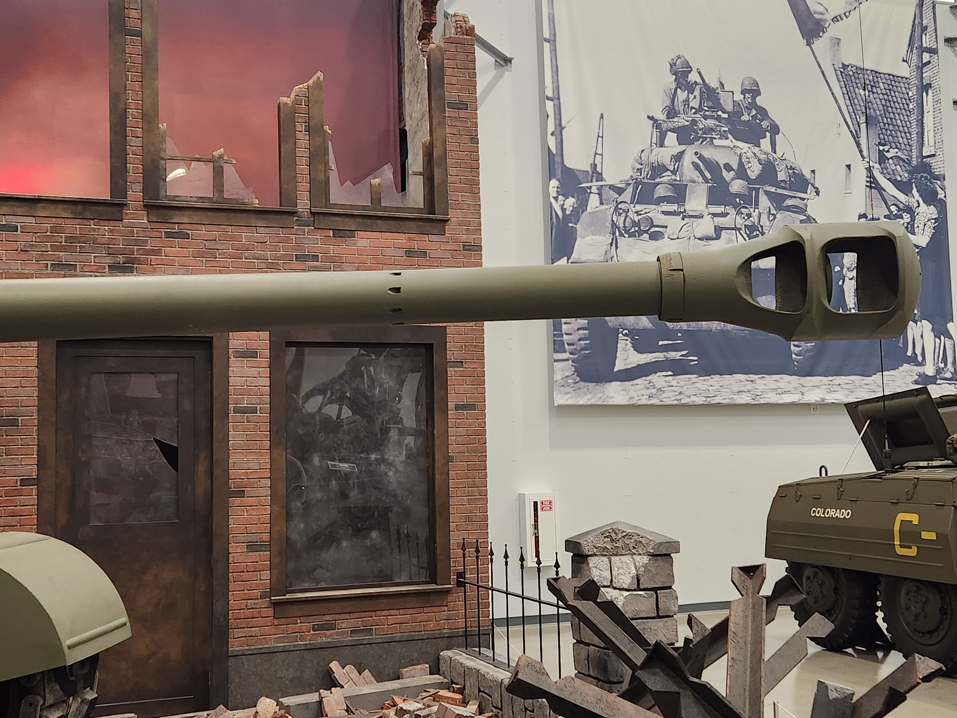

While at the museum, I noticed an oddity about the M26 they had on display.
There were vents in the barrel for use with a bore evacuator. However there was no attachment point for a bore evacuator. Thoughts?

The M26 did not have a bore evacuator, the upgrades/changes that came with the M26A1 was a better gun with bore evacuator.
I suspect the museum has used the barrel from an M26A1 on the M26 and gave it the double baffle muzzle brake from the M26,
or possibly they might be trying to “fix” a complete M26A1 to look like (VISMOD) an M26.

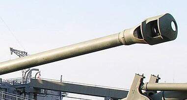

M26A1 gun, business end:
M26 gun, business end
