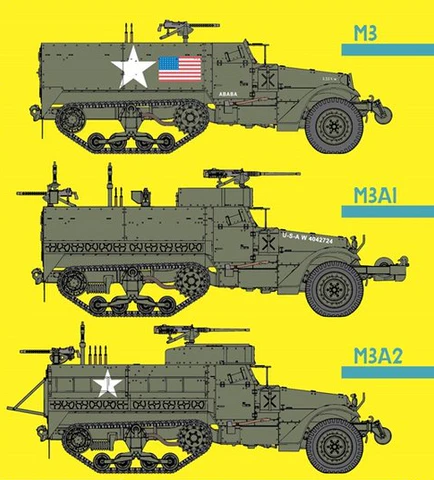

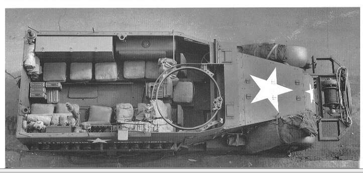

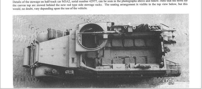

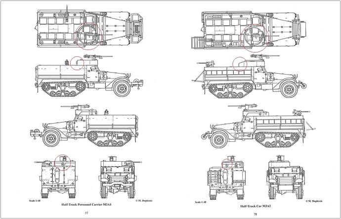

The Tamiya kit is a bit of a Mishmash of the two variants. From the Hunnicut book on Halftracks:
The A1 Pulpit did not have the rear armour extension part like the A2, and what is in the kit.
The Pulpit on the A2 had fillets between the outside of the rim to the armour, where the A1 was just open as per the kit.
The mounting points for the ring to armour were very different between the A1 and A2 and don’t exist in the kit.
The support strut at the rear of the pulpit was centrally located on the A1, but ragged left on the A2 , as it is in the kit.
The ring mechanism was raised above the the pulpit armour on the A2, where the A1 and Kit depict it flush at the top.

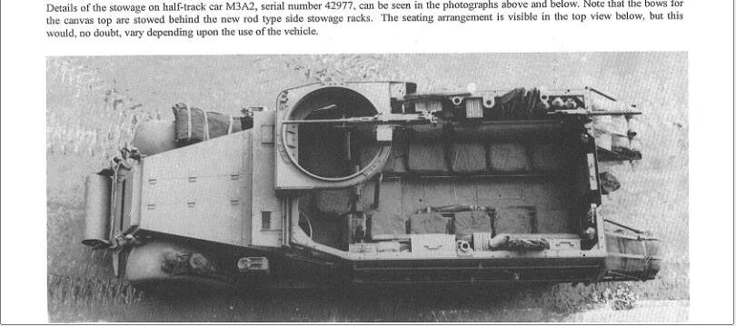

Massimo, as far as I know from what everyone has said or I’ve seen, the A1 DID NOT have the stowage racks on the rear door panel… Sorry if what said was confusing…
A very late model may of had the side ladder type racks as per Ken’s post I quoted…
And everything else Peter @petbat highlighted…

Now I see a bigger difficulty: the winch on the M3A1, the same of M21, is very different from the roller in front of the M3A2. This could be a major difficulty if I don’t want to cannibalize the M21. I’ll have to see if there are M21 with the same roller of the M3A2, this could solve the problem.

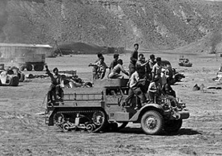

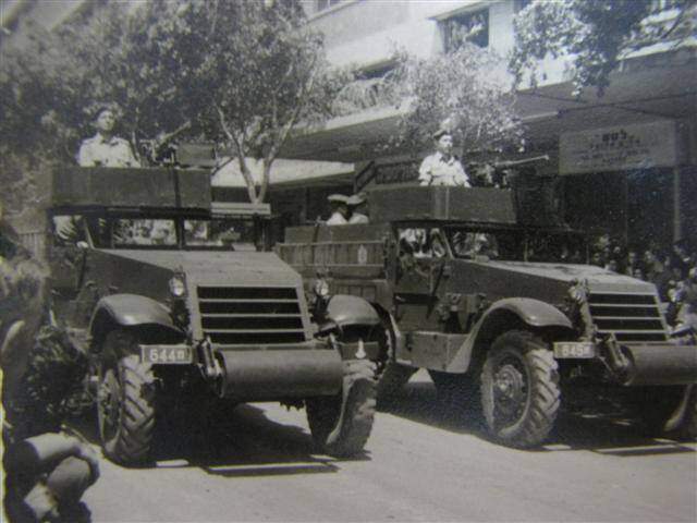

So what I have read on this thread about this Tamiya kit, you think you can get away with it by painting/marking it in use with the IDF with little to no mods ?
:beer: :nerd_face: :beer:
I did ask Israel about this on a different matter, and I think you could possibly get away with a very very early one with a few little tweaks … But the best answer with references would probably be from Israel @ReluctantRenegade or Nikos @gtdeath13 … I wouldn’t want to hand out any duff info…:+1:
Thanks. I just wanted to start here since there was already good info here on the accuracy of the Tamiya kit.
You can build it OOB as an infantry carrier.
