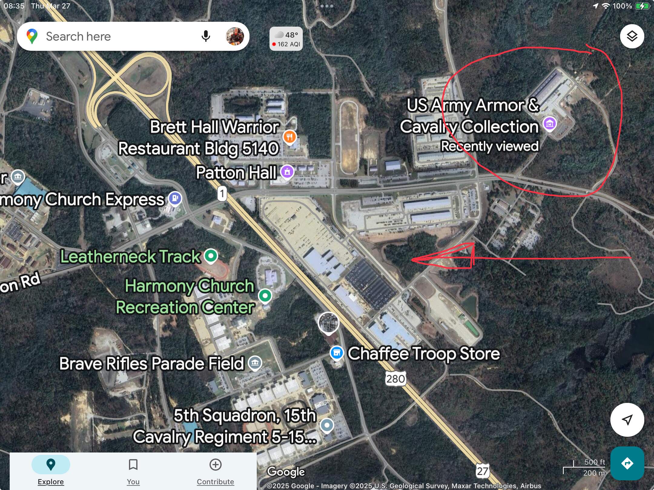

It is well developed, with a very large complex for TACOM and TARC motor pools (arrow) and the Collection out east about a click.

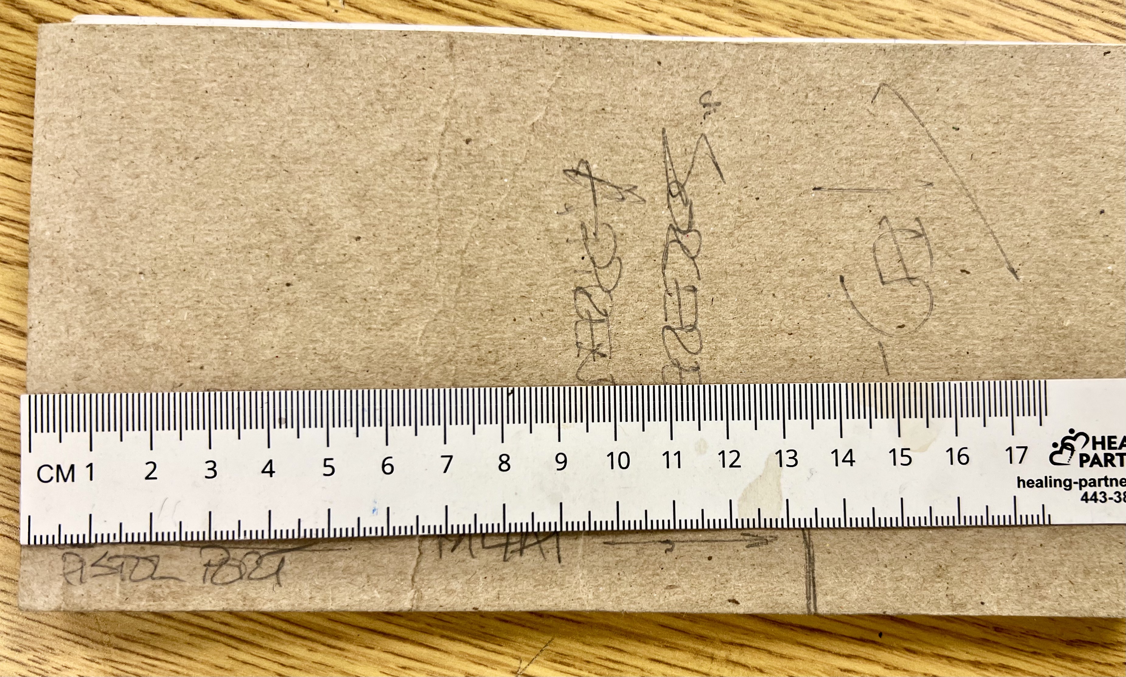

The pistol port has to be propped open by that lever you can see taken inside at the loader’s station. The handle and latch limit the width to less than 130mm (drawing with ruler). But the bigger problem (no pun intended) is the length (790mm) of the HE round.

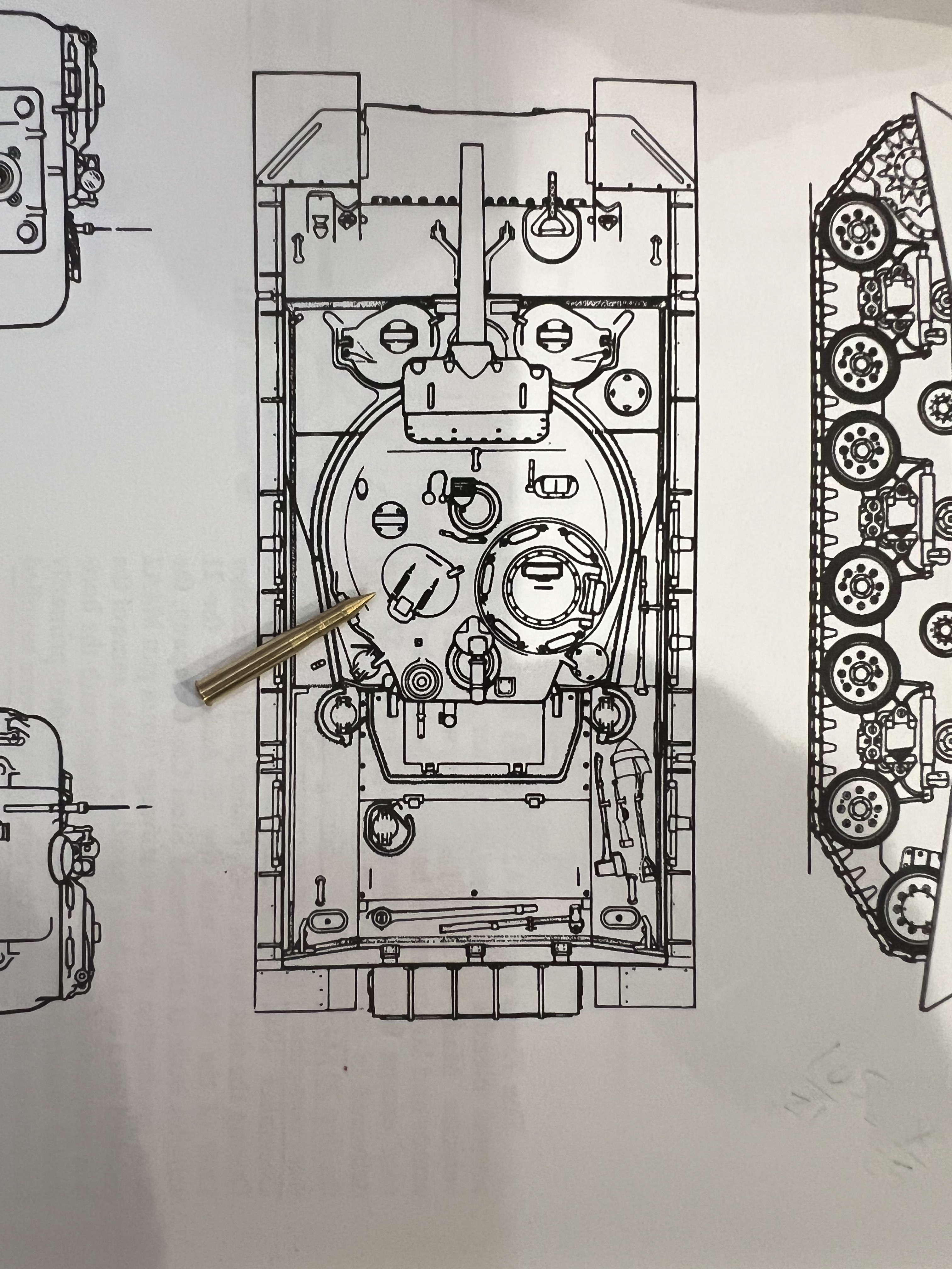

Note where the port is in the overhead turret view. Getting the volume of 790mm x 119mm into the turret was difficult (I’d never say impossible) because of the proximity of the breech to the turret ring, even with the gun elevated. We didn’t have an M1 HE mockup, but two experts (Rob C, curator, and David Hobbs, SME on all things Sherman) joined me.
They both assert that getting the rather thick 105mm through the hatch would be complicated. We used a yardstick for reference, and inserted it into the port while observing the swept area. We’d insert it and then sweep it to get an idea of the volume required.
  • The first obstacle was the gun breech, even though we were in an M4A1(76)w. While the combination mounts were common, the breech ring is different, larger, and extends towards the port about 125mm. So the space for handling the round is further limited.
  • We did later try a blank 105mm (saluting) cartridge. I could wiggle it through, but looking at the space, the complete round would not.
This is all “unscientific”, but it clearly supports Richard’s build and various reference documents that showed ammunition on the back deck. Well done sir!

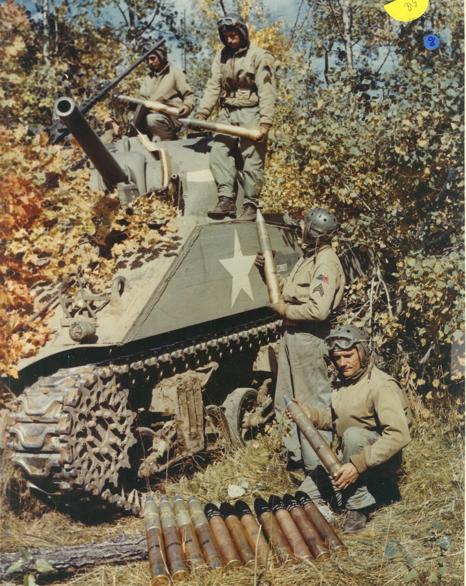

This was likely the usual way that Shermans were loaded, perhaps with a little less posing and only three of the crew:

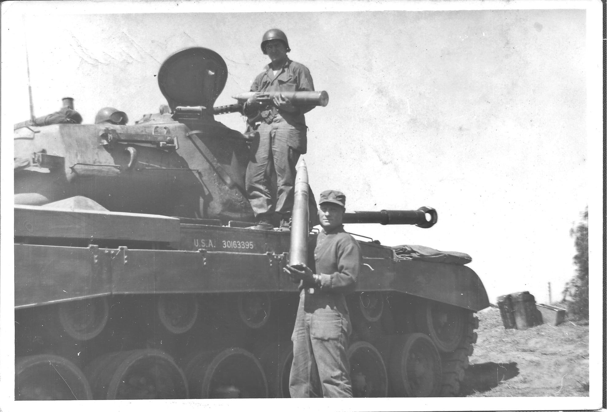

Still the same 10 years later:
