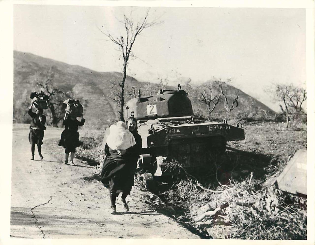

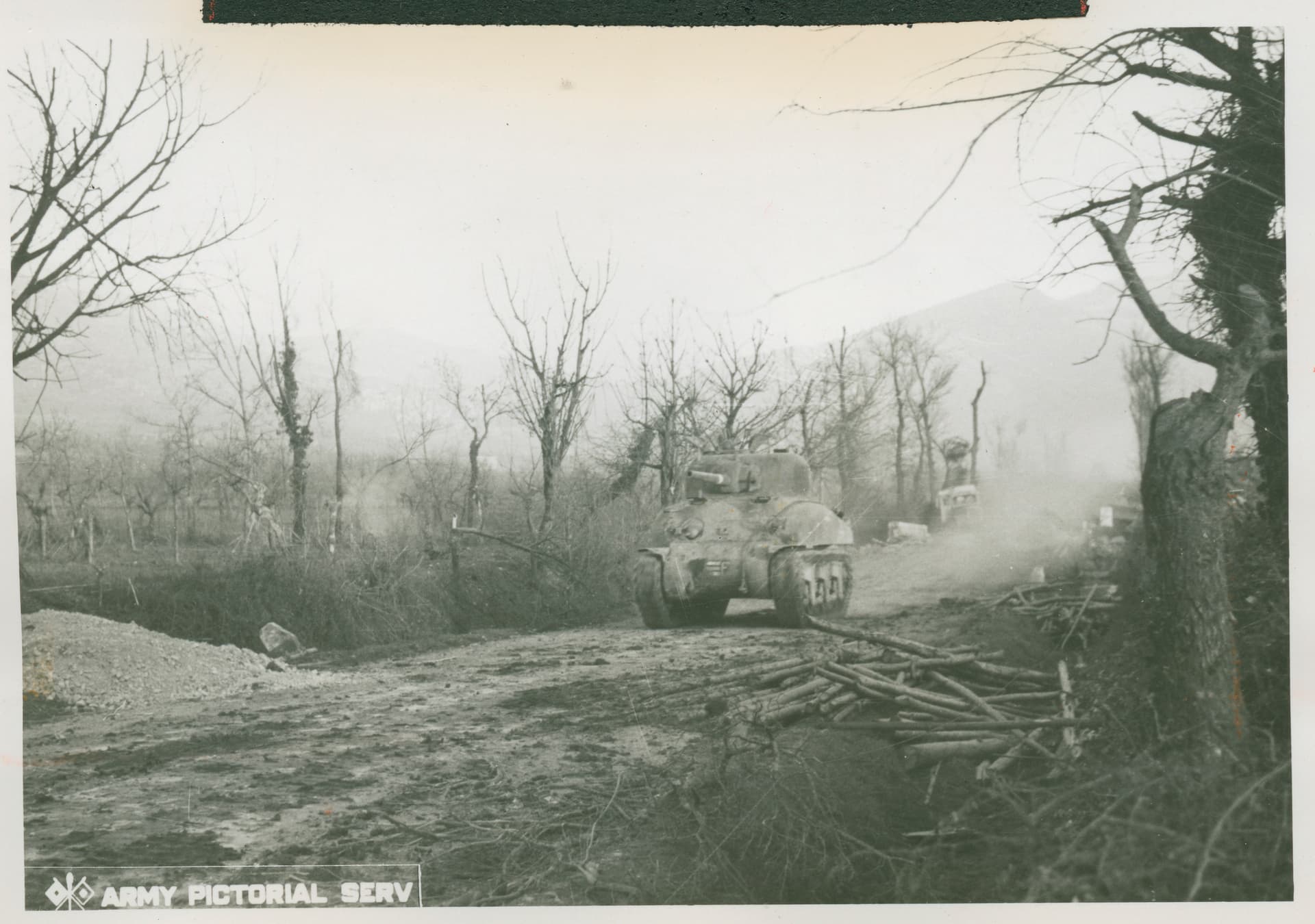

That is Gold for me! I’ve seen so many of the same pix I can go “ah, that old one again,” and of course bad cropping in many - not that it’s not good cropping, but a tad more left/right and it would show the detail I want! But now, new and relevant pix! Much appreciated.

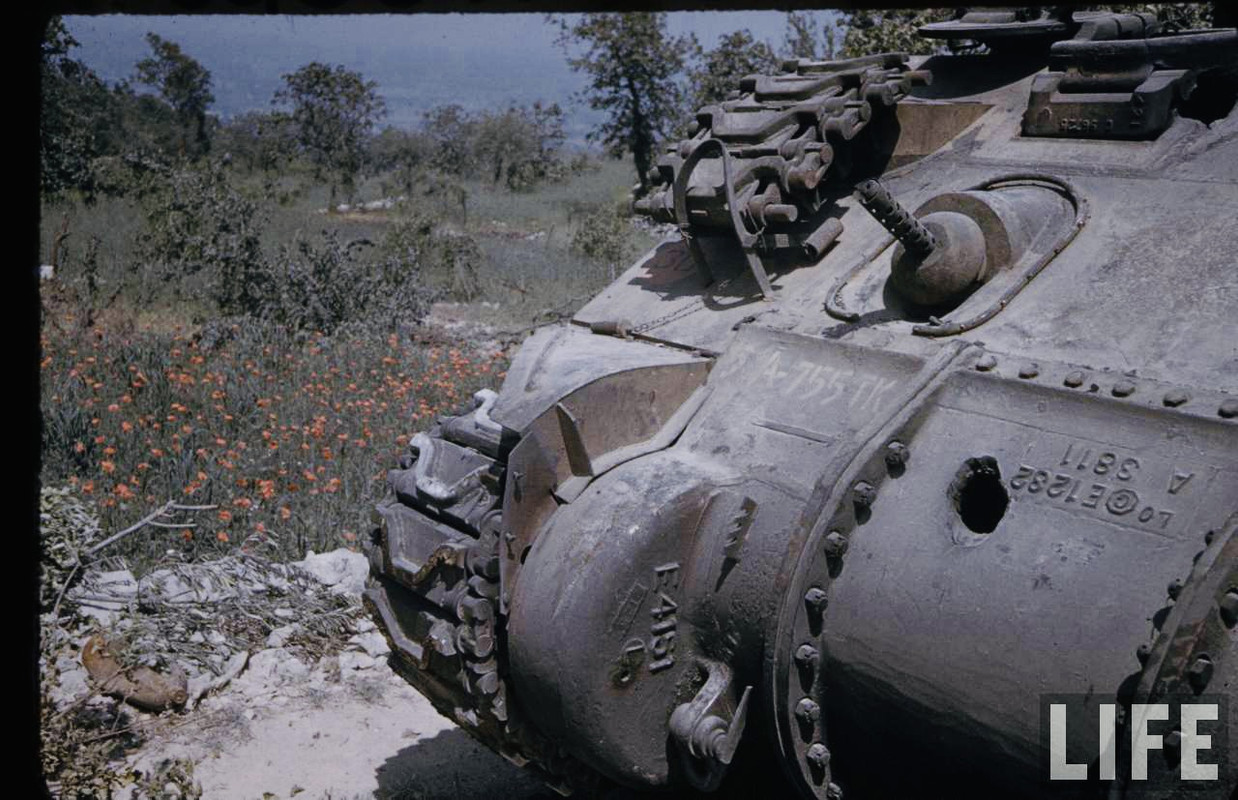

I also get tow cable detail in the first pic. I made one today, a practice really, I just stripped the insulation from some small gauge (large by number) wire and twisted and voila! I need the end bits though. Now I can see that they were a squared ring welded to a tube, unlike the wrapped around an eye style of the German tanks. I might make some in Blender and 3D print them, but wrapping a cylinder into the link will be - uh, interesting for me (I make brain damaged, trained monkeys looked skilled in 3D).
I’ve seen a lot of code as solid, but this shot of 755 is stencil. I will work that in. Nice to see the color. Too bad (for the crew) about the big hole in the transmission, but better that than the turret!
