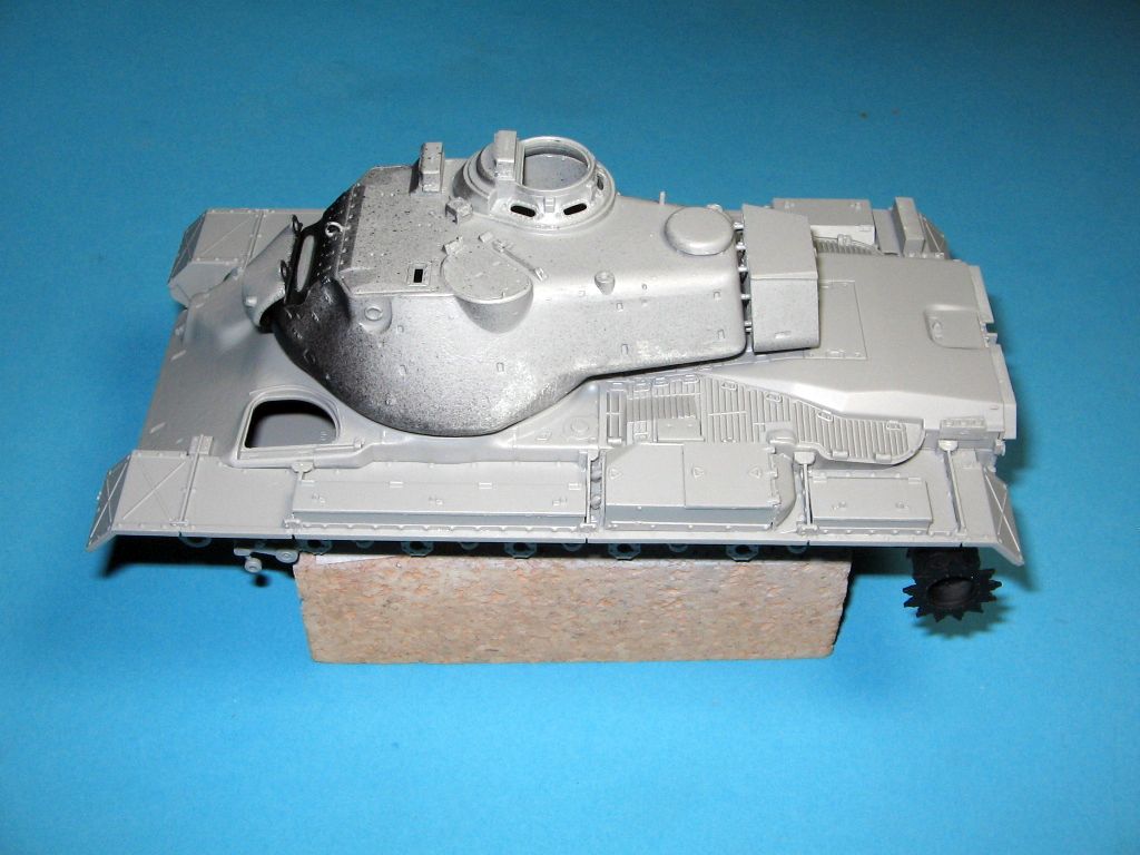

First pics:

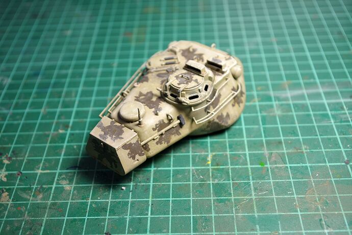

Turret, base colour, some ERA bricks for the “improvements”.

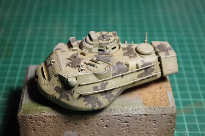

Body color is Olive drab shine as recommended by the instructions.
The blotches are brushpainted using a dark brown. Brushpainting allows for a slightly worn look right from the beginning. Not to mention that the Iranian soldiers did a sloppy paintjob too.
You may see the line of ERA blocks along the side boxes. These are the only ERA boxes at the whole tank… I don’t know what this “improvement” is good for, but they did it - and so I did it too.

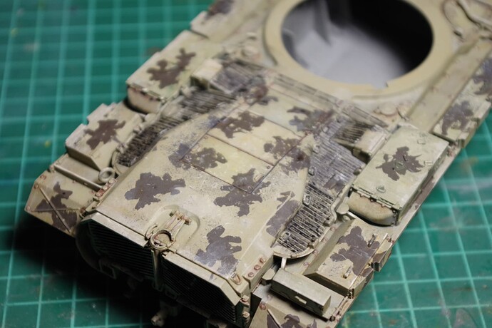

After applying a number of filters in various areas I did chipping with spoges, painting flat and deep scratches as well as a lot of detail painting, highlighting of the edges and more of this kind of micropainting.

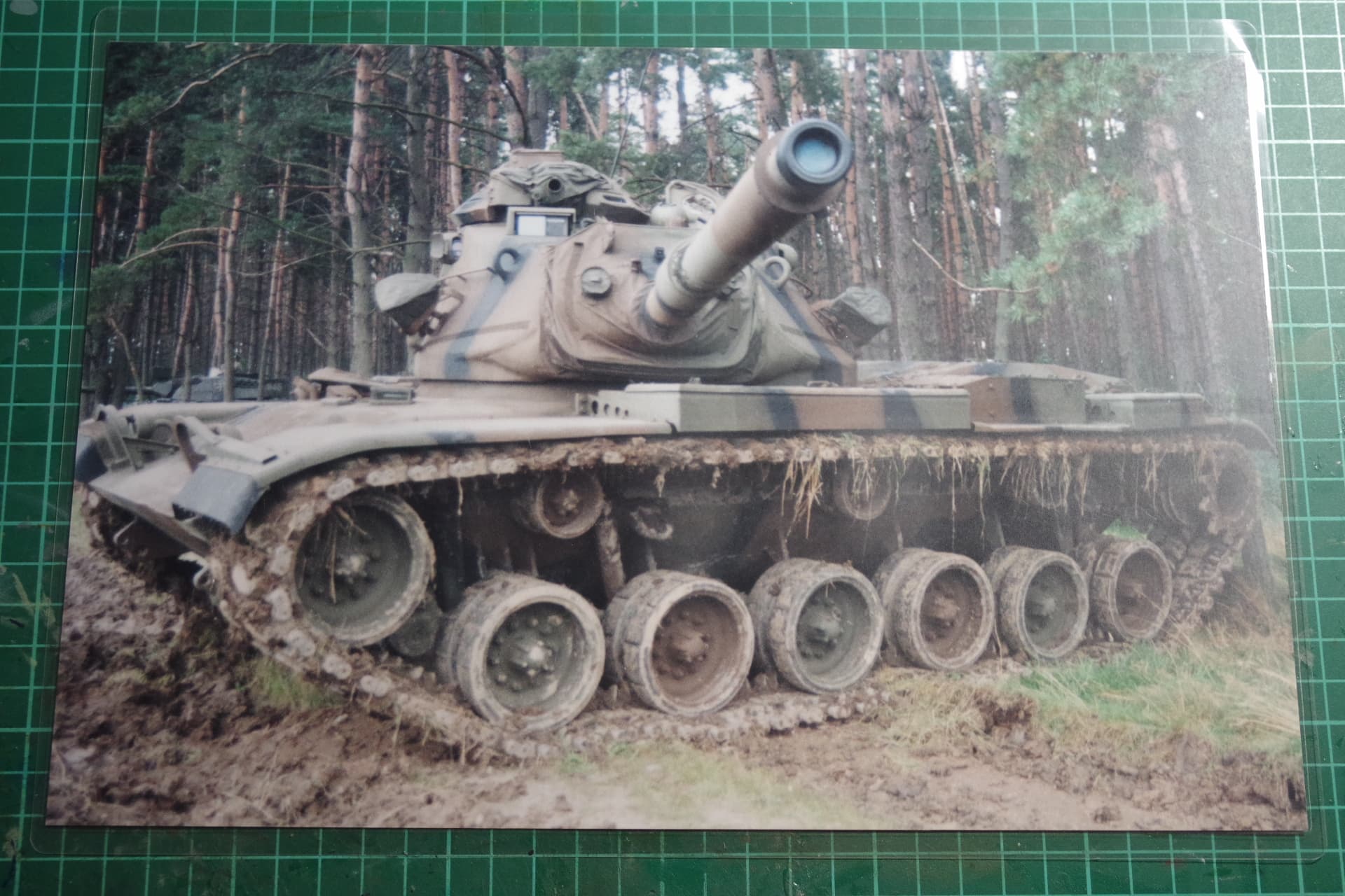

You are quite right. And it’s not an Iranian tank, but it features the same type of undercarriage. Thats the to me important thing here. It is a good help to get the idea where to apply dirt and dust and how much of it.
If you watch closely you will see tat the removable engine paneels feature a different hue than the overall engine deck. This is what you achieve using filters: same base color, but a different look of different areas. I’ve also added much less chipping and scratches there - this part of the tank is mostly hidden under the turret bustle so less exposed to wear and tear by soldiers boots or stowage loads. During engine maintenance they are also kept off - so the major paint defects are concentrated on the fixed parts of the deck.
Visible is also the browish pin wash around the boltheads, f. e. at the rear mudguards, as well as the higlighting of all hard edges. Each color by a correspondenting lighter color, i.e. an off white and a yellowish light brown. You can achieve this by simple drybrushing. I did so too in the past but nowadays I prefer real painting with a small brush for more controlled results.
The turret shows some faiding with oil paints. Applied this to the hull too. Just as written in the how-to books: Add dots of a very small quantity of oil paint here and there (just the sheer tip of a wooden toothpick is enough per dot), then gently brush it downwards with a wide soft brush soaked in a proper thinner for oil paints. Turpentine (odorless is highly recommended here), white spirit, enamel thinner, each of this will do it. Doing this on horizontal surfaces is much more tricky (I still have no shake-and-bake technique here - just patience).
You may see the empty spot at the stowage bin where a fuel can holder is missing. I am still lacking a set of painted fuel canisters while writing these lines
All the same has been applied at the lower hull. No overall chipping and scratching here - this will be hidden by the running gear, tracks and a cover of dust. Added some streaking with washes and filters.
Yes, the running gear introduced on the T26 Pershings was the standard US medium tank/MBT suspension, with slight variations of return rollers and tensioning idlers until the final M60A3.

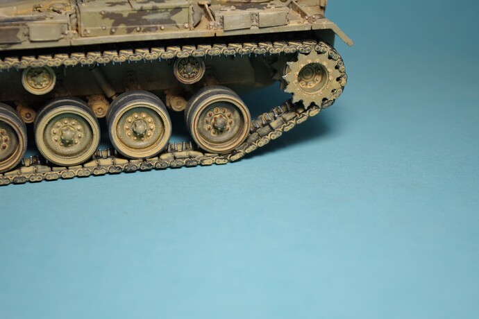

Err, yes. Not what I’ve intended. To much pigments plus pigment fixer and we’ve got watermarks.
We make no mistakes, we have happy accidents, following Bob Ross. So: Wow, interesting effect! Made a note for later modlling projects. Was a great idea to try it first at a less visible area. And then I#ve added more pigments, but not too much at a time.
Brushed a bit off here and there, added a bit more and or another kind of pigment in places just to catch the look of a tank in a mostly dry and dusty environment. At least how it looks in my imagination. Never been in Iran personally, but a fellow modeller was and told me about his overall impressions of that place country.
Many of the battles in the Iran Iraq War were fought in the swampy Shatt Al Arab border areas. So mud on the tank hull and suspension is not out of place at all.
Yours looks really good so far! You sure nailed the look that they can get in field usage.
You are quite right, there are a lot of marshy areas in Iran, especially along the seacoast and the the large rivers. Our fellow here is from the other side of Iran, the Razavi Khorazan province, whis bordering to Turkmenistan and Afghanistan. Mashhad has an elevation of 1.000 meters above sea level and a cold semi-arid climate. There is a bit of rain and even occasionally snow in winter. So I keep my M47 more on the dusty and dity side with some occasionally aqquired mud and not so much on the muddy side like the tanks in the southern Iranian provinces or the M60 in the woods above. At least I try to achieve this look.

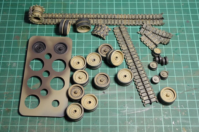

Takom provides a pair of templates (right and left side) to build up the whole trackrun. Great idea, indeed! But the instructions do NOT mention that it is expected to space the links away as far as possible. I’ve glued them to a tight fit and - Bummer! - the left track was too short. Just 3-5 millimeters, but a gap is a gap…
What to do now?
Man the boats?
Ask the Old Guard to marsh straight into Wellingtons center to shatter the British lines?
Sell the firstborn to the devil?
Decisions, decisions…
We ask a mad scientist to forge a Frankenstein link!
Well, it’s not the best track ever but at least a complete track. That’s it so far. Now I have to build and paint the jerrycan racks for the turret an the AA MG. It’s not a M2 - the Iranians use here a Dshka. Time to dig for Miniarts Soviet MGs set.
