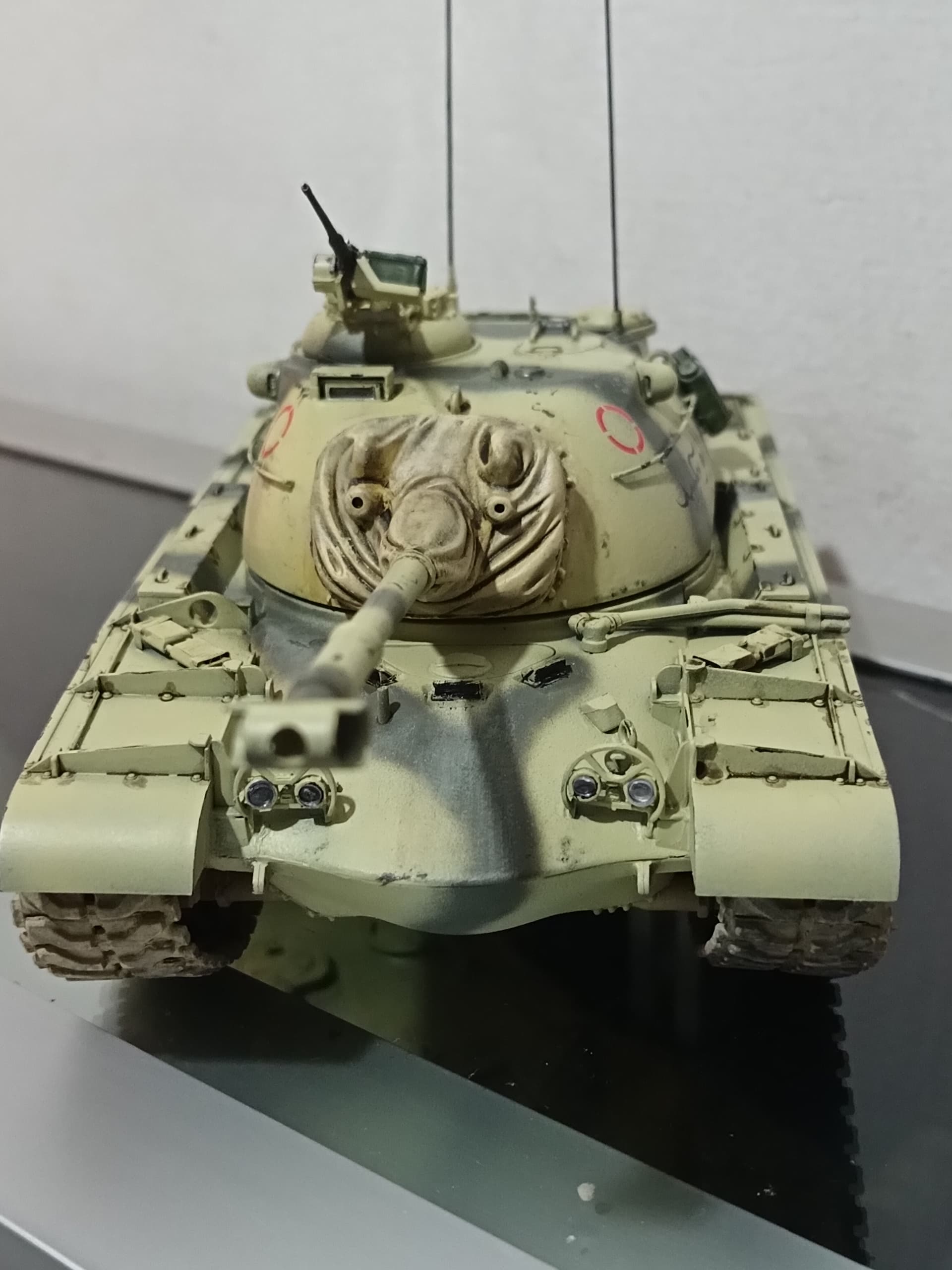

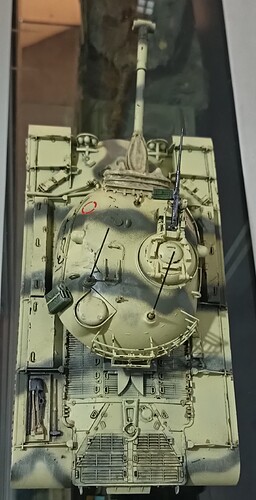

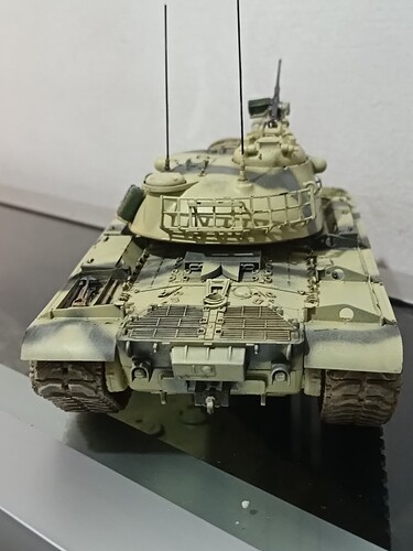

A good friend of mine has built this kit :

For a Jordanian one you need a small driver’s hatch and to backdate some features:
You can also use a Chrysler cupola instead of the kit supplied one

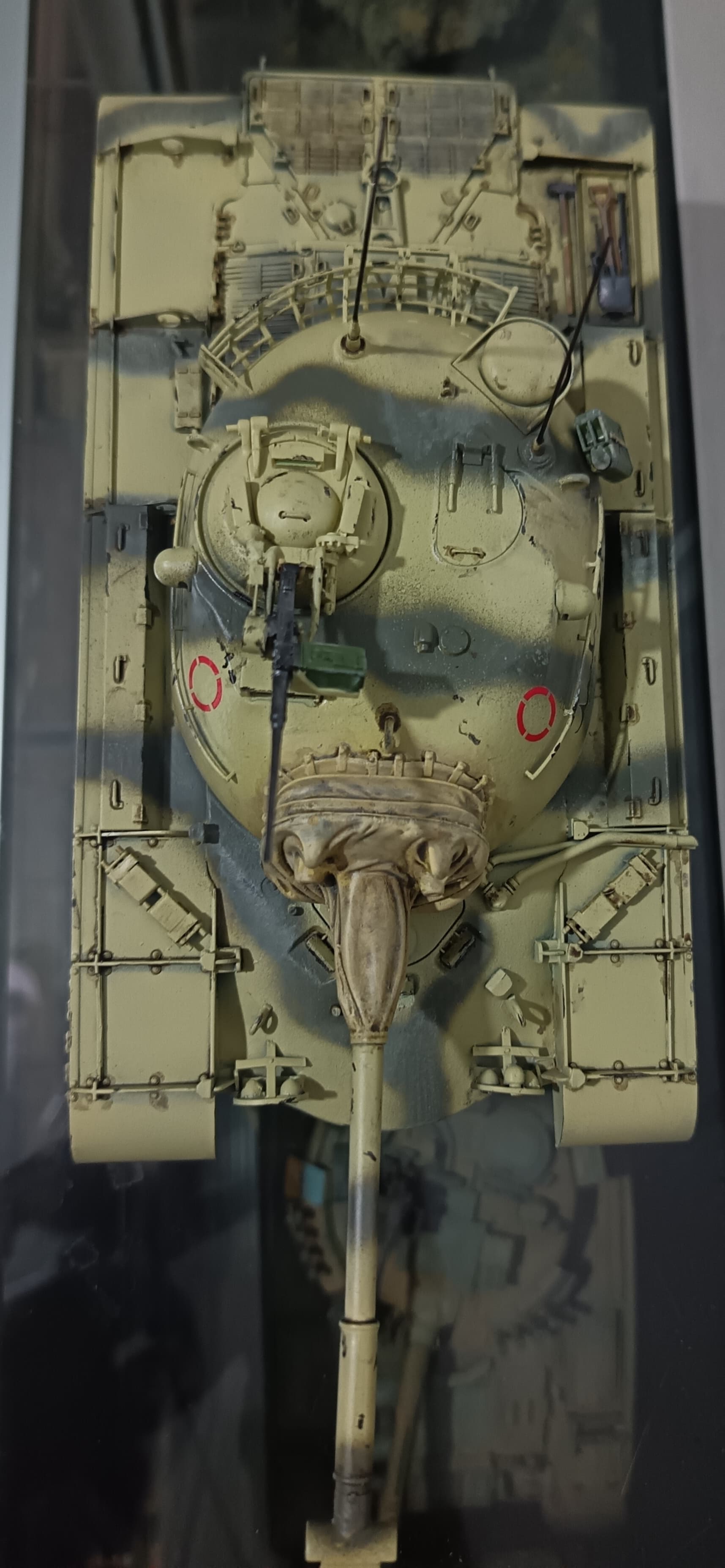

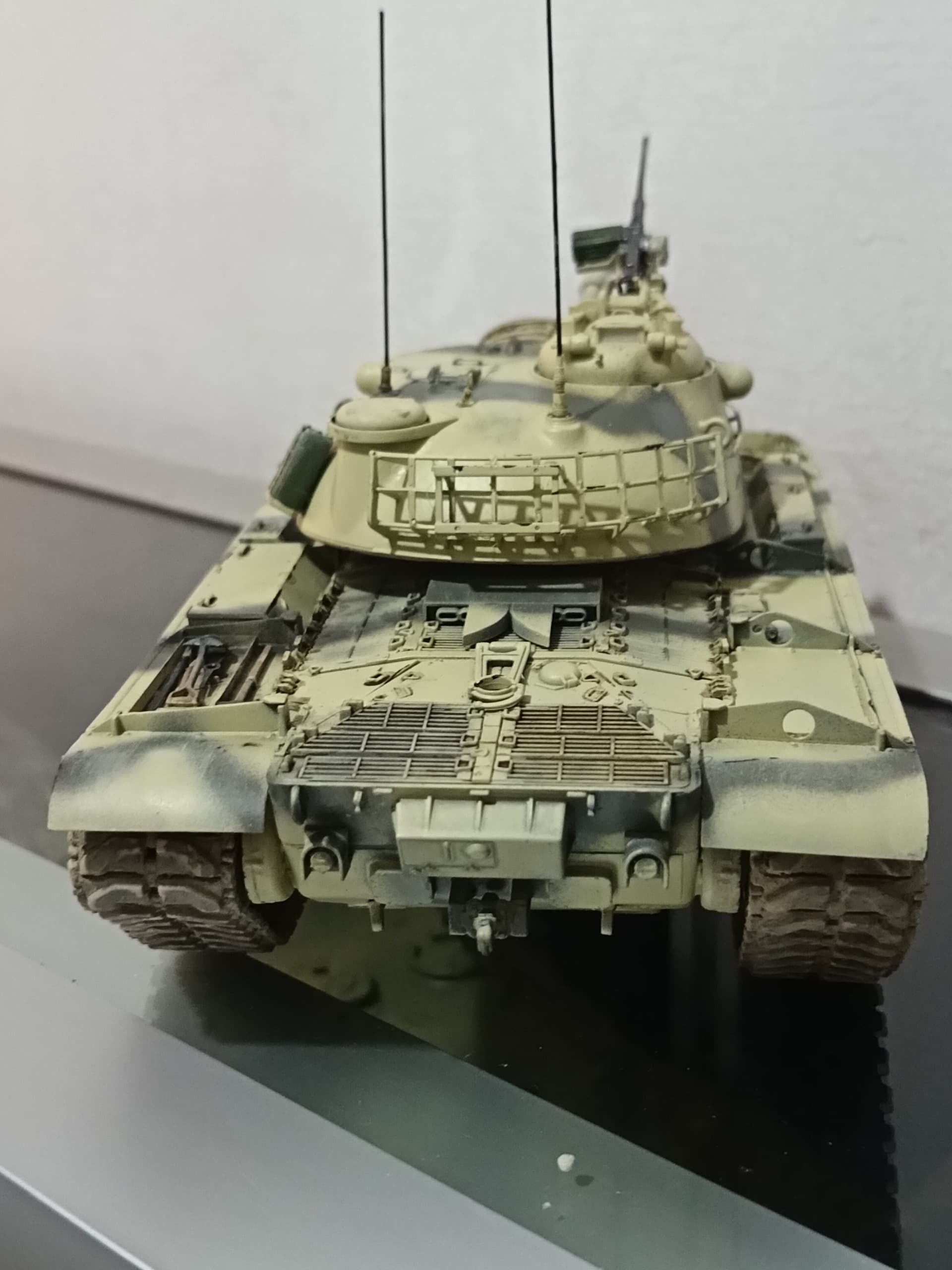

I built this one
I would not go for an olive drab A2, especially with the markings indicated by the paint guide. It is possible though but not with this style of markings
Looks good, the sand color could be a bit more yellowish.
:+1: I thought the same

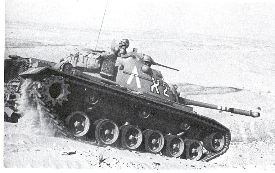

Here is a good synopsis of the M48 in IDF service
IDF M48
Wooow, thanks for sharing, @Stikpusher :slight_smile:
You’re quite welcome Rafael
