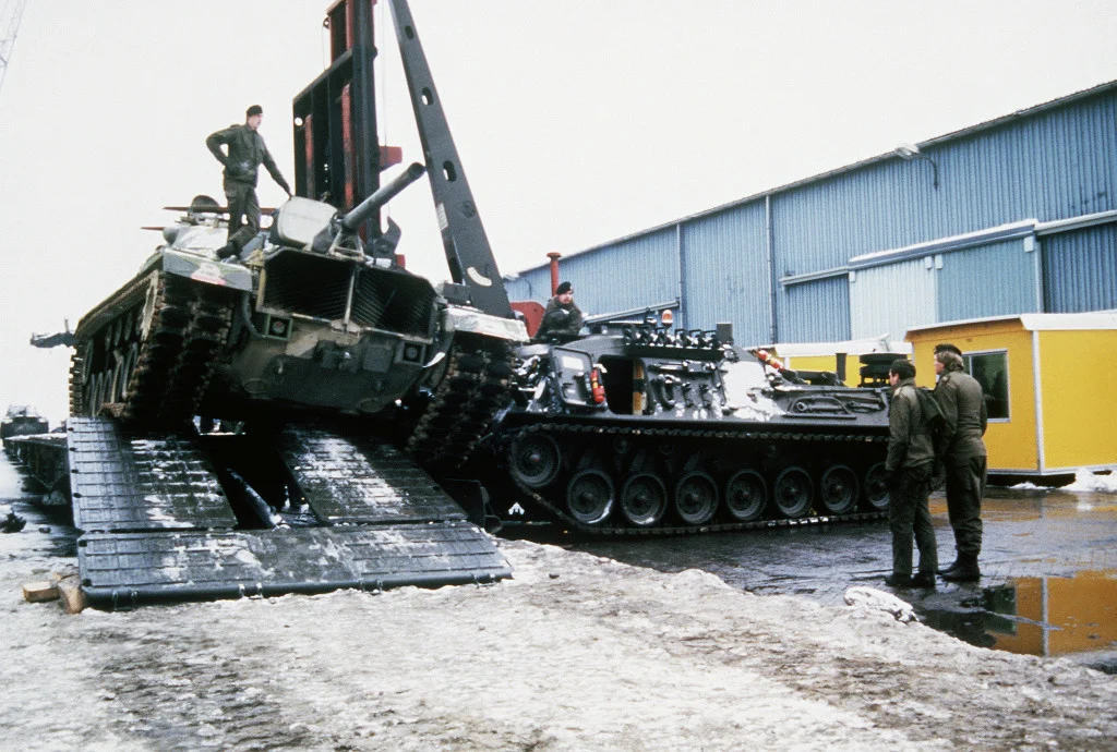

A US National Guard Unit with M48A5 was deployed to Germany REFORGER 85 Central Guardian during January 1985, MERDC summer verdant with white winter application. TANKOGRAD 3039 shows some photos.

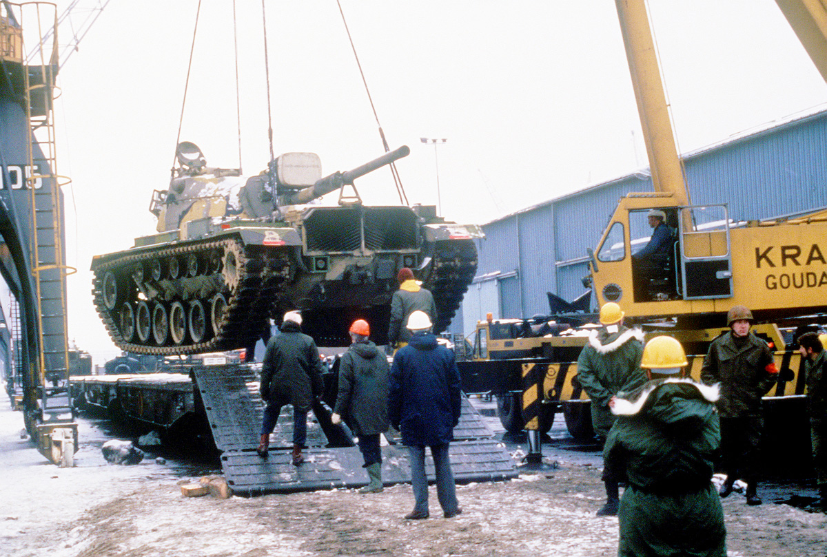

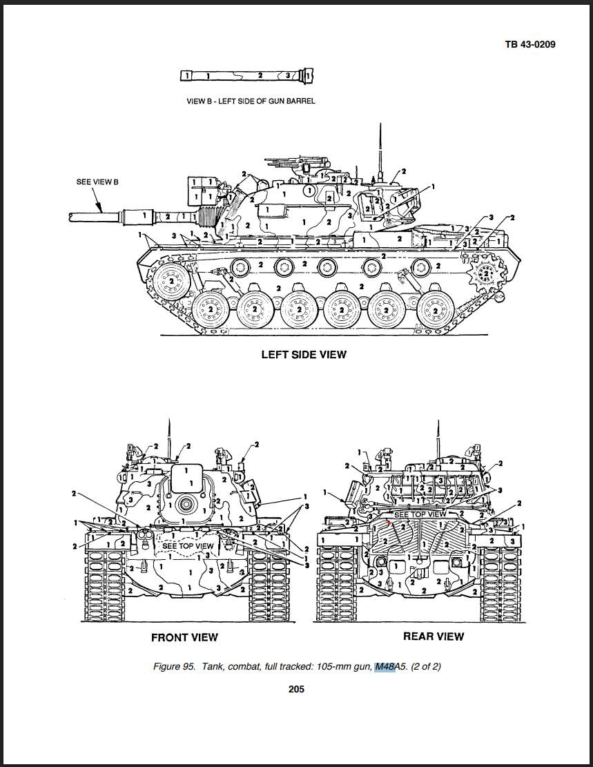

Here’s one in the port of Amsterdam:
Technical Bulletin TB 43-0209
The first one I pulled up shows the three color scheme. But the four color scheme is out there - I sold one to someone on here a few years ago. You can expect this kind of quality:

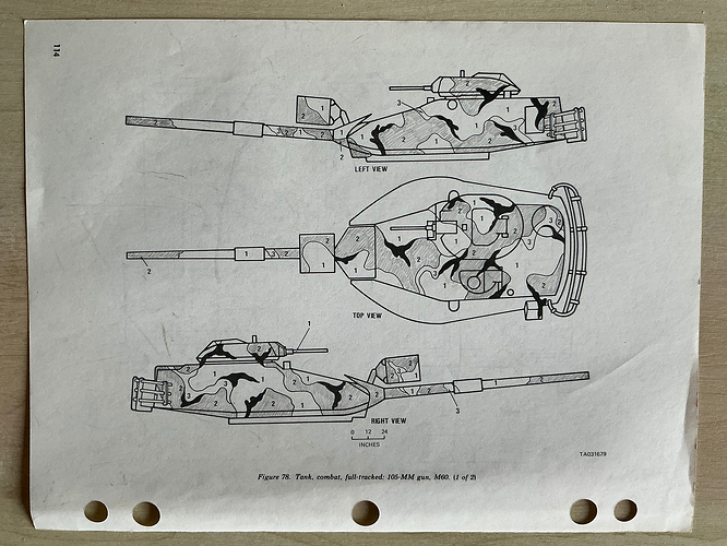

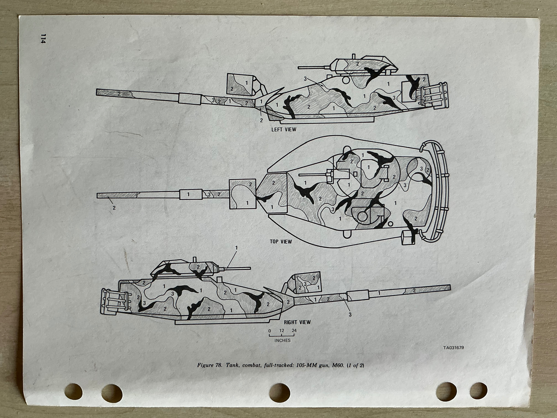

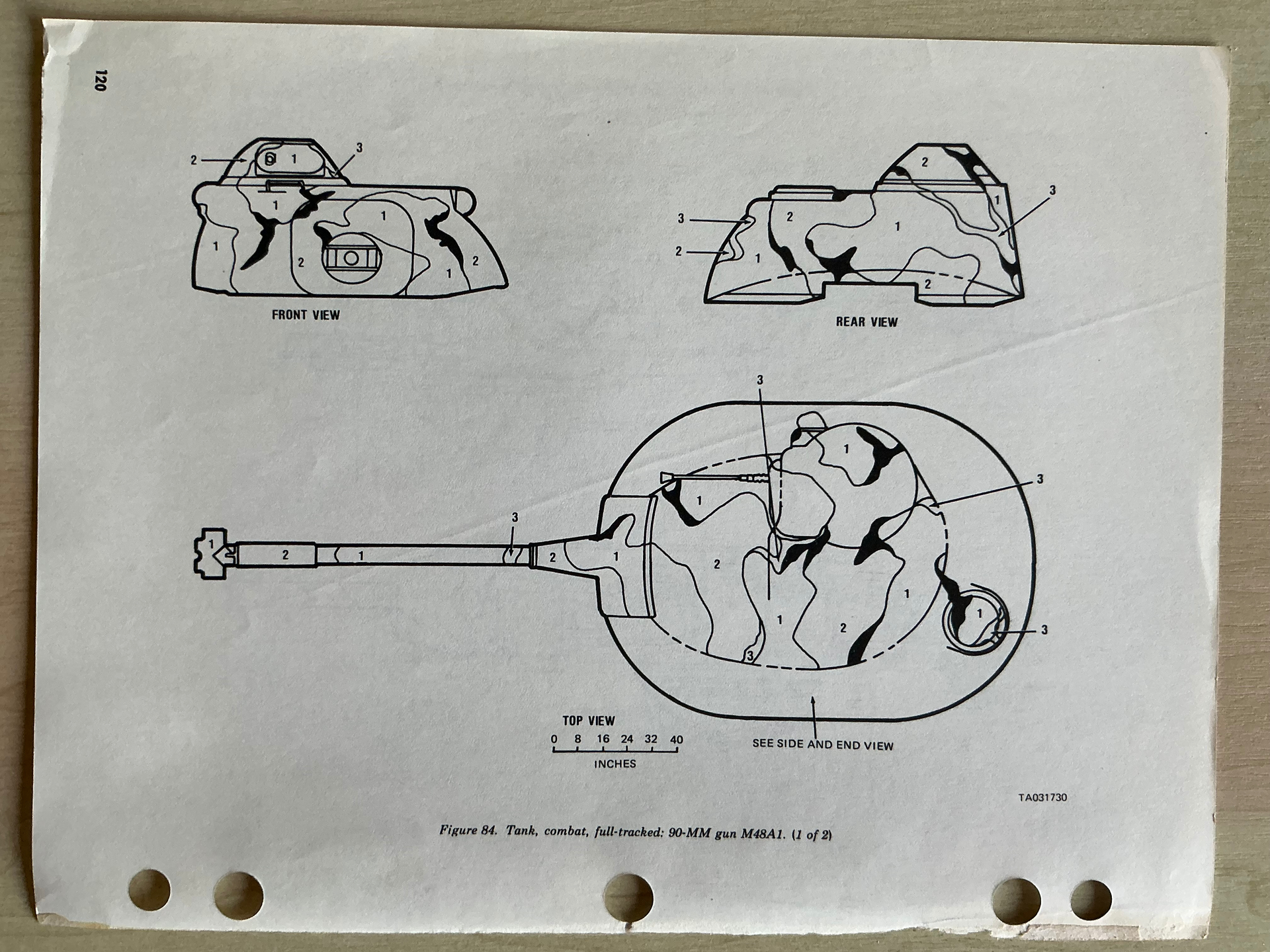

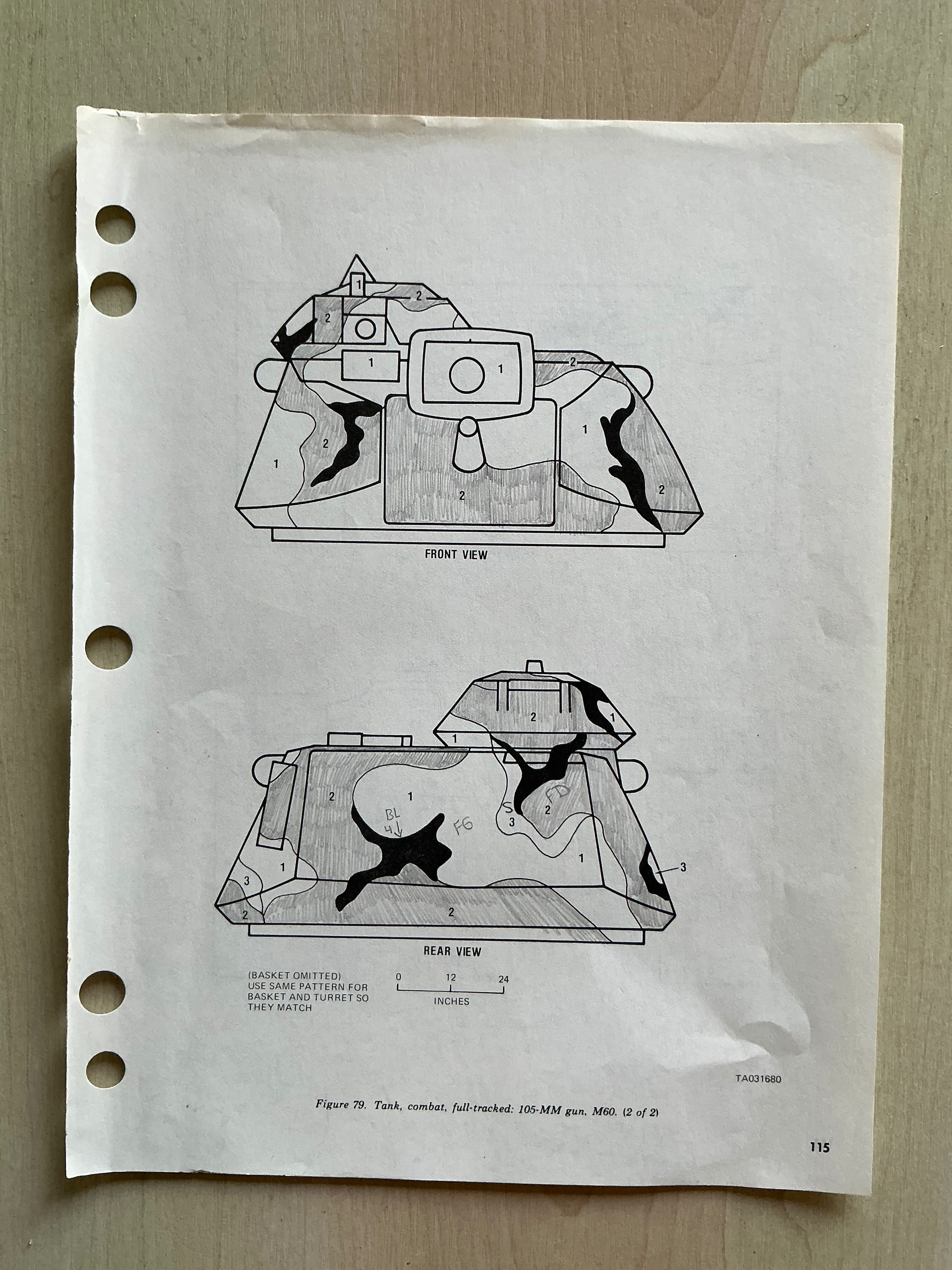

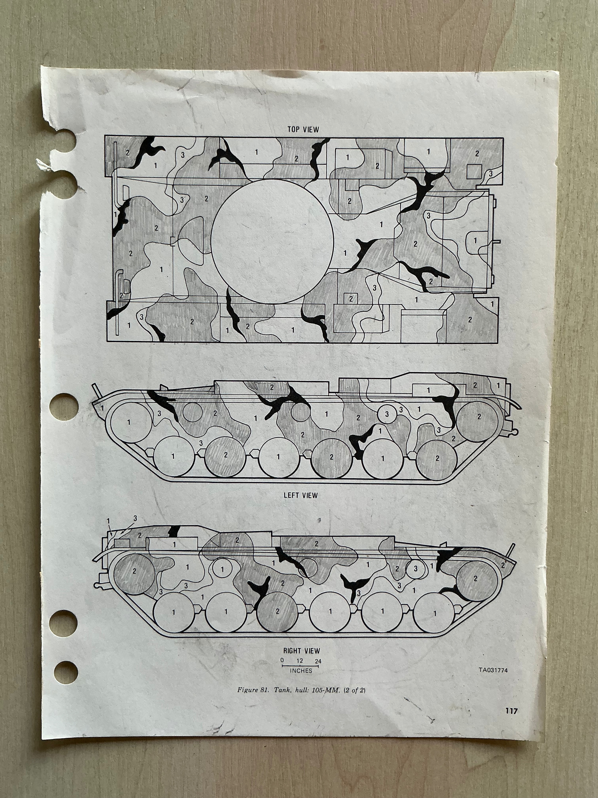

Oh, cool! Somebody still links to a site I put up almost 25 years ago :slight_smile: (But one that will be gone in a week’s time, as my ISP will stop providing home pages after THIRTY YEARS :frowning: — which reminds me that I need to move it elsewhere sooner rather than later …)

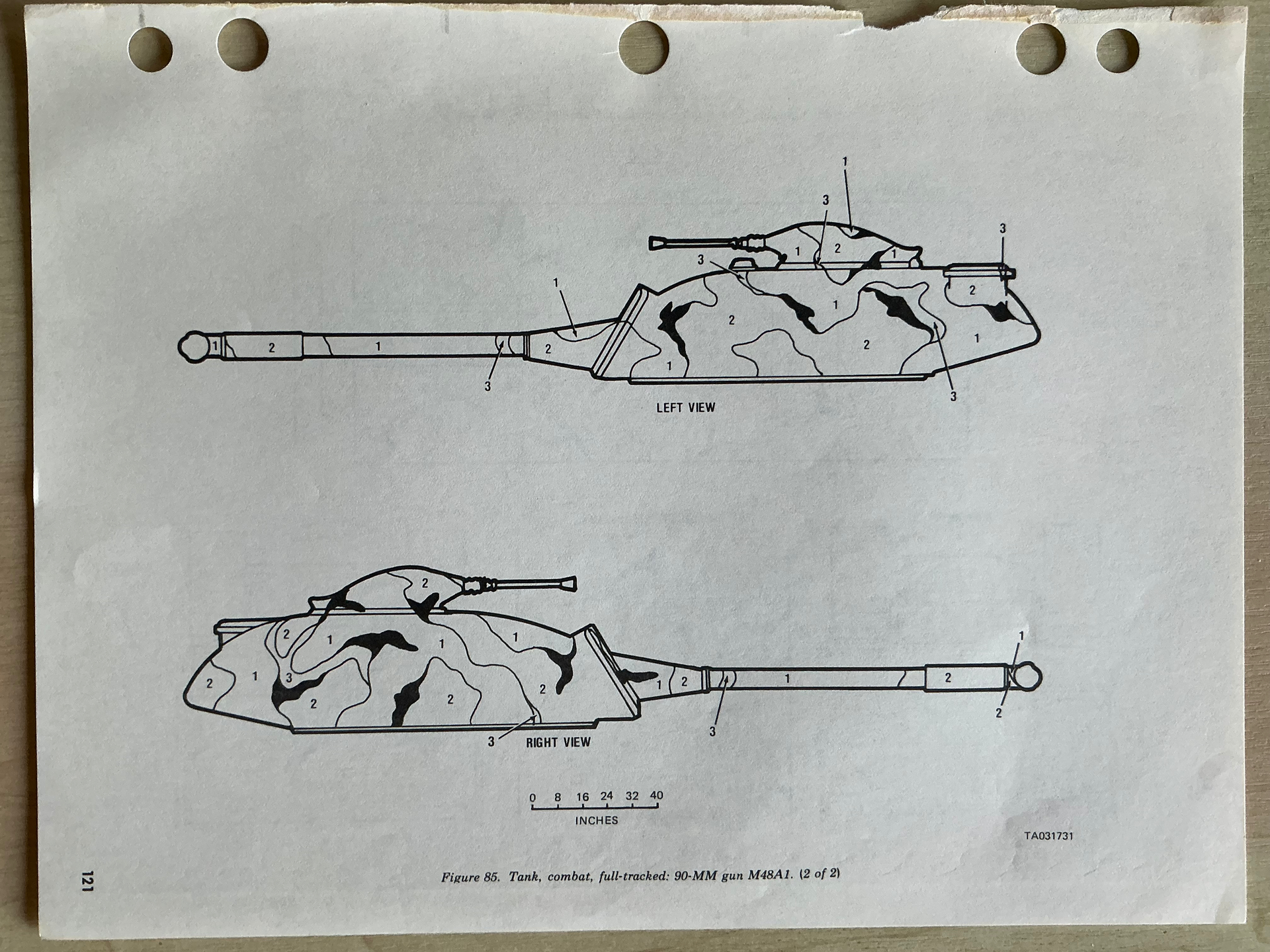

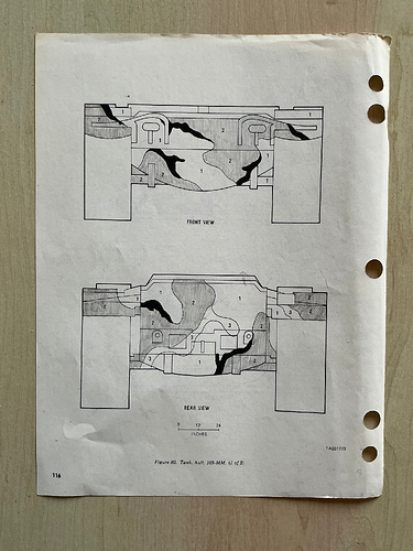

Will this do?
It doesn’t have the M48A5, but it does have the M60A1 hull and turret plus the M48A1/A2 turret, so I suppose you can piece together an acceptable M48A5 pattern from that. (A previous owner filled in one colour on the M60 pattern with a pencil, that wasn’t me :slight_smile:)
Does it list what state it was from?

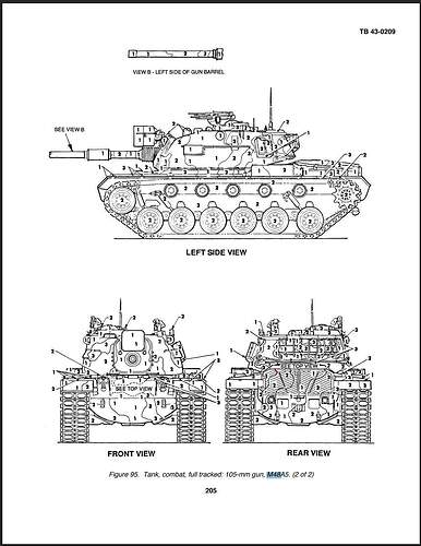

TB 43-0209 also has a chapter on markings, but it’s generic so you’d have to work out yourself what exactly would be on a tank from any given unit. I can photograph it too, if you want.

Likely because the program didn’t start until October 1975, so by the time that pub came out not many had yet ben converted,
But you can see the in the photo I poste above, it does show the A5, albeit with three tone camo. As I said, there exists one with the four color scheme.

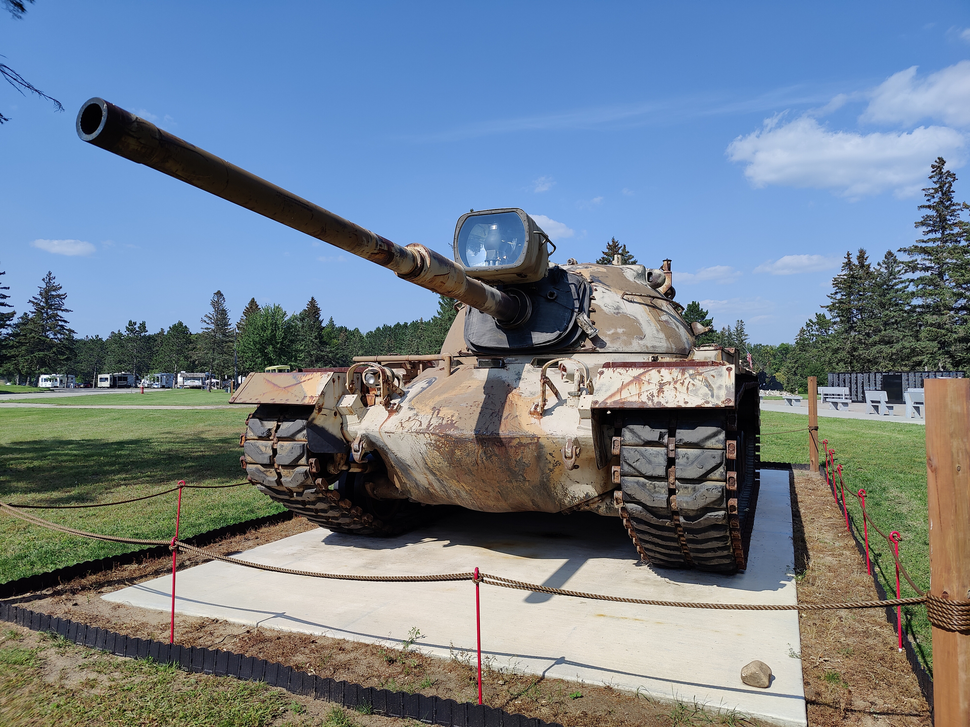

Great pics. One has a riser! There is one in MN, but with desert colors.
