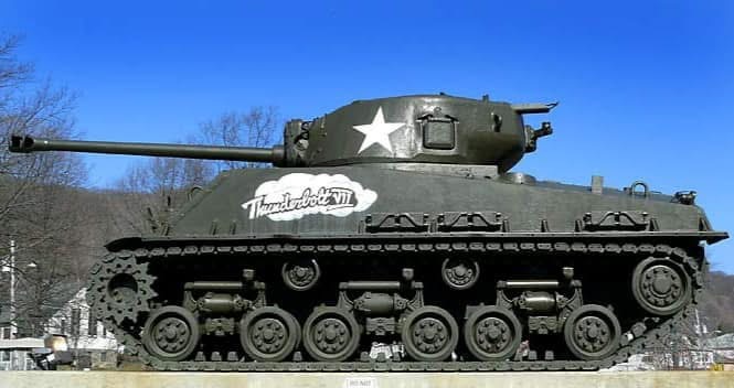

AFAIK, all these show Thunderbolt VII…a M4A3E8 (76)W.
Yes you’re right you have won a prize :trophy:
Thunderbolt 6 from X
Thunderbolt 7
Found in the USA after the war
Now on display

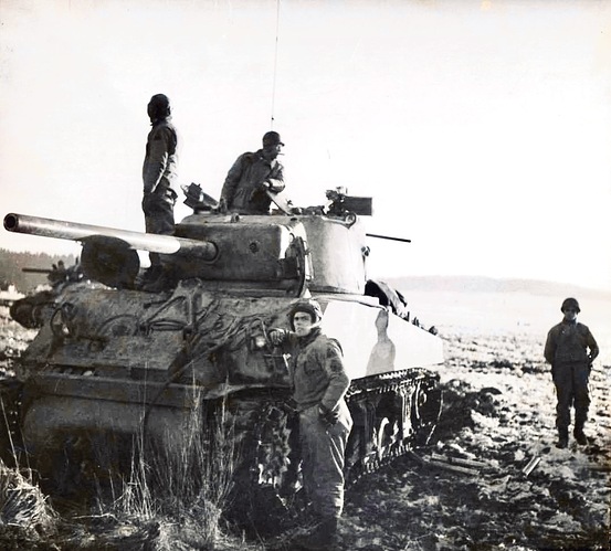

Regarding Thunderbolt VI, I recall reading that Col Abrams was requested by either the Combat Command or Division CO to use the newly arrived M4A3 76mm tank as an example for his men to demonstrate faith in the type. They had only recently been received by 4th Armored Division. He had previously been using 75mm gun types up thru the fall battles in Alsace Lorraine, and quite effectively.

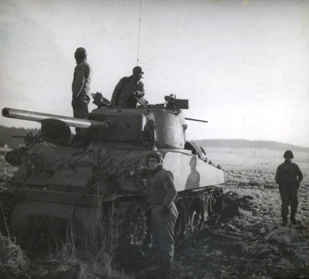

@ruzzaa

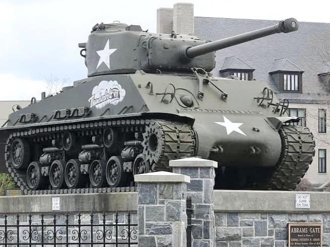

Wow! that’s the best picture I’ve ever seen of Thunderbolt VI. The extra lift ring on the turret and the smooth unthreaded barrel are both clear as day. Thank you for posting this!
That image also settles my concerns with the sprockets, CDA Shermans had those types of sprockets. I guess I’ve always associated the solid plain sprockets with later versions of the sherman and the fancy cast or forged sprockets with early sherman types and it’s just not the case at all.

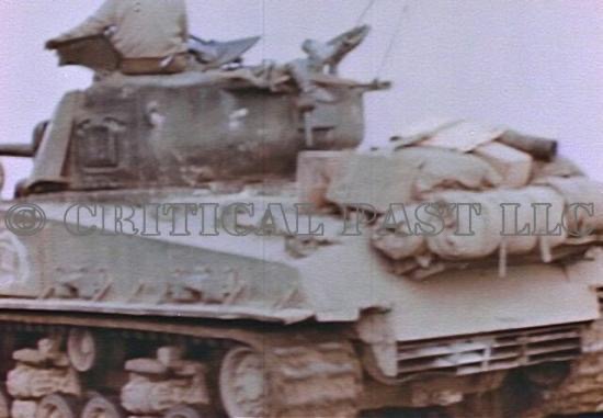

One thing that’s not apparent is the ventilator cover and the early cable clamp position on the upper hull. Considering that it had the smooth unthreaded barrel it’s almost safe to assume that the rest of the hull and turret are early types too. So one piece rear engine deck aft of the engine doors, either missing the MG stowage brackets on the rear turret or maybe they’re positioned in the early lower position. It looks to have the bolted circular plate cover on the forward turret antenna too. I think the Meng kit is the right one to use for this tank.

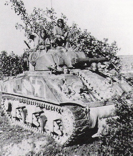

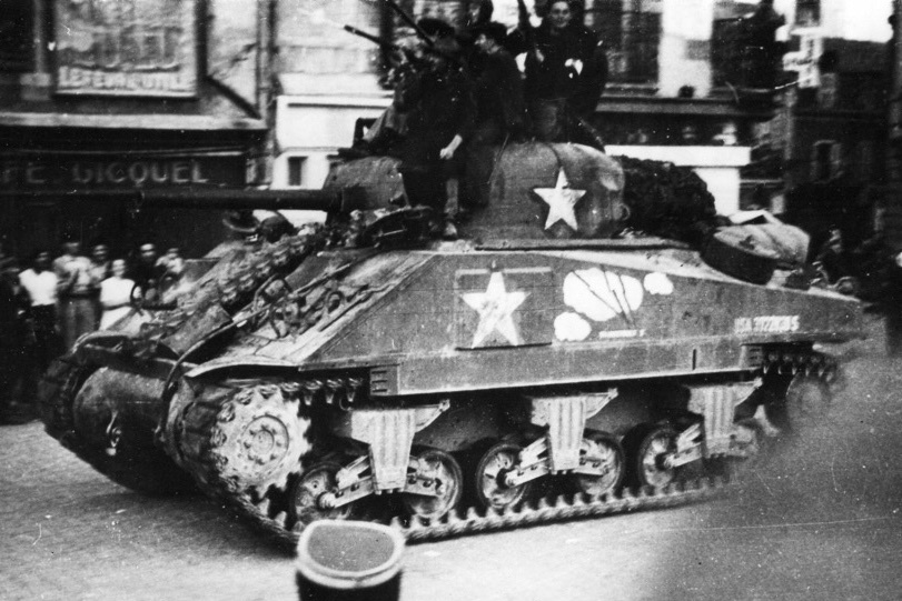

I’ve read the same thing too. Do you know anything about the 75mm Sherman he had before Thunderbolt VI? I have this image but no idea if it is Thunderbolt V or not, hard to see in this photo.
I think it’s an older M4 DV…turns out it’s a remanufactured Baldwin M4 DV with a Douglas device hedgerow cutter up front, that’s why it has the appliqué armor on the sides of the hull front of the turret and in front of the driver and co-driver hoods
Baldwin M4(75) with small hatches .

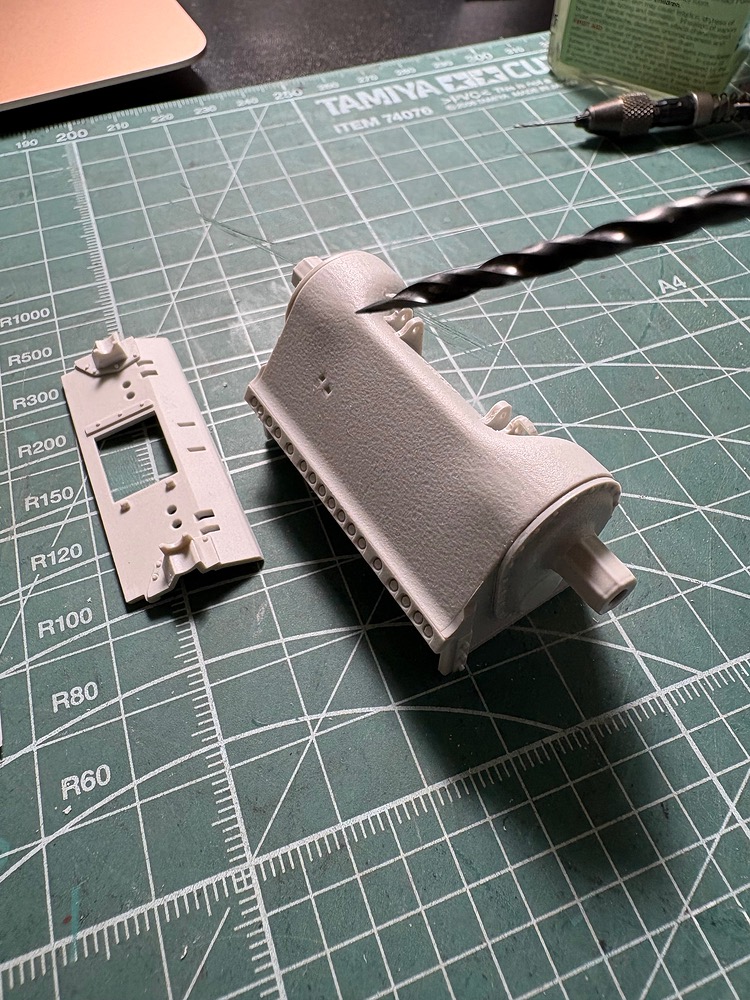

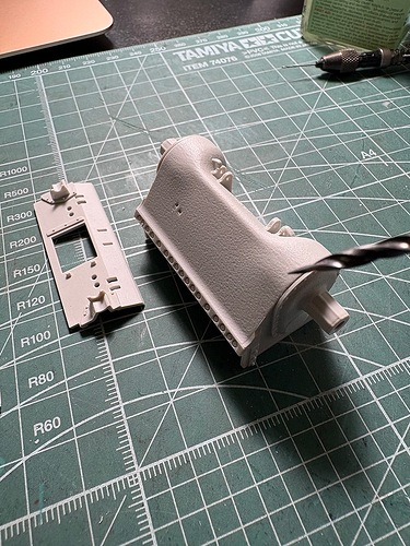

Starting out and noticed these bumps on the upper differential cover but will all be covered with stowage anyways so not messing with it but seems like the cover might have some unique contours I don’t remember seeing on any other Sherman kits with this late type of cover.

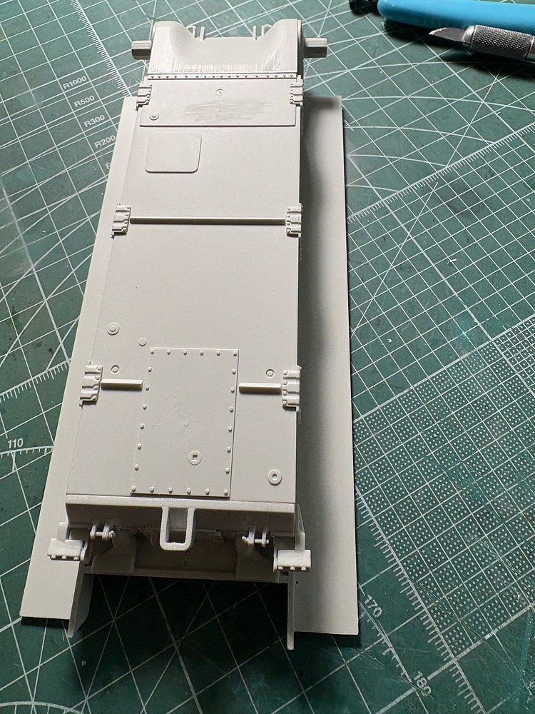

started on the lower hull as per the directions.
The picture you posted was taken in Vannes, France on August 5, 1944, and " provides a left side view of Thunderbolt V. Unfortunately, motion blur prevents us from getting an accurate read of the USA Number, but it can be seen to be in the 3022XXX range, indicating that it was built sometime from May through September, 1943 as part of Baldwin’s second Production Order. Along with the “thin spots” in the turret, the Ordnance Dept. found the pistol port to be a ballistic weak point, and in April, 1943 ordered that the turret be redesigned. The new casting did away with the pistol port, and at the same time, increased the thickness of the armor around the thin spots, thereby eliminating the need for the welded on turret patch. The redesigned turrets began to enter the production pipeline in the late summer of 1943, but in the meantime, the Government ordered that pistol ports on the remaining supply of original turrets be welded up. The lack of hinges indicates that Thunderbolt V had a welded up pistol port.
Counting heads suggests that Baldwin M4s produced from May through July, 1943 were built with welded up pistol ports. We would note that the welding up and subsequent elimination of the pistol port was not popular with tankers, and the Ordnance Department reinstated it back into the design in July, 1943. The reinstated turrets, which also introduced a loader’s hatch, began to appear in production in late 1943."
from http://the.shadock.free.fr/sherman_minutia/manufacturer/m4baldwin/m4baldwin_variants.html
