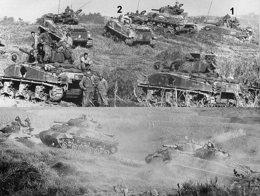

Is it safe to assume at least some of these were also used in the Pacific? Okinawa reportedly used lots and lots of tanks. It would explain how this type was also in Korea, seeing that many of the Shermans were derelicts rescued from Pacific islands.
Personally, I haven’t come across any photos of M4A3E8’s in action on Okinawa during the battle there. The Marines were using 75mm M4A2s and M4A3s, while the Army used the 75mm, 105mm, and flame gun, large hatch composite hull M4s and M4A3s. Yes, the battle losses of US tanks on Okinawa were significant due to the Japanese defenses.
The little-known Easy 8 with the 75mm gun did appear in the Philippines in 1945. These had started production in December, 1944 at Fisher, and a handful reached Europe before VE Day. The fighting in the Philippines continued into June, 1945, so they actually had some time to see action. There is a photo of a large number of them cocooned for sea transport outside Manila in August, 1945, and one has bands of black cammo paint, suggesting it was issued and used in combat. To produce one, just mate a late M4A3 75 mm turret with an Easy 8 hull. The turret should have the all-round vision cupola.
That’s probably a M4A3 105mm HVSS in the Phillipines. Some of those fought at Okinawa.
Technically the M4A3 105mm HVSS is also an “Easy 8” due to the suspension. But it’s not the M4A3 76mm HVSS that most modelers know as the “Easy 8” with the T23 turret and 76mm gun.
