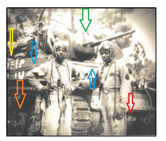

I will base my build upon this image:

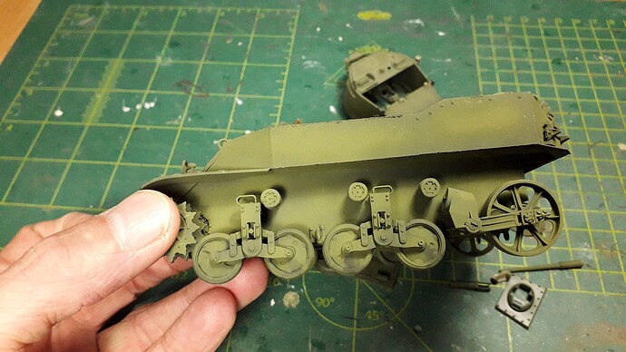

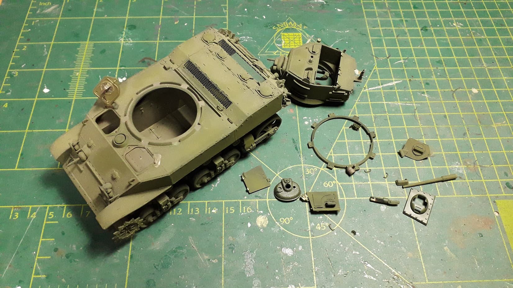

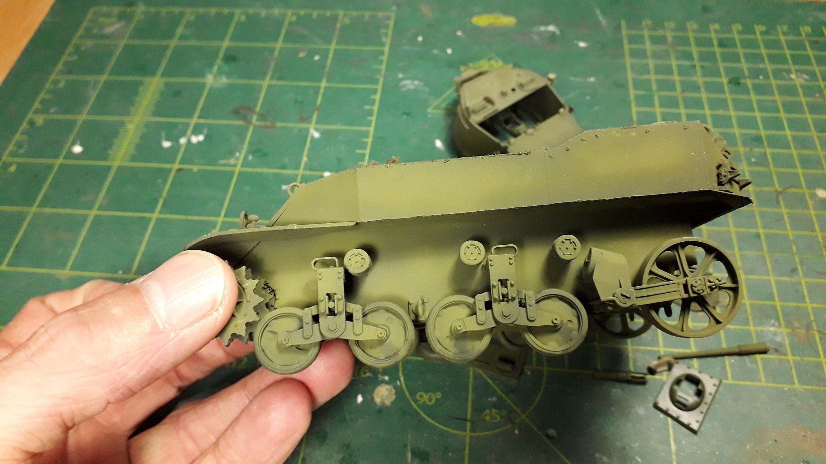

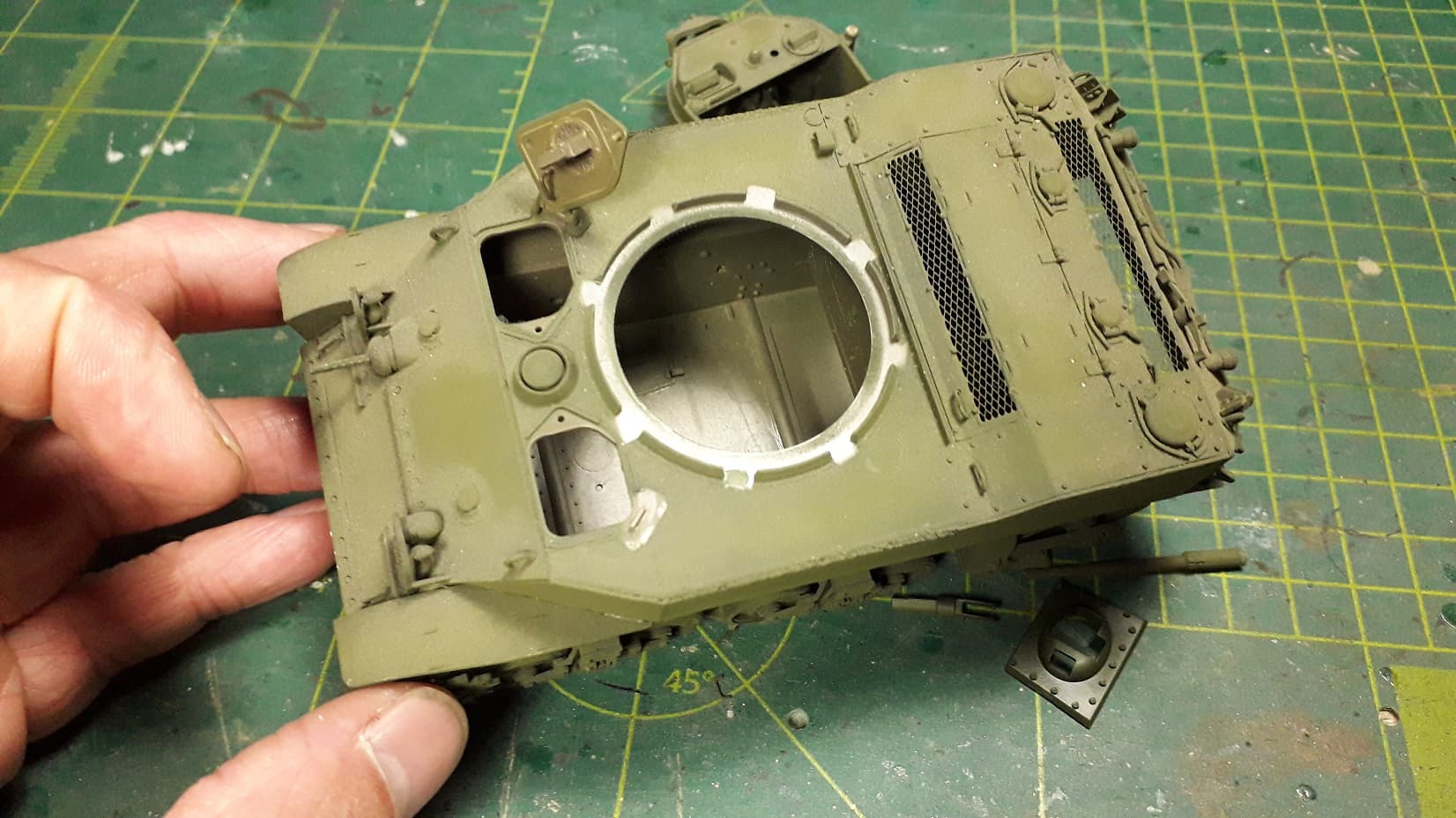

What I will be working with; the remnants of the AFV Club kit:
The lighter shade is dust. The real shade is seen on the glacisplate. Far too green.

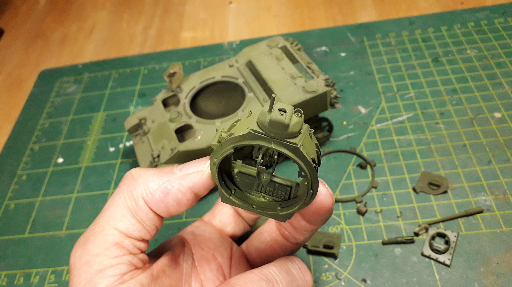

As I started dusting more parts fell off.
No interior colour.

The M5A1 I am using as a guide seems to have some rope wound around the hull? And big letters on the sides.
If you plan on doing a combat zone tank, I’d suggest using this photo as your guide. The other photos may be from pre combat training.
The rope you mention is a steel tow cable and visible with the eye hanging near the right side drive sprocket. In US Tank Battalions after 1943, the M5 and M3 light tanks were all placed in D company, while A,B, and C companies were equipped with M4 Shermans. So your bumper codes would likely read 3A 761^ D-xx
It is the early production M5A1 I have, so I’ll use that.
The rope, or 4 of them, I meant go around the hull horizontally and along the side, partially covering the B-16 markings. (Blue arrows)
I have some more questions with regards to the image in question.
Is that an early gunshield? Green arrow
If the Stuart was only in D-company, then why the B-16 numbers? Red arrow.
It seems to be an M5A1, due to the little “hump” over the enginecompartment. Yet I think I see a lot of stowage on the rear. Yellow arrow.
And the wheels are the closed/disk version. Orange arrow.
Picture is taken in the summer. That would mean either training, up to 1944, or Germany 1945.
That photo is most likely from pre war stateside training. From what Ive read, they trained for two years before being sent overseas in summer 1944. Yes, that is certainly an M5A1 tank.

Since I will have a crew with hatches open, I needed to add the quite prominent inner edge with rubber seals and divider.

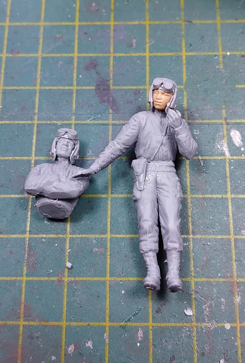

I also need a black crew, so made 2 of those with Miniart’s “U.S. Tank crew” with heads from Masterbox’ “Allied forces” and Tamiya’s “Modern soldiers”.
I had to alter their poses slightly, since these obviously are not meant to fit into a Stuart, but are meant for Shermans.
