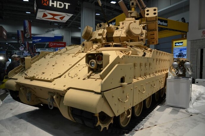

I have been working on a new conversion for a little while now. I have thrown together a concept M6A3 Linebacker, a.k.a Bradley M-SHORAD (Mobile - SHOrt Range Air Defense). So far, this is a concept vehicle by BAE that the US Army hasn’t bought…yet. I hope they do because SHORAD systems are woefully lacking in the US Army.
The actual vehicle.
It uses the .30mm chain gun from an Apache, Stinger pod, and all sorts of sensors and jammers.
