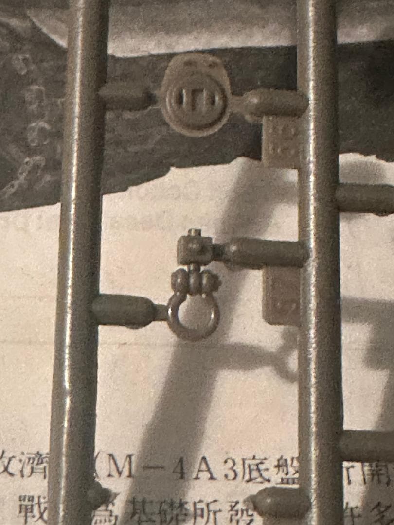

I checked one of my M88A1 kits.
My solder is too thin to match that part. Evergreen 3/64" rod is the perfect diameter for that. Good luck getting it into that shape. In spite of what people will tell you, boilign water won’t do it. You need an oven - that’s what I use. Or you can go old skool like Shep Paine - stretch some sprue to the right diameter and quickly wrap it around a rod. It’ll take several tires but it will work. And you’ve probably get nearly a limitless amount of resource material.

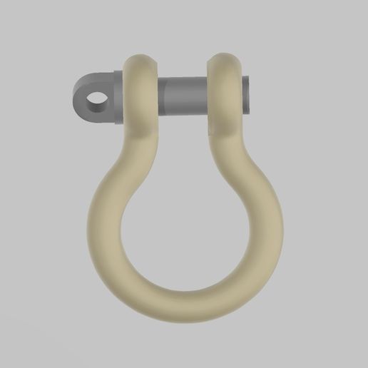

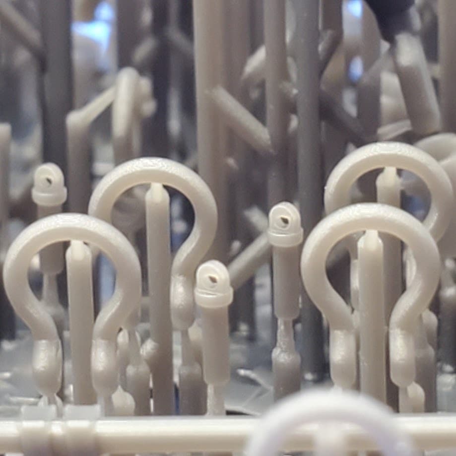

Mike, is it the same size as the shackles seen on Abramses and M60s?
My 3D prints:
let me do some measuring and if it is ill get a bulk order to you same as last time

I was unable to get the measuring done had to put up some shelves for the SWMBO last night do you have the measurements of the above mentioned shackle and ill get it done in the next couple of days. And I used the M88 light guard that you made ill get some photos up hopfully soon of the completed project so you can see your hard work being used for good.

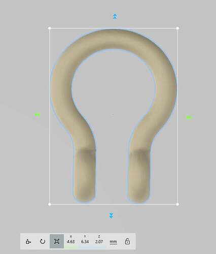

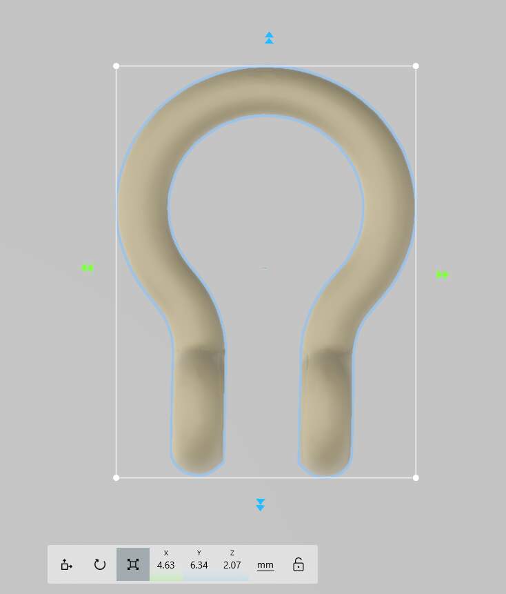

Hi Mike,
The outer width is: 4.63mm. Height is 6.34mm.

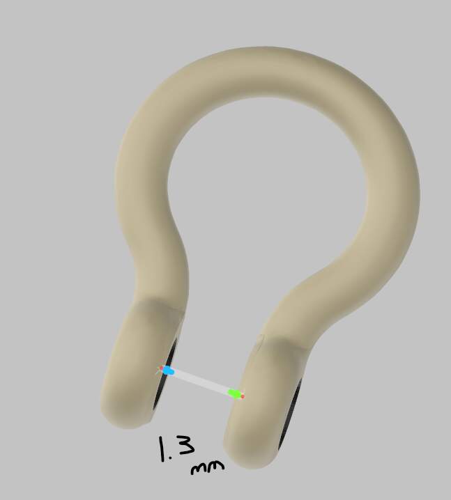

The space shown below is 1.3 mm:

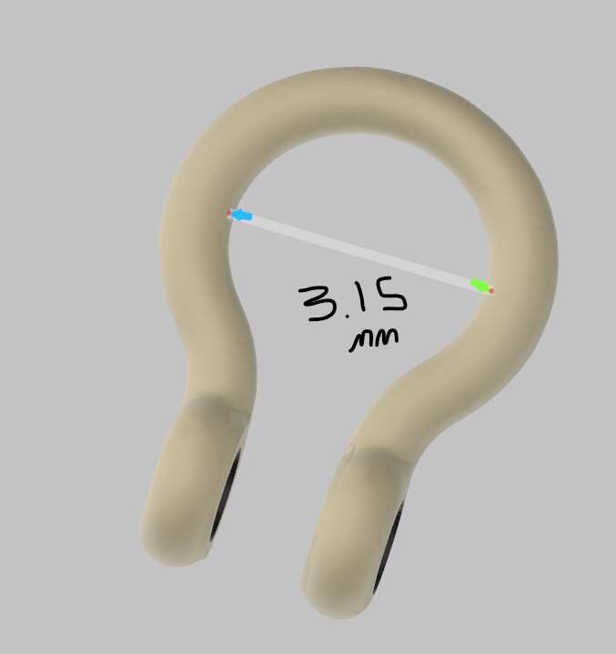

The top inner space is 3.15mm:
The beauty of CAD software is you can change the dimensions and sizes with some clicks of buttons if those dimensions are not suitable.
Ill get back to you in the next couple of days thank you for the response.
Ok so outside width is 5.0mm
Hight is 6.6mm
Internal width is 4.8mm
and the space between where the pin goes is .9mm
I think I can make this Abrams one work but last night somehow, I found the piece that broke off so I’m wondering in i can get it to glue back into place with out to much ugliness.
