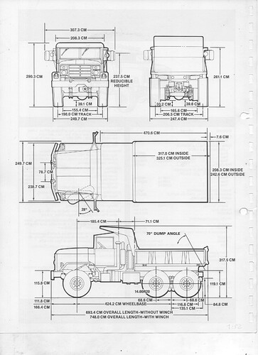

Hallo Andreas,
hier mal die offizielle Herstellerbroschüre von BMY

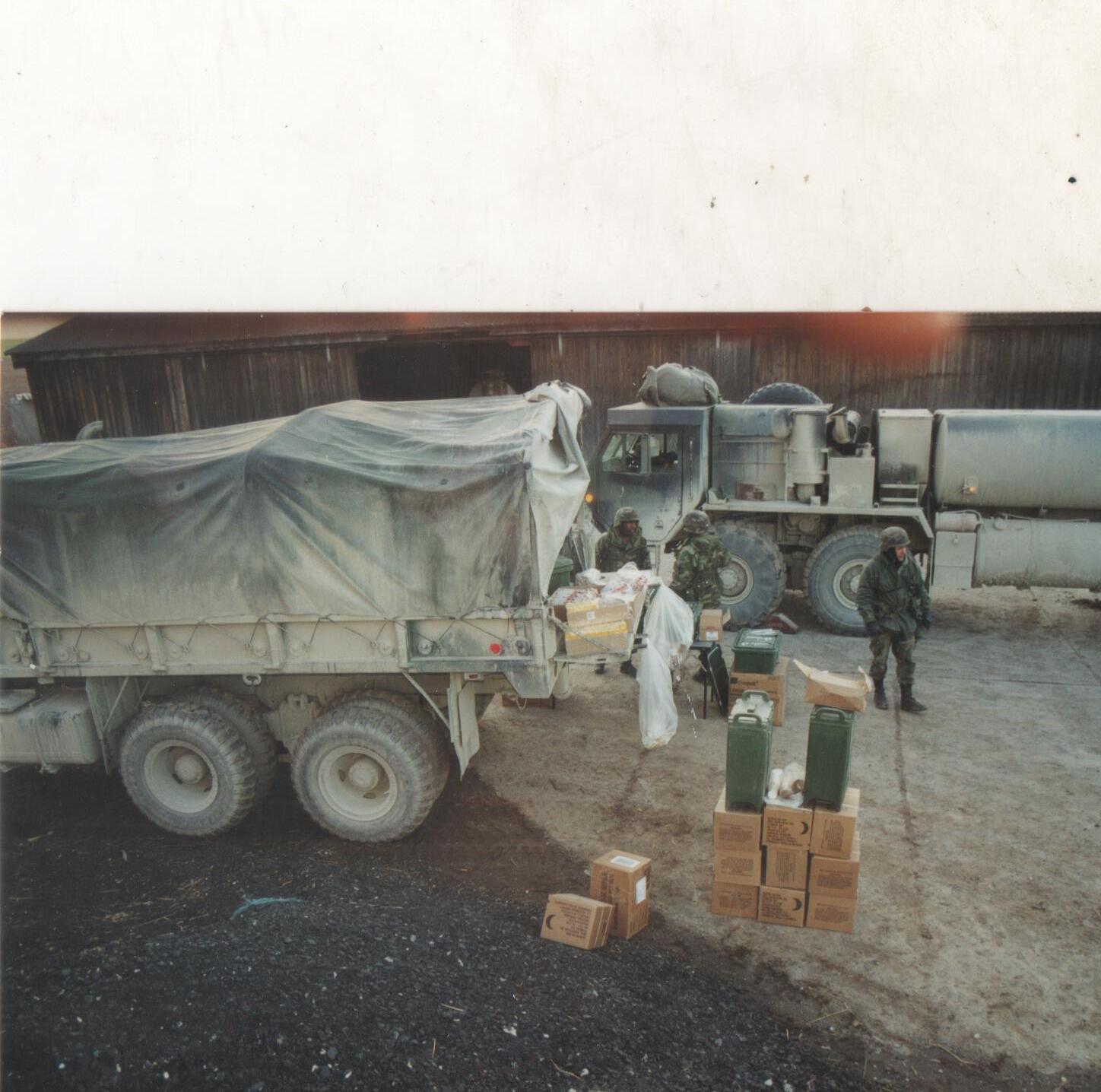

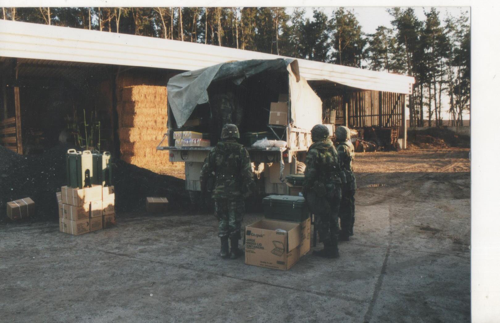

Hallo Andreas,
mögen diese Bilder als Inspiration dienen. :wink:

I plan on building this scene from a FTX back in 2001.

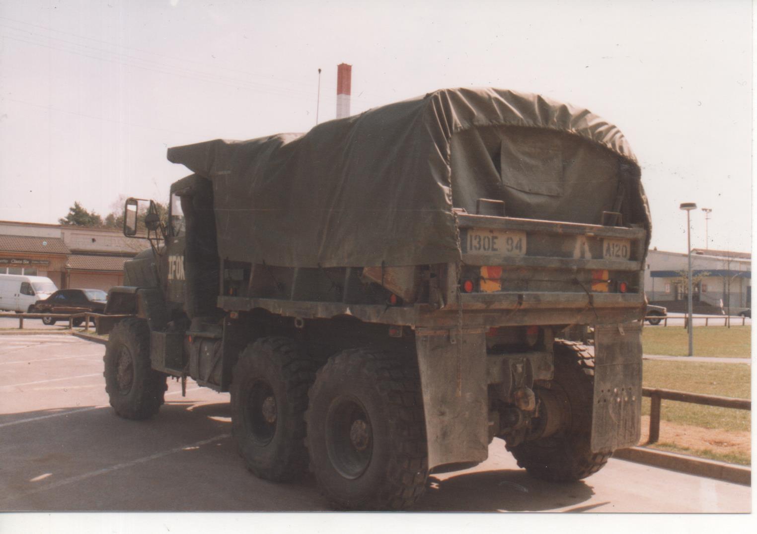

I actually rebuild the ILK model with hardtop und used the canvas cover from AFV Club´s M54 kit.
Nice. Are those the AFV Club brake/hub assemblies on it as well?
Yes Gino.

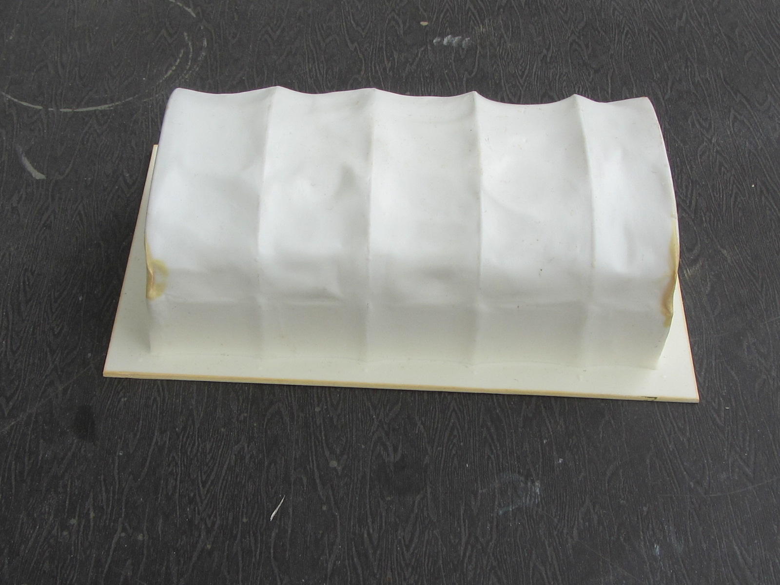

Hi Hans-Hermann. Wie hast du die Plane “kopiert”?
How did you made the canvas?
Andreas
Hallo Andreas,
It´s not a copy. It´s the old vacuformed canvas from Airmodel kit. I bought some Airmodel kits when they were discounted after the Italeri kit was released.
