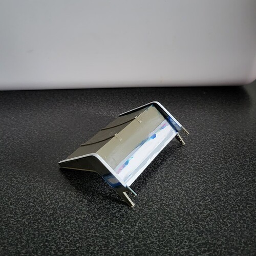

Small update which leads to a stop.

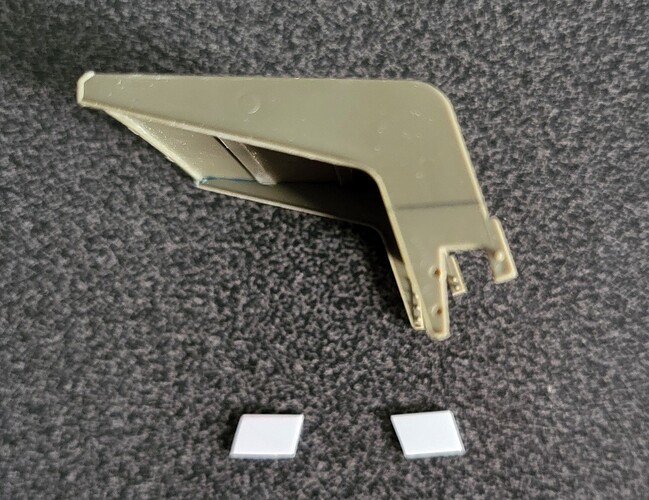

Unfortunately, I didn’t notice during my research that the protective shield of the cabin on the dumper on the M51 is shorter than that of the M929.
Now I have to think about what to do next. Ideas are very welcome!
1000021383
You can see it very clearly in Gino’s second to last post.
Hmm, interesting. Maybe add a piece to the bottom of the shield where it connects to the bed and raise it up a bit. The other option is to cut the top off the cab and go topless.
It’s an option, but with exhaust pipe installed It’s still to short.
Another idea is to build a gun truck but I probably won’t.
I think I’ll enlarge the shield with plastic sheet.

FYI ILK M923 fuel tank measures 32 mm.
First update, I raised the dump shield by 6.8mm.
@HeavyArty you counting 1" too much.
I made a dry fit and checked the measurements with the help of the drawing. @HeavyArty, thank’s again Sir! The measurements of the frame and the dumper, dumper to the frame are all okay. As you can see, the cab roof is pretty close to the dumper shield. I came to the conclusion, that the ILK cab is too high. know I can adjust the cab or I’m fine with it.
