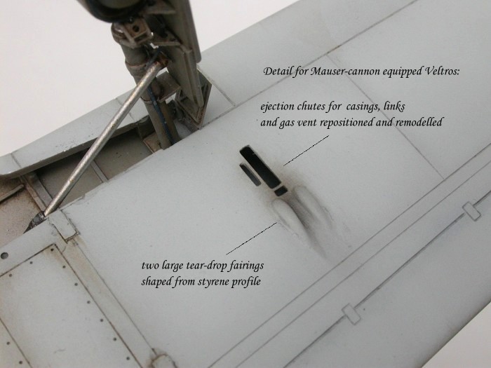

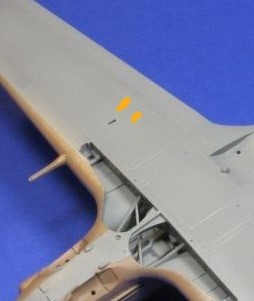

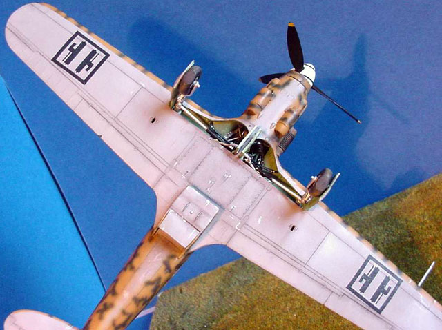

From Modeling Modeling review …. “The spent shell casing ejector opening underneath the wing is there but there should be two holes. This area is missing the small raised teardrop shaped “speed bumps” that protected the wing from spent shell ejection damage. The opening for the belt links is missing so you will need to open up a second rectangular opening for this and add its raised tear drop “speed bump”. I used an etched metal template from Eduard to add the second hole. See page 58 in the Squadron Walk Around for two good color pictures of the two per-wing spent casing ejection holes for a better look at this feature.” Anybody have access to mentioned Squadron book and can post the photos? Only visual reference I’ve seen is this from Italeris instruction sheet.
Just found a view of the bulges…
from : Macchi C.205 by Werner Scheibling (Hasegawa 1/48)

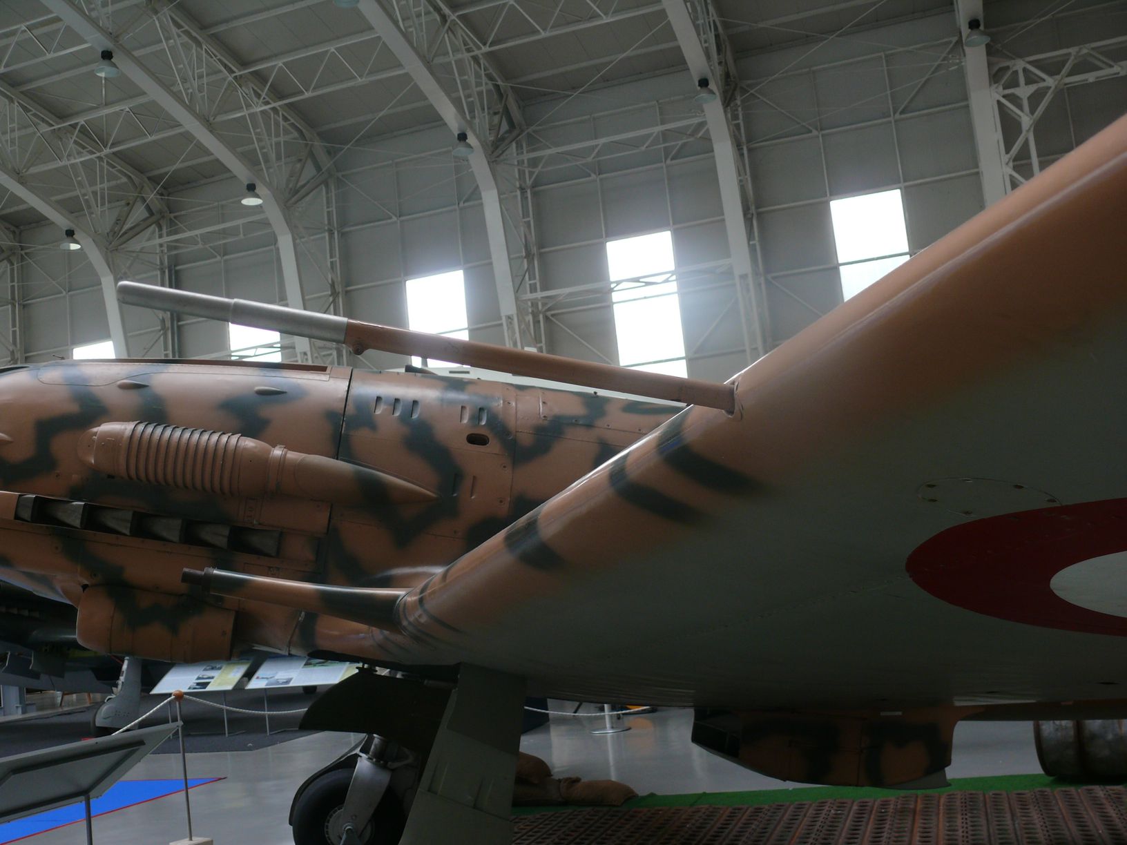

Weird they are not visible on the 1:1 one… :thinking:
The one below is a C.202 converted to C.205 standards
More info here : https://vintageaviationnews.com/warbird-articles/macchi-fighters-survivors.html
I dont see the ejection port either. (I see a “soot” smudge but looks too far forward to me.) Museum just stuck cannon barrels on a plain 202 wing?
The related article above states that the conversion was factory-made :
[this aircraft] was sent to Macchi for conversion to a C.205 Veltro due to a possible acquisition by Egypt. When that order failed to materialize it was returned to Lecce where it remained until its retirement on July 1, 1952.
