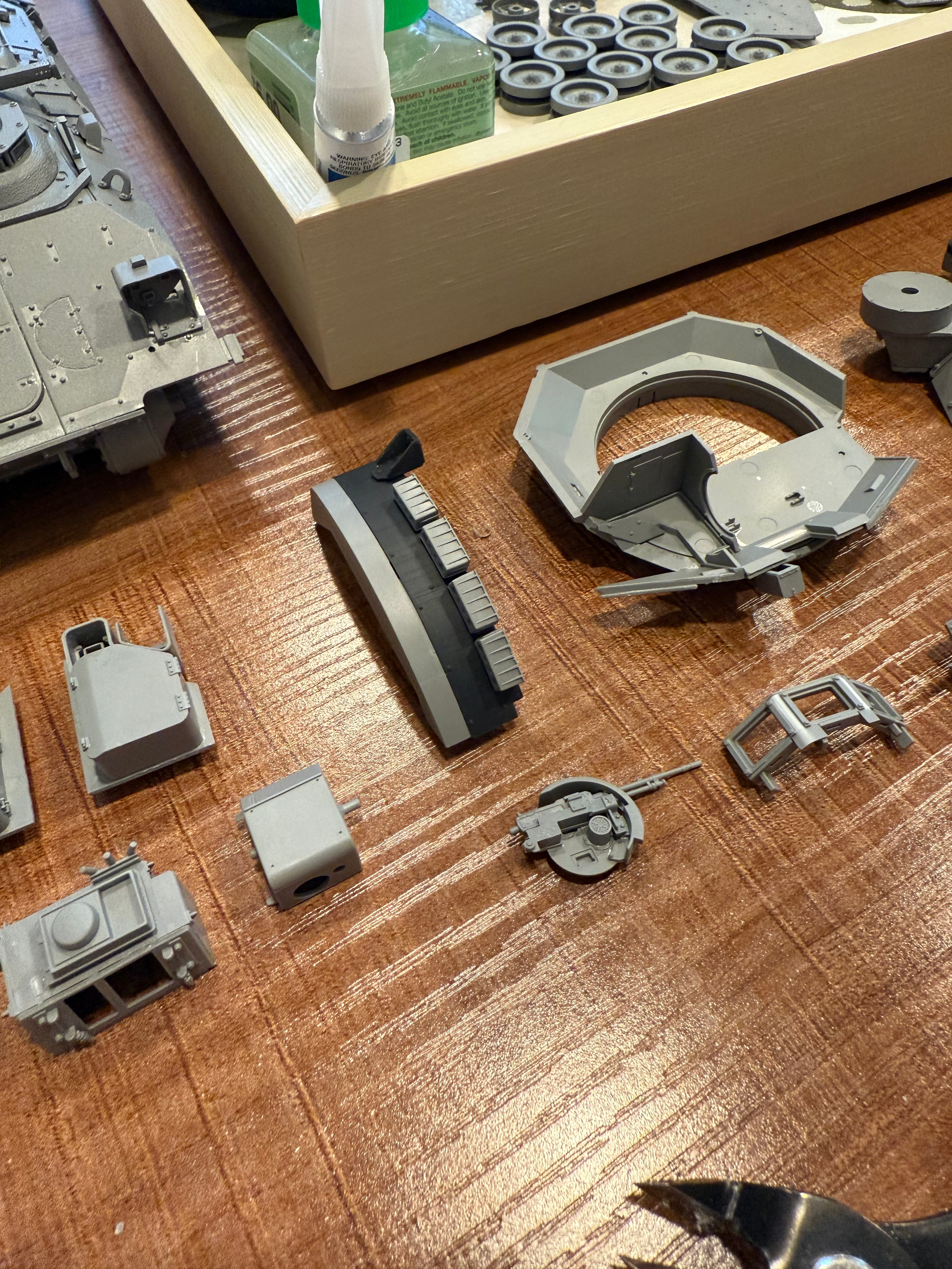

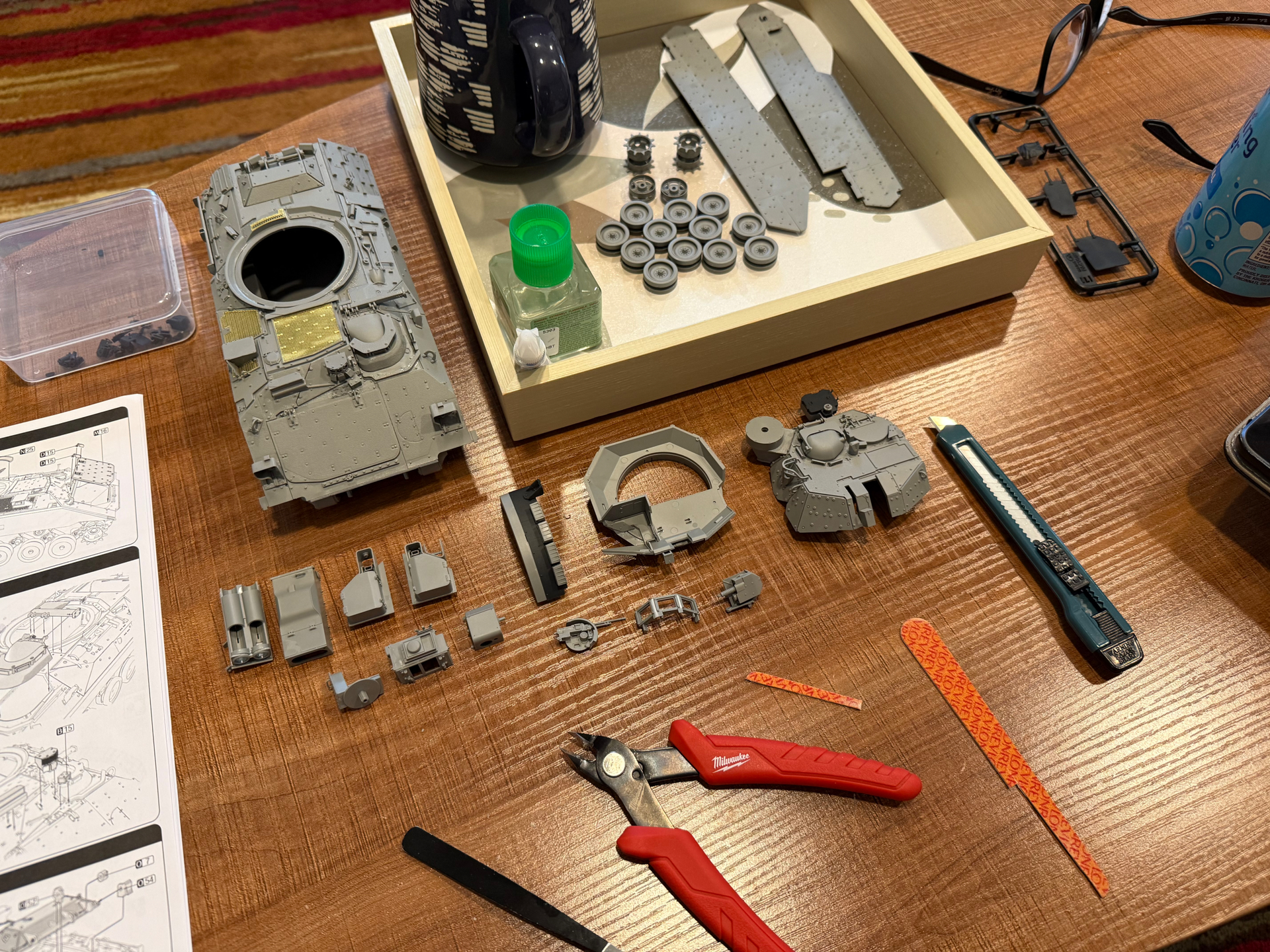

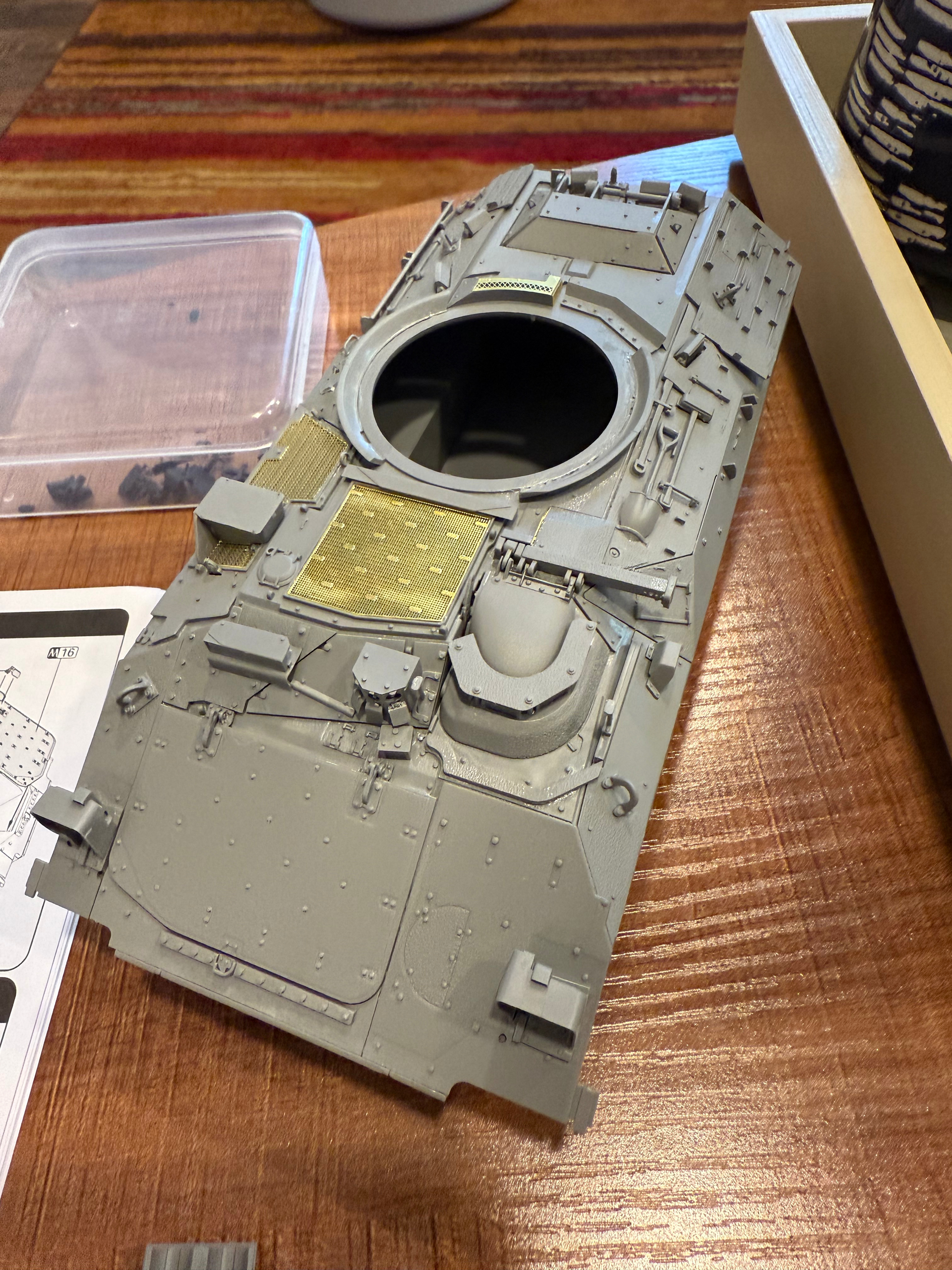

Working on the Magic Factory M2A4 Bradley, what a great kit, builds up fantastic, but there are a few inaccuracies in the instructions. I’ll touch on that a bit later. Definitely won’t be able to paint until I’m back in Las Vegas in a month or two.
Looks good so far. Looking forward to seeing it painted.
I’ll look forward to more. You’re not too far along to fix some of the more glaring issues if you like.

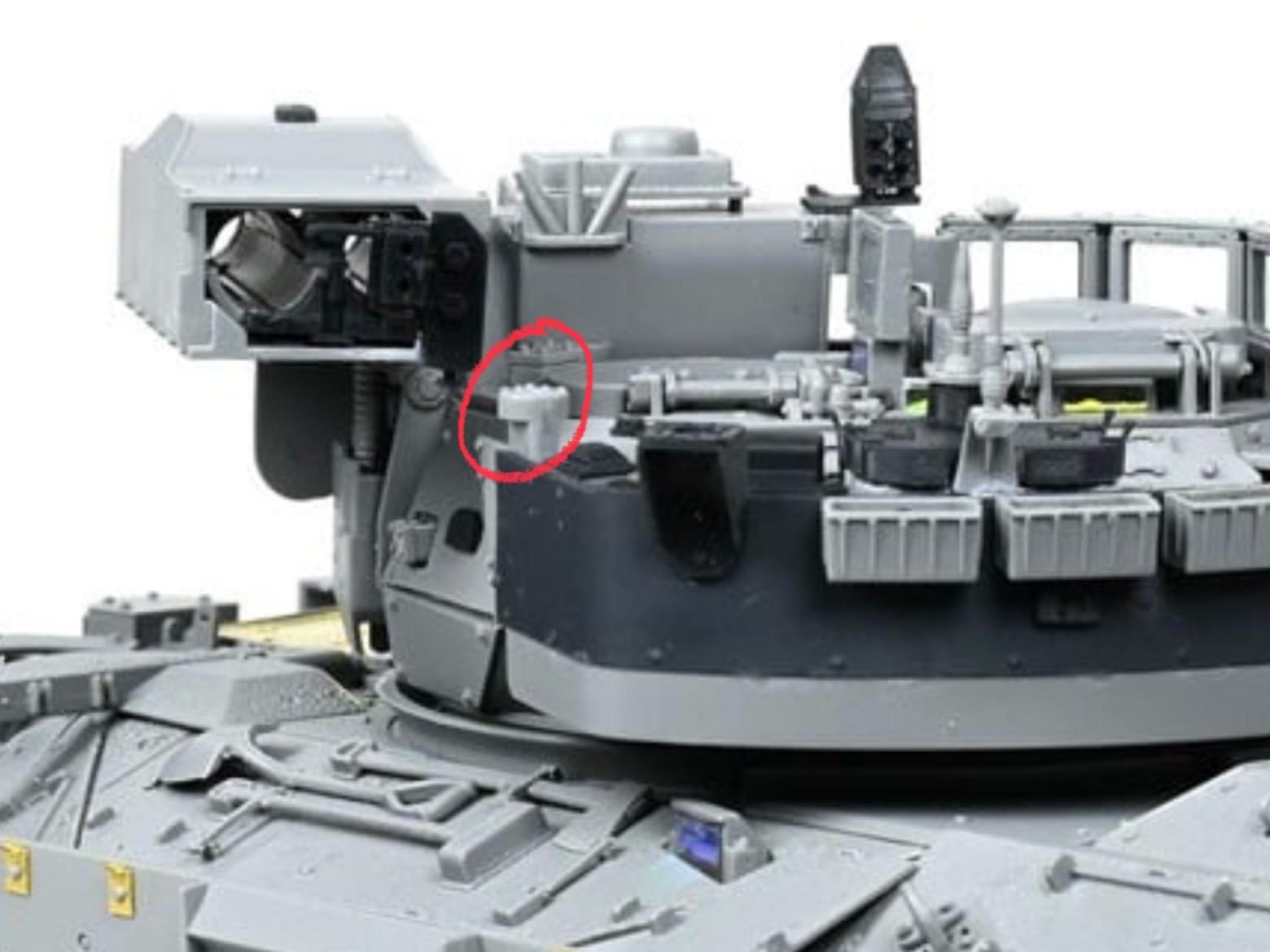

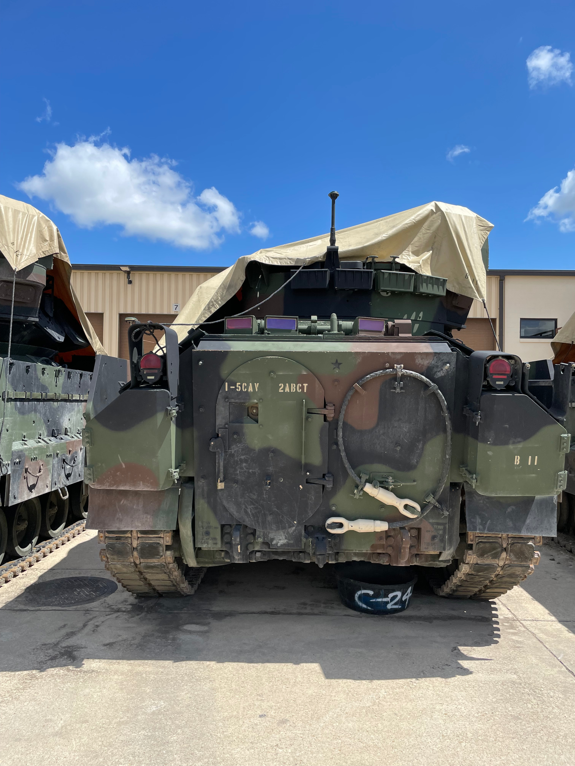

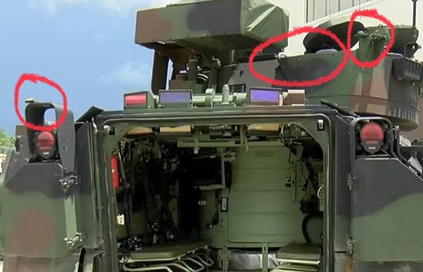

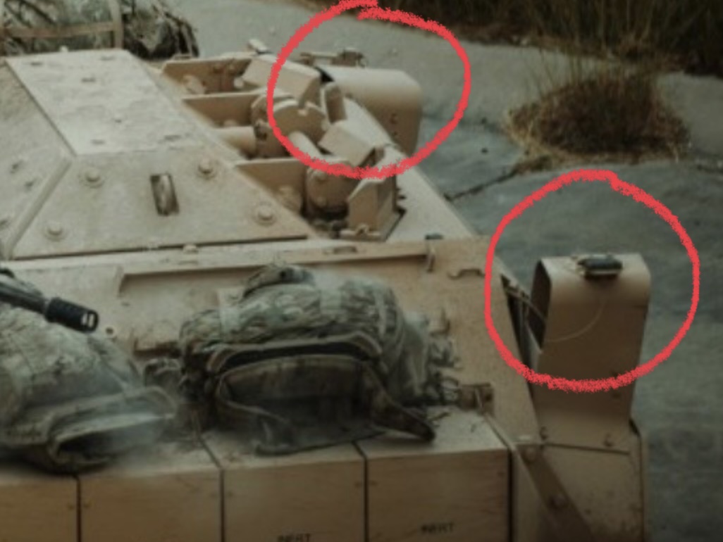

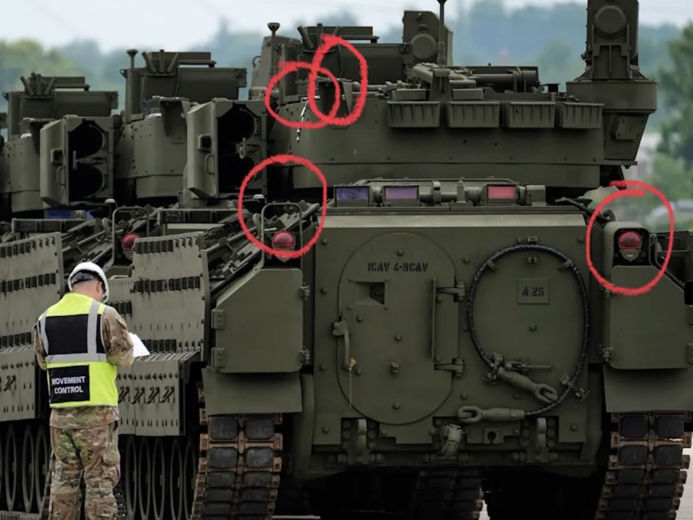

There should only be one high, or tall rear headlight guard, on the drivers side, and there should be no antenna base mounted to this, but, it does look like there is a small GPS looking device mounted there.

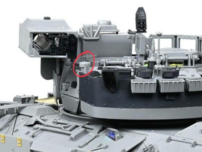

The antenna base on the far left side of the bustle rack, drivers side, should not be there, part J27.

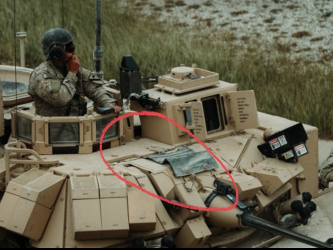

The gunners site?, the long articulated rod, part J8, and all its associated parts she not be there, every pic I see has this omitted, along with all the mounting hardware.
Most pics show the three tone nato painted A4’s to not have the ballistic windows for the TC, but strangely all the all green A4’s do.

I’ll post some pics to back up this dribble.
Exactly, and notice the small GPS looking thing on the left side guard?
And I’ve also noticed no sand colored “in service” A4’s.
