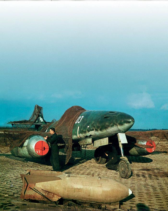

Great info. What bomb racks were used on the ME-262? Only designation I find is “Viking Ship”. As far as I can tell they carried 250kg bombs. ETC-503s modified to fit the shape of the 262s fuselage? Close to the 503? (have access to a set of racks from a Tamiya Me-262, if they will work.) Looks like Eduard has them but then I have to buy a whole kit for 2 racks.
They would be the ETC 504/Schloß 504, referred to as “Wikingerschiff” (‘Viking Ship’) from the curved lozenge shape of the pylon, resembling a plan view of a Viking longship, incorporating an aerodynamic shroud giving it the shape, covering the anti-sway bars. The photo below is of Me 262 V7, Wk.Nr. 170303 ‘V303’, seen here with an inert bomb, and fitted with Wikingerschiff bomb carriers
Well, solved the bomb rack issue. Tamiya’s 1/48 Me-262 kit has the “viking ship” and regular ETC 503 bomb racks. Have a “spare” sprue ( D-sprue) ordered up. See where this goes. Now, anybody know if the Hungarians use winter white wash on their aircraft? Specificly FW-190F-8s, winter 44-45.
