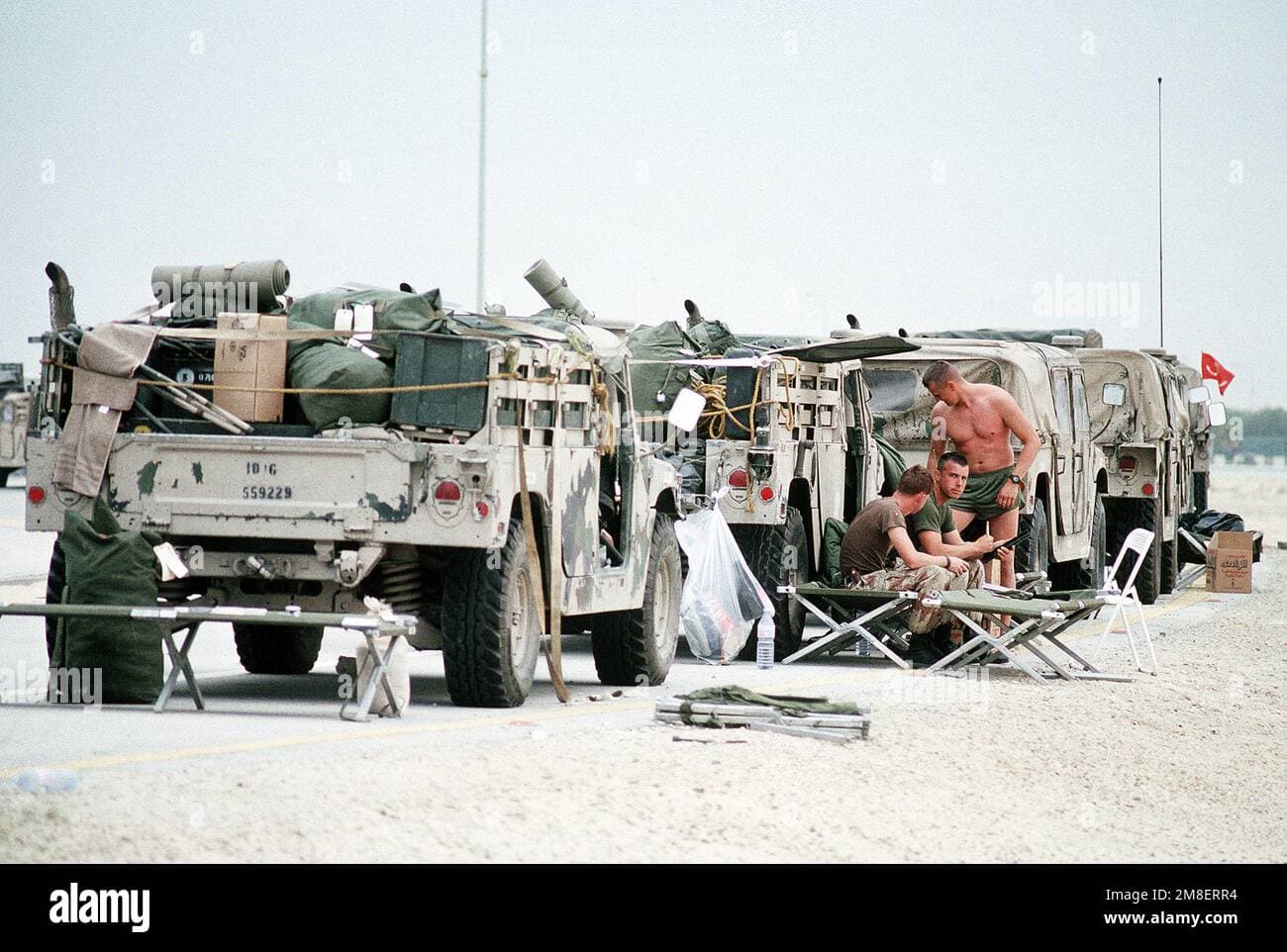

Some generic USMC HMMWVs during ODS. As you can see, they didn’t have many markings. Most of the HMMWVs did have the Coalition inverted V (^) ID marking on their sides and rear. Also note, USMC HMMWVs have the extended exhaust and the extended intake pipe.
