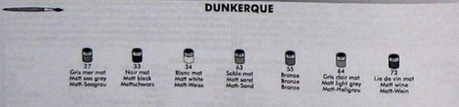

Here you can find the instructions for the Dunkerque from Heller. The paints used are from Humbrol
https://www.super-hobby.fr/products/Dunkerque-2277152.html

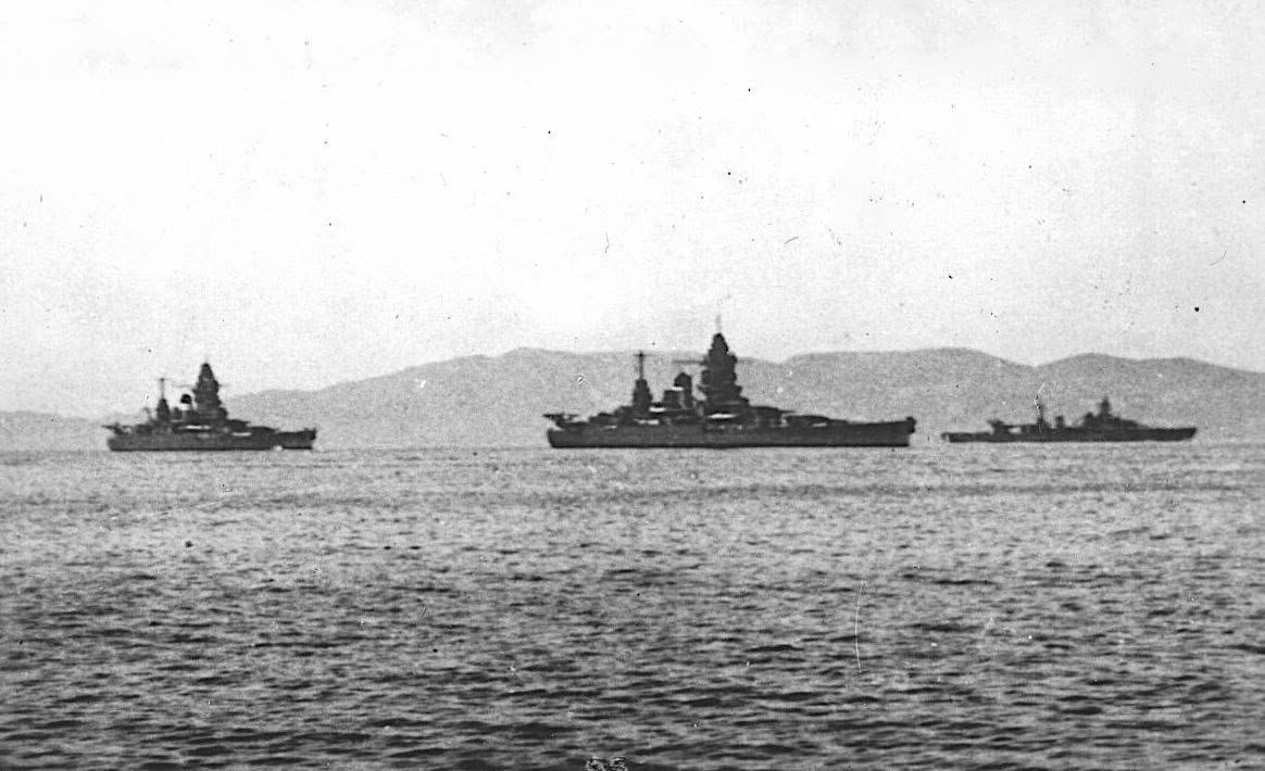

AFAIK this scheme is OK for pre-war but in 1940, both the Dunkerque and the Strasbourg were repainted into the darker “Atlantic Grey” scheme at the beginning of the year, with Strasbourg receiving the paint job in January and Dunkerque the following month.
French fast battleships Dunkerque and Strasbourg operating together between February-June 1940, with a La Galissonnière-class light cruiser at distant right.
