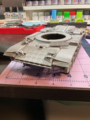

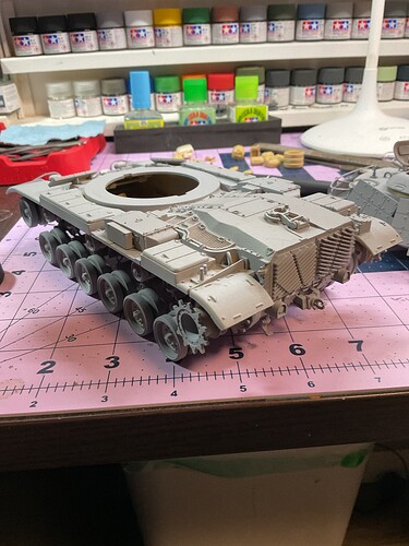

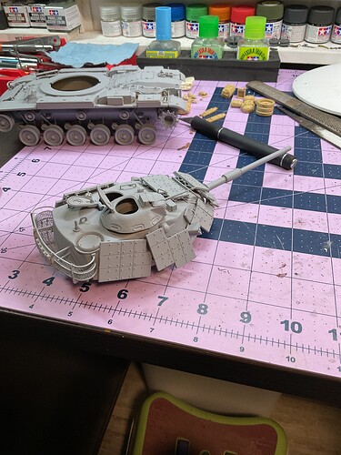

2nd quick question, I have the Tamiya M60 w reactive armor built OTB and had it sitting around for stowage and for my paint skills to improve vs when I built it. Any easy improvements to be done. Didn’t see a thread here when I searched but if there’s some easy finishing touches now would be the time. Any references or idea there are welcome.

AFAIK the chocolate chips should be fine, I don’t think the M60A1 crews were issued nomex.
As for the tank itself, if it is already built (please post pics) there may not be much you can do. You could replace the vinyl tracks with some after market ones, add some stowage, and some ODS markings.
The Tamiya kit is not bad, it’s just not up to modern standards. It still looks just fine with a little work.
Ken
Where she is at this point, I’ll move on to the stowage next and start painting. Using this set:

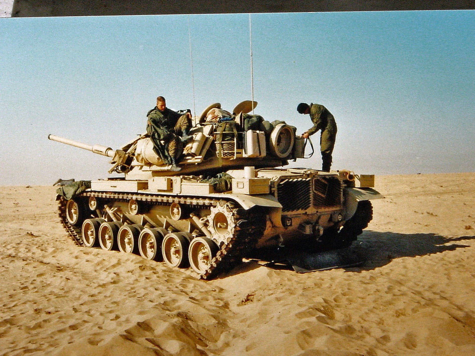

The tie down loops (footman loops) on the rear fenders should be removed, if possible.

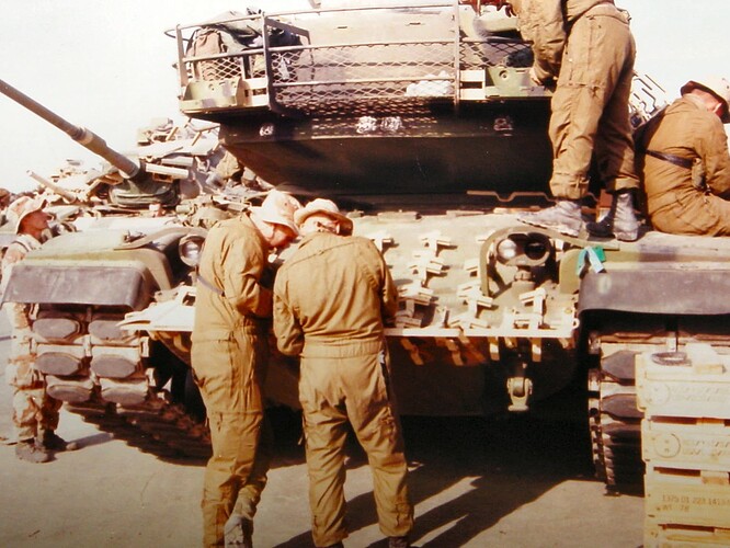

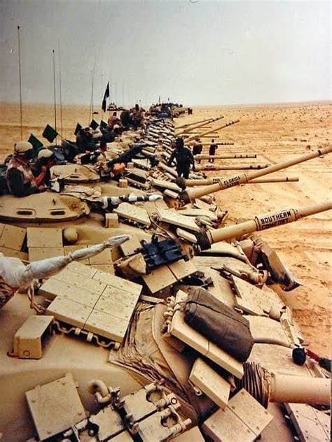

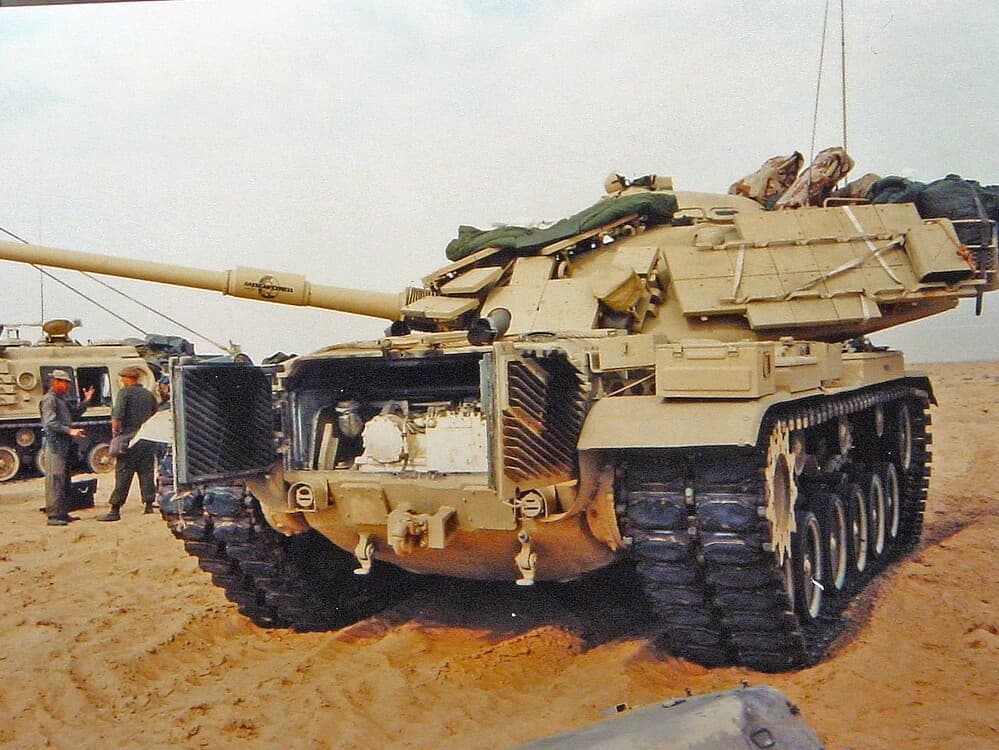

Those boxes on the rear fenders are unusual; also looks like some Marine M60 tankers did get nomex.
There are some other minor fixes that can be done to the Tamiya kit, but since yours is already built, it’s probably not worth the extra effort.
Ken

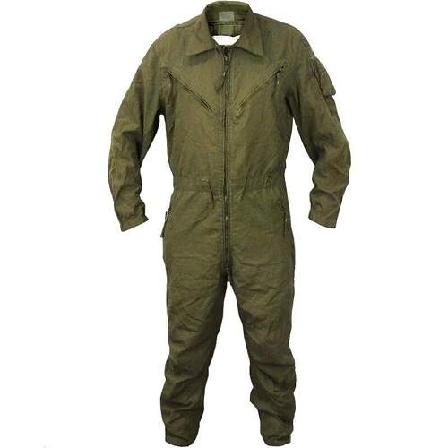

CVC Tanker Fire-resistant coveralls.

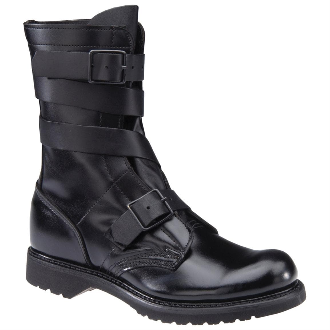

Black Leather tanker boots (Jungle boots were also used since desert boots were in short supply and not in general issue).

The boxes were pilfered and bolted to the fenders. We stored toilet paper and the like in them.

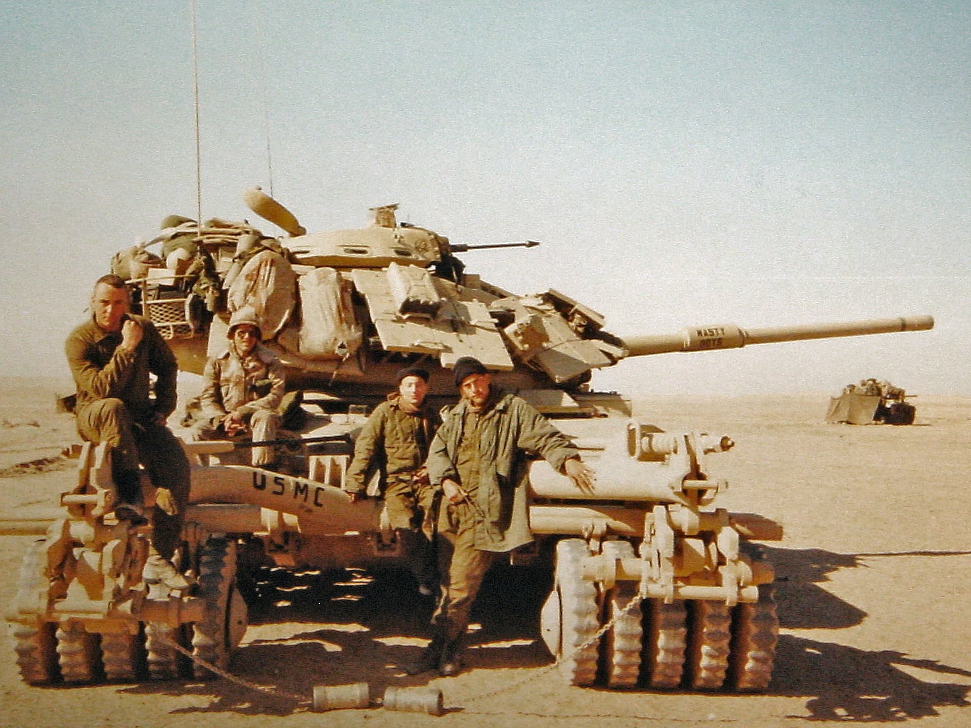

I built mine in similar fashion, though some details were omitted.
I used the Tamiya Marine M60A1 ERA as a bas with the mine rake off the Tamiya M1A1 w/ Mine Plow… Then later on i added the CLAMS marker unit made by @MikeyBugs, which was really well done.
Uniforms…A whole other story. We never got replacement for damaged uniforms. We started with a set of nomex. As they were worn/torn and ripped, there was no replacement. As the uniforms fell apart they were supplemented by whatever we had in our one seabag. Soon there developed a band of pirates with no two pieces of matching uniforms. I started out using nomex but after a couple of months they gave up the ghost and I started using a set of cholate chips. After a while they tore and were stained but there was no replacement. Lost covers became dew rags from the triangular bandage. When we eventually got back to camp 15, Some Sgt Major would not let us in looking like we did. The day before we returned to the US, they gave us a pair of desert boots…Would have been nice to have had them when we got in country.
Sounds about right. The Nomex wasn’t exactly made for the rigors of desert warfare. So thew Choco-Chips were prevalent by the time our forces entered into Kuwait.
As far as the boxes go you said they were field mods so is it safe to assume there would be some latitude in their sourcing? I’ll have a couple of large 40mike mike boxes that look approximately the right size out of that Tamiya Modern Military equipment set so I might play around with those.
