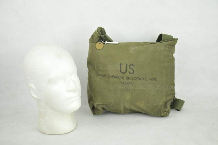

Am I correct that these guys would most likely have mask hanging off their hip close at hand if outside the tank. I’m referring to this specifically.

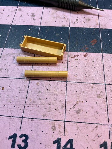

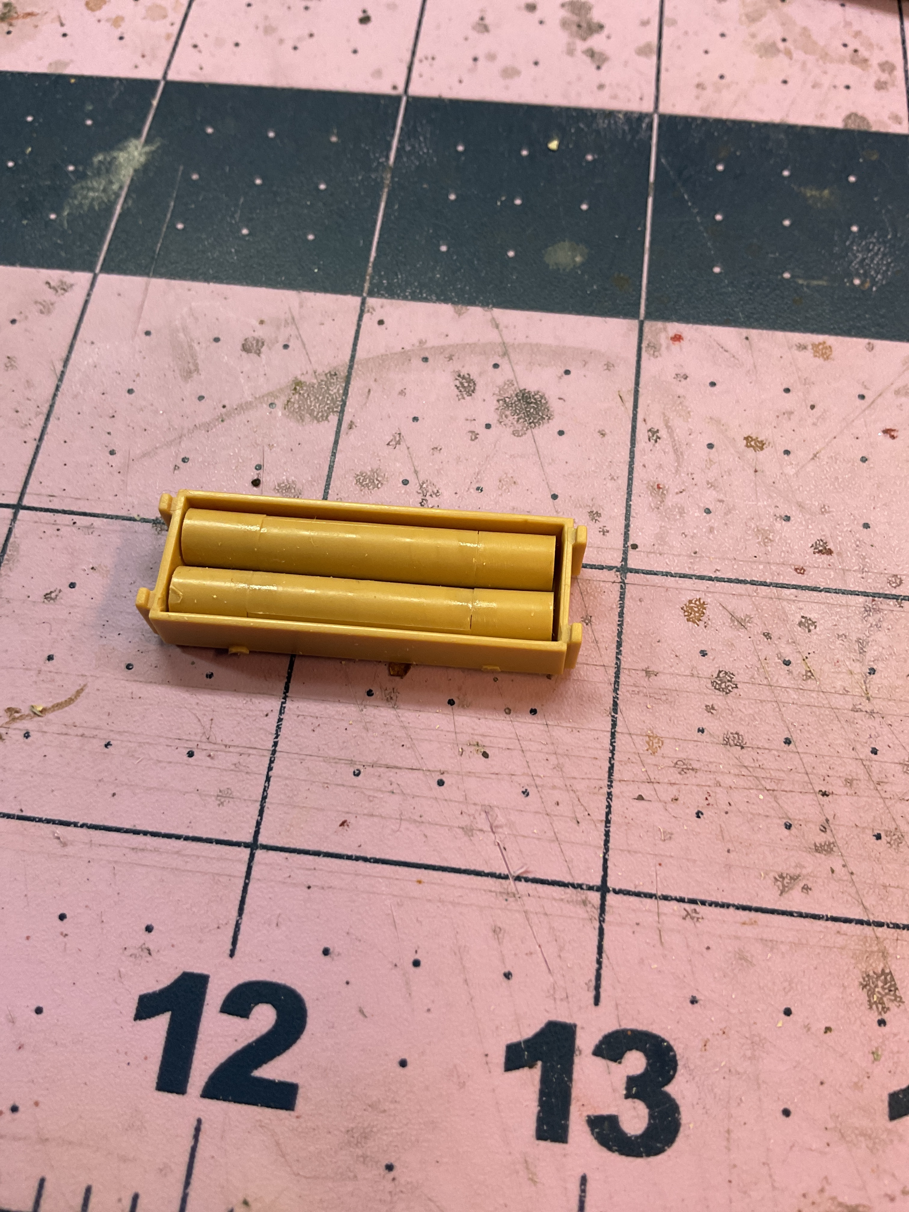

One last question, these tubes for the 105’s would be two per crate or was that an alternate way to ship the ammo? A

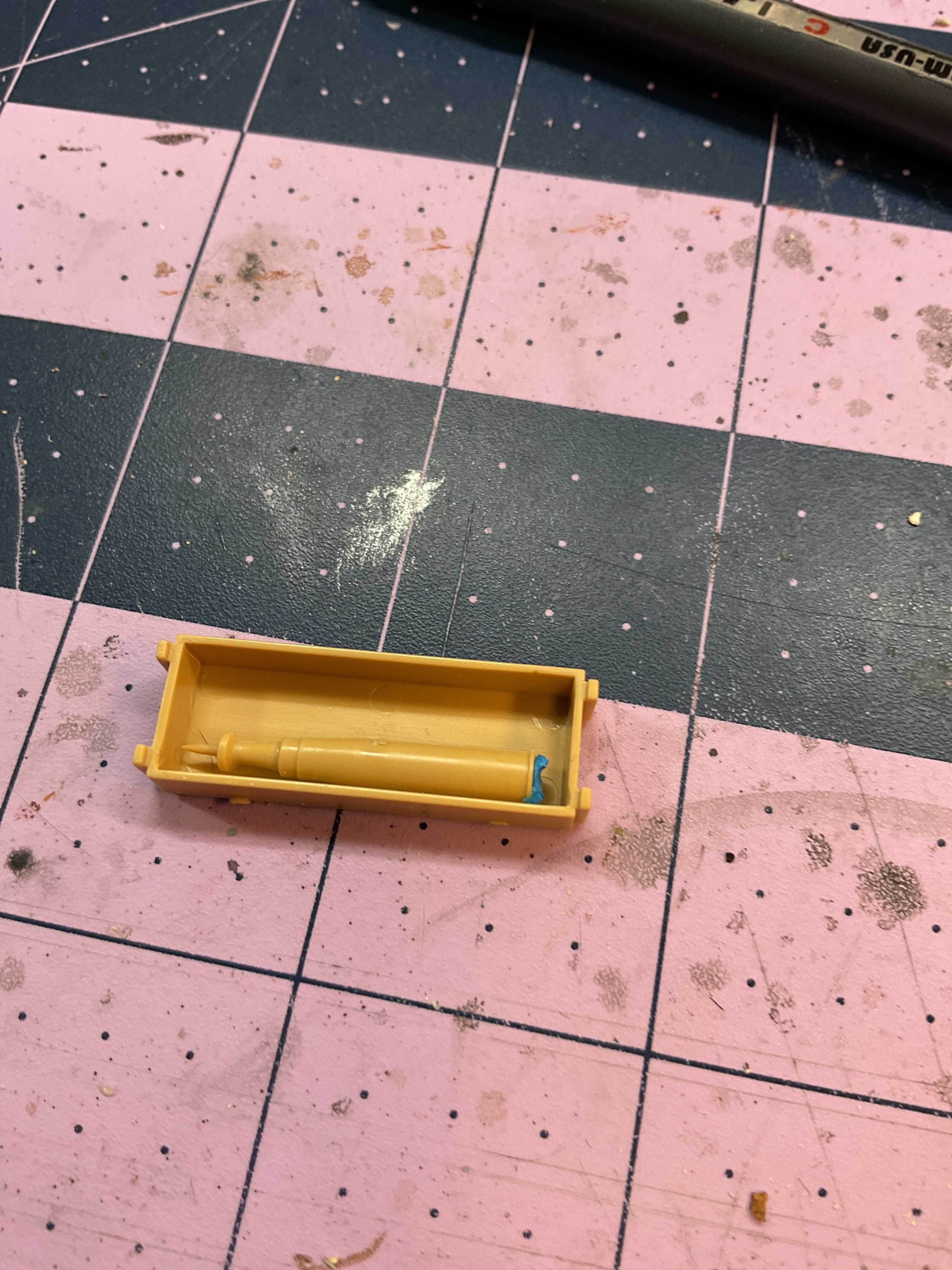

Or B

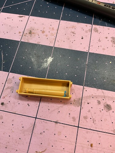

Finally C

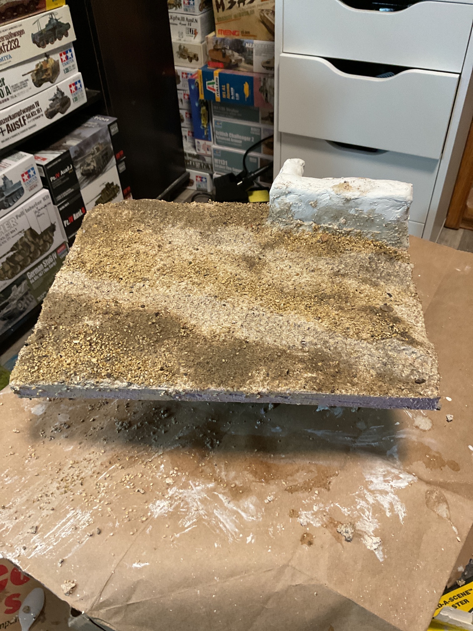

Thx again, like I mentioned moving on to stowage and whatnot while that base dries for a few days before I mess with it any more. The third picture seems to make more sense but I don’t want to assume because I can picture the 2nd making sense with say a brace with cuts in it running crosswise to cradle the rounds.
Looking just in this thread it’s half and half who has them and who doesn’t. Based on Top’s post it would really depend on what day you setting your diorama. Pre and DDay most likely yes, DDay+1 and post no.

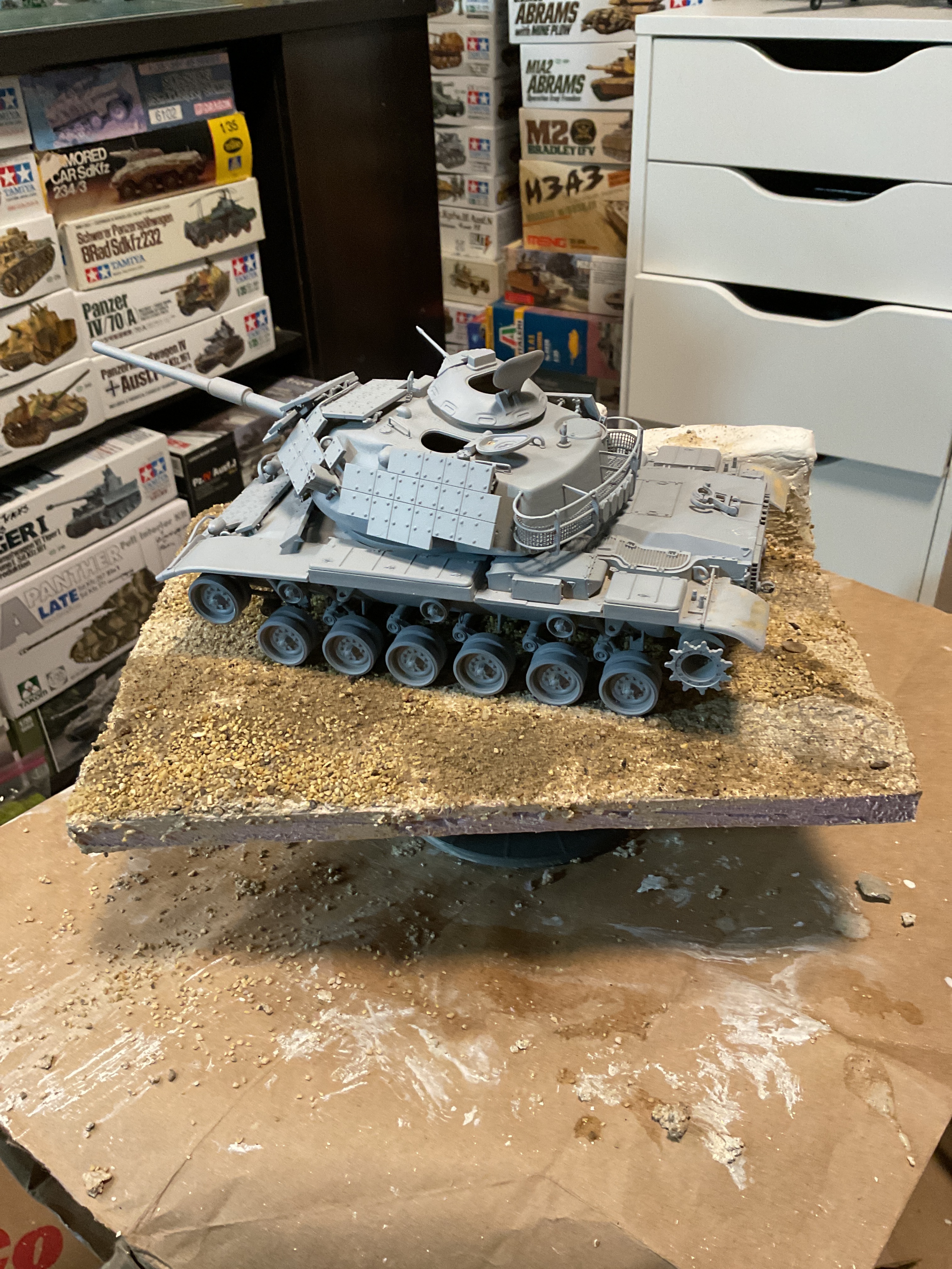

I would revisit the ground you have selected. I do not recall that level of rock and gravel.

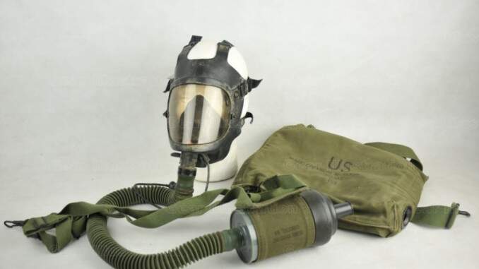

No. The mask in the picture, and pretty much all the masks I have seen in kit form, are M17 series infantry masks. Tankers wore the M25 series mask, which came in a totally different carrier.
check out the link here:
M25 | Gas Mask and Respirator Wiki | Fandom
As to the question about the ammo, yes, two rounds per box, with each round packed inside a brown cardboard tube, known as a tootsie roll.
For painting, the tubes are a matt dark chocolate brown. The old Model Master schokoladen brown is a good match. The ends are metal, painted in semi-gloss black.

Easy to fix, I hadn’t glued most of the bigger chunks down, brushed off most of it. I had sprinkled it out the plaster after I dampened it. I’ll blend the tones towards the back end on this when I go and paint that little mud wall.

Remember to cut off the little pouch at the back end and replace it with a small piece of rod. This replicates the end of the canister, which connects to a hose inside the tank.

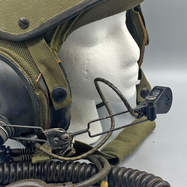

Are those mic’s just left side or can a guy swap it to whatever side feels most comfortable? I’m guessing each guy has one also, correct?
Each crewman has a mic’ed helmet. I don’t recall that you can switch sides, I am guessing not but never thought to check so it would be interesting to hear if that even possible.
cannot switch sides with the mike.

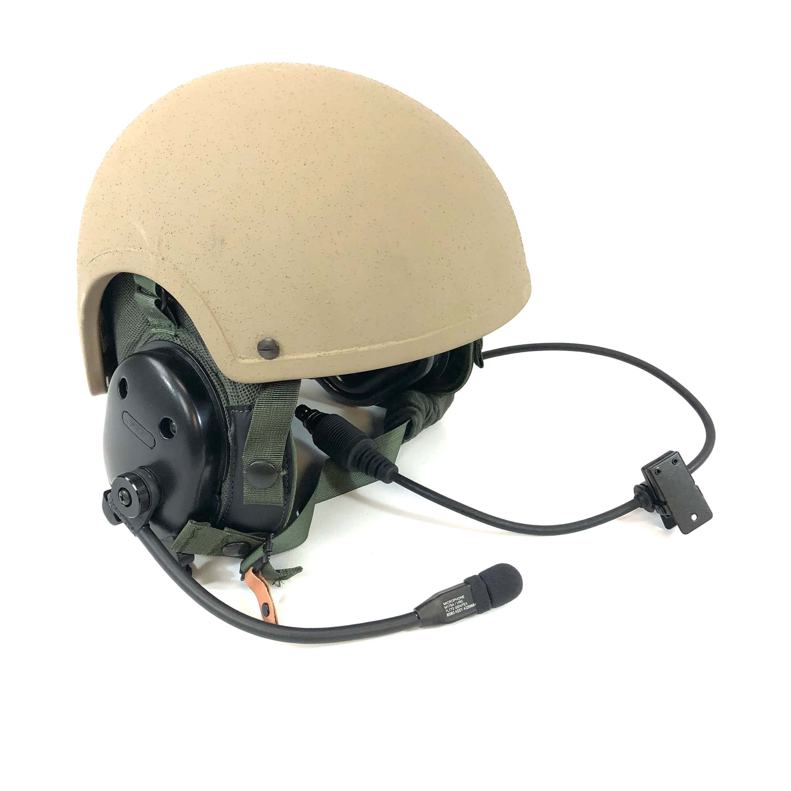

The mic is on the right side of the helmet, and cannot be switched around. The operating switch, connection cable, and electronics take up the left side of the helmet.

The boom mic on the older DH-132A helmets were bent wire and had the mic bolted into it.
Newer units had the boom mic redesigned.
