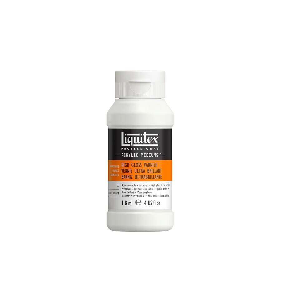

What exactly is pledge?
A “thick” clear acrylic. Used to protect the floor and plastic model clear parts.
All of the products are acrylic floor finishes. Pledge qua Pledge (originally “Pledge with Future shine”) was discontinued years ago, but there are a number of products replacing it. ‘Quick Shine multi-purpose floor finish’ is one of the more common replacements. It’s basically a clear gloss acrylic ‘varnish’ used to put a tough shine on floors — essentially gloss acrylic medium. In the modeling world, it’s used to create a smoother and more transparent finish for clear parts like canopies, sometimes as a gloss finish to create a smooth surface for decals, or used straight as a replacement for water when making washes — sometimes called ‘magic wash’ — to thin acrylic paints and inks to a high degree without getting tidemarks or having the pigment separate.
