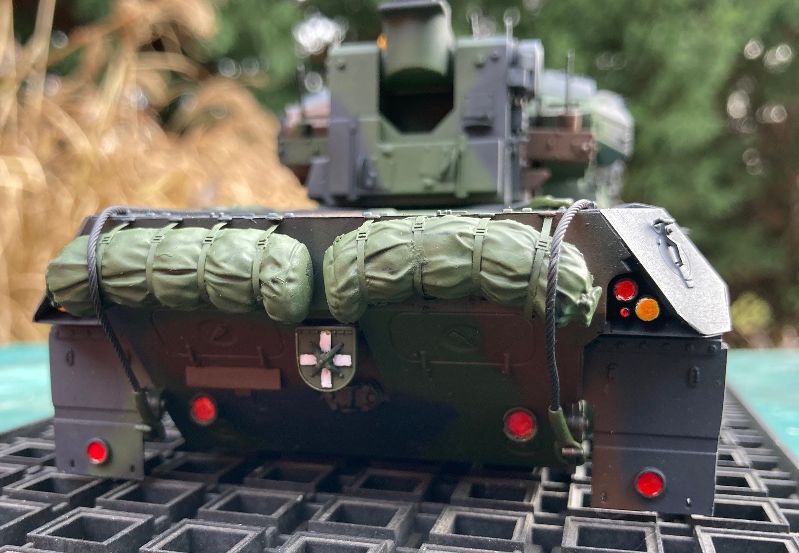

Yesterday and today I and painted various details including the lamps, headlights, the periscopes, towing cables, the smoke grenade launchers’ chains…
…and the two packs on the hull backside. Another side-note: these packs are provided with the kit, made from some vinyl stuff and pretty good looking after the mandatory scrape-off of the molding lines.
One more side-note: it is not a full OOB hence I used aftermarket towing cables (the kit comes with a poor looking thread only) and also the aforementioned chains of the grenade launchers. Both of them add a lot to the final look, highly recommended additions.
