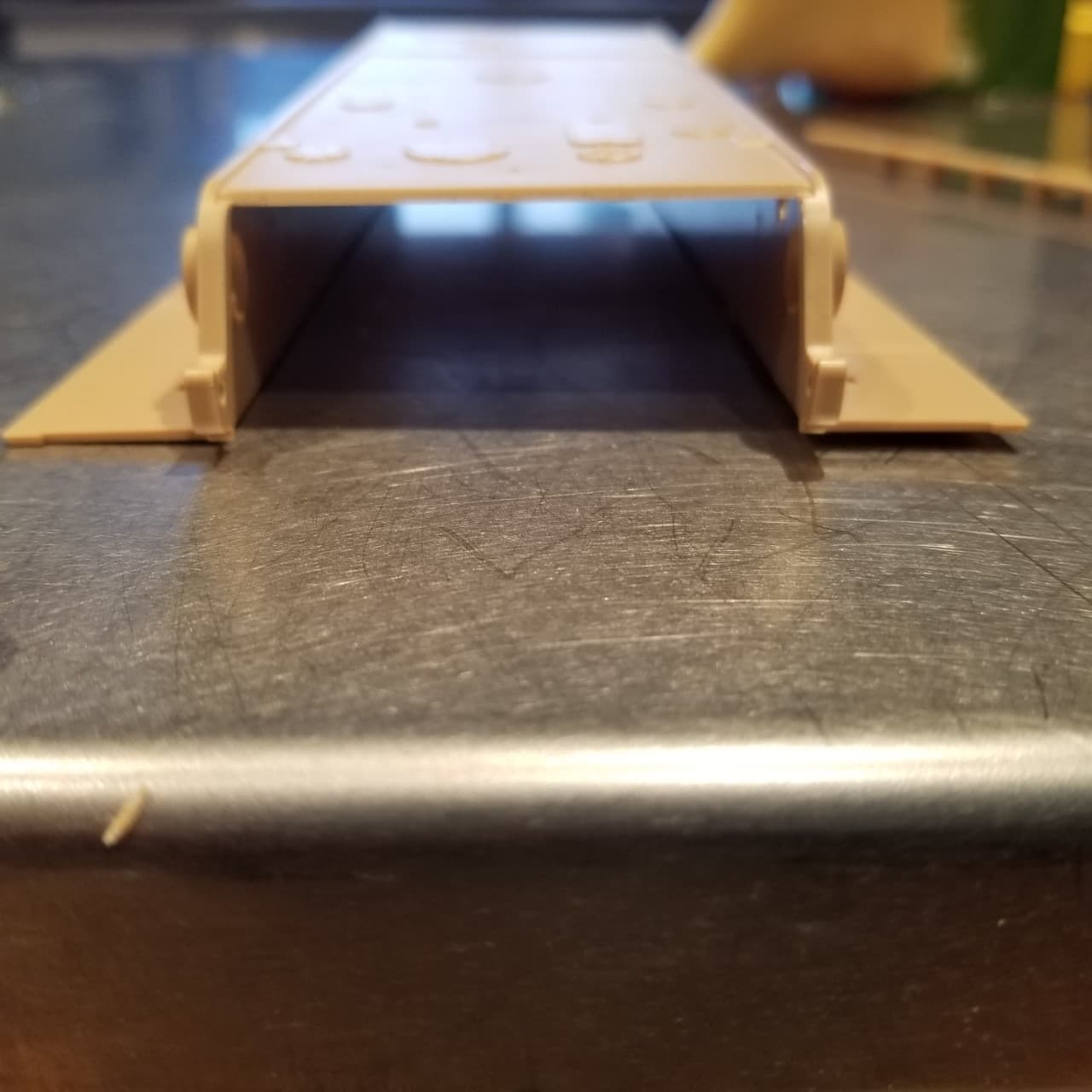

My hull is slightly warped but That’s not part of the issue but is fixable.

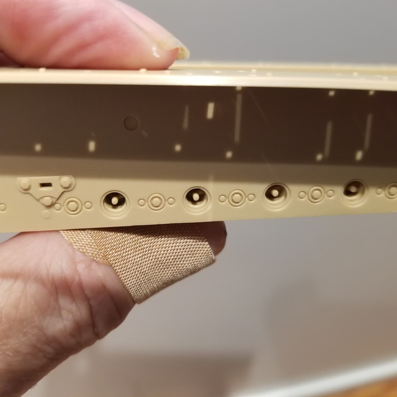

I believe it is part C3 and C4. This is the part you glue into the hull that the roadwheels attach to that is causing the issue.
I installed the part so that it fits properly inside the hull
Notice the holes for the roadwheel arms in the hull and the recpticals in parts C3 and C4 do not align properly. C3 and C4 sit too high in the hull.
The Fix:
I believe there are several ways to fix this if you know the problem ahead of time.
The simplest would be to sand the bottom edge of C3 and C4 until the correct hole to receptacle alignment is achieved.
