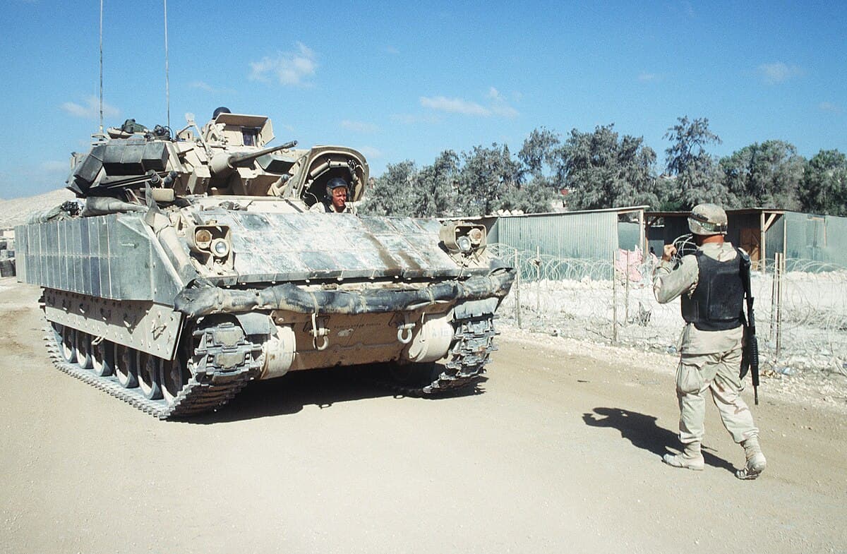

I’ve been trrying to find a Bradley build by James Johnson (JJohnson59) and I ran across this thread I’d never seen.
Not quite. February 1994
The original poster and I were discussing M2A3s and M3A3s in Iraq after '03. Yes, BUSK was also used on M2A2s by the 24th ID in Somalia in '93-'94 as part of UNOSOM II.
