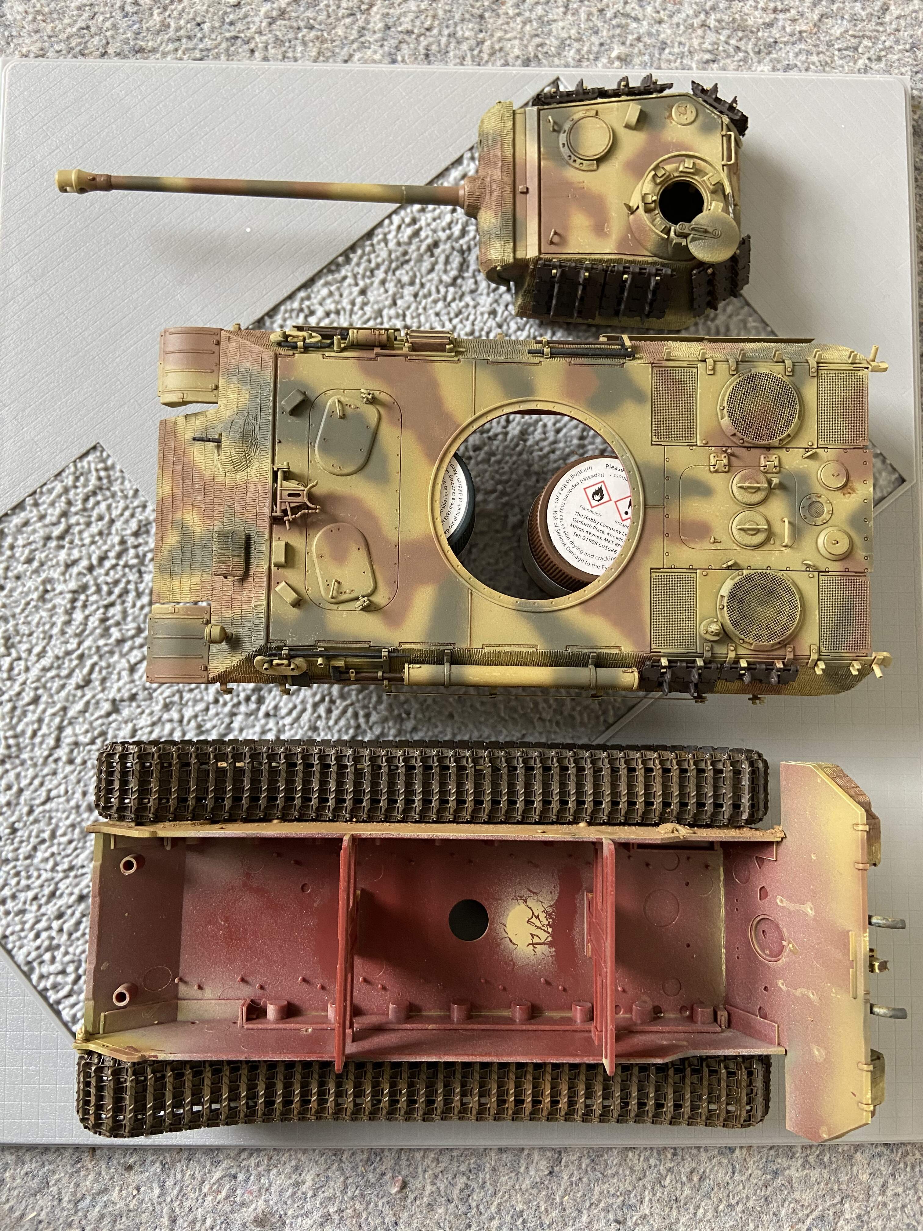

My new compressor turned up faster than I expected so have made steady progress the last couple of days. Decals, matt coat are on and the tracks have been painted and fitted. Closest it’s looked to a panther since I started painting!
Started work on the weathering, applying mud to the lower hull. Still a fair amount to do here before the upper hull can be fitted but happy with the progress so far.
Oh yes! Liking this! If you’ve put a dark wash on the Zimmerit, if you dry brush it with lightened camo colours it will really “pop”. It may not be super realistic but you can always tone it down with further washes or dusting.
Hi all, upper and lower are now together. Spent a bit of time weathering the tracks and lower hull sides but it’s not that clear in the photos. I’ve been using my iPhone so far but will look at taking decent photos with my DSLR when it’s finished.
Getting the upper and lower hull together was a little troublesome and has left a few areas needing some touching in. If I were to build another I wouldn’t do it this way again! Moving on to the rest of the weathering next.
