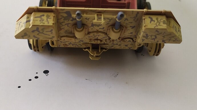

Hi, I started this one late 2022 / early 2023
Filters & Chipping, top hull & turret.
That’s a very interesting camo scheme! Looks good!
I didn’t like the schemes so I decided to get creative, I like the result.
I think I will add some branches, bush , maybe a base. I don’t know yet.
Still a lot to work on.
More chipping and some filters.
Worked a little on the tracks.

I started this kit late 2022, but then my bench got a little crowded but it looking good so far,
I need to work on the tools, spare tracks, side skirts.
And finish the tracks.

I’ve been working on this one for the last weeks.
Adding some tools, I still to work on the spare tracks, side skirts,spare wheel, more tools, cables,etc…
More work today
Weathering on the jerrycans, toolbox and side skirts
Side skirts, jerrycan, toolbox, MG42, and that’s it.
This one is done.
