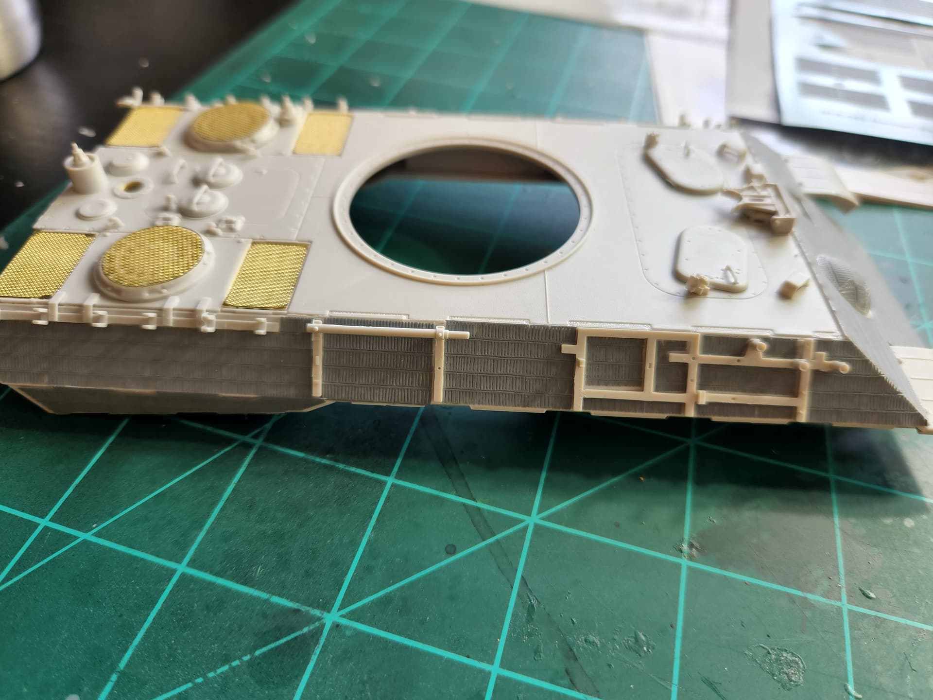

Well I finished the hull and I have to say that I am very happy with the Ming zimmerit decals.
That looks excellent. Have the kit and the decals so am watching your build closely. Truly inspirational stuff.
So happy with Meng’s Panther that I picked up a Jagdpanther, too.
