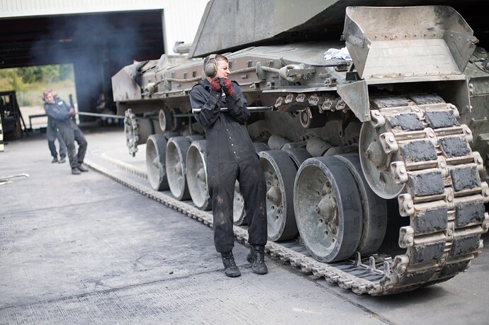

It depends on how much accuracy you want. The Challenger has a very different centre guide - a single prong in the centre of the tracklink:
The K9 has a double prong which is offset to the individual track centre, spanning between the tracks.
