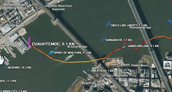

They backed out from the quay they were moored at and then for some reason they could not start going forward.

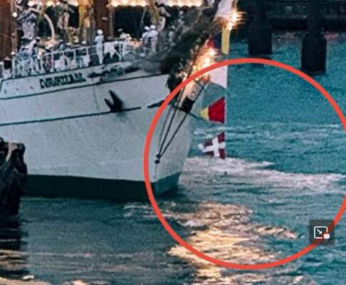

At this time they should be making way forward, down river, but the churned up water indicates
that their propeller is still going astern (watch video to see sequences):
A little bit later, having a fair bit of speed going astern:
A decent âbow waveâ at the rudder going astern.
