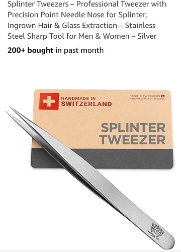

For Actual Micro Tweezers .I have and use them and they are great when there is a need. ![]()
Be forewarned, the points are VERY sharp.
