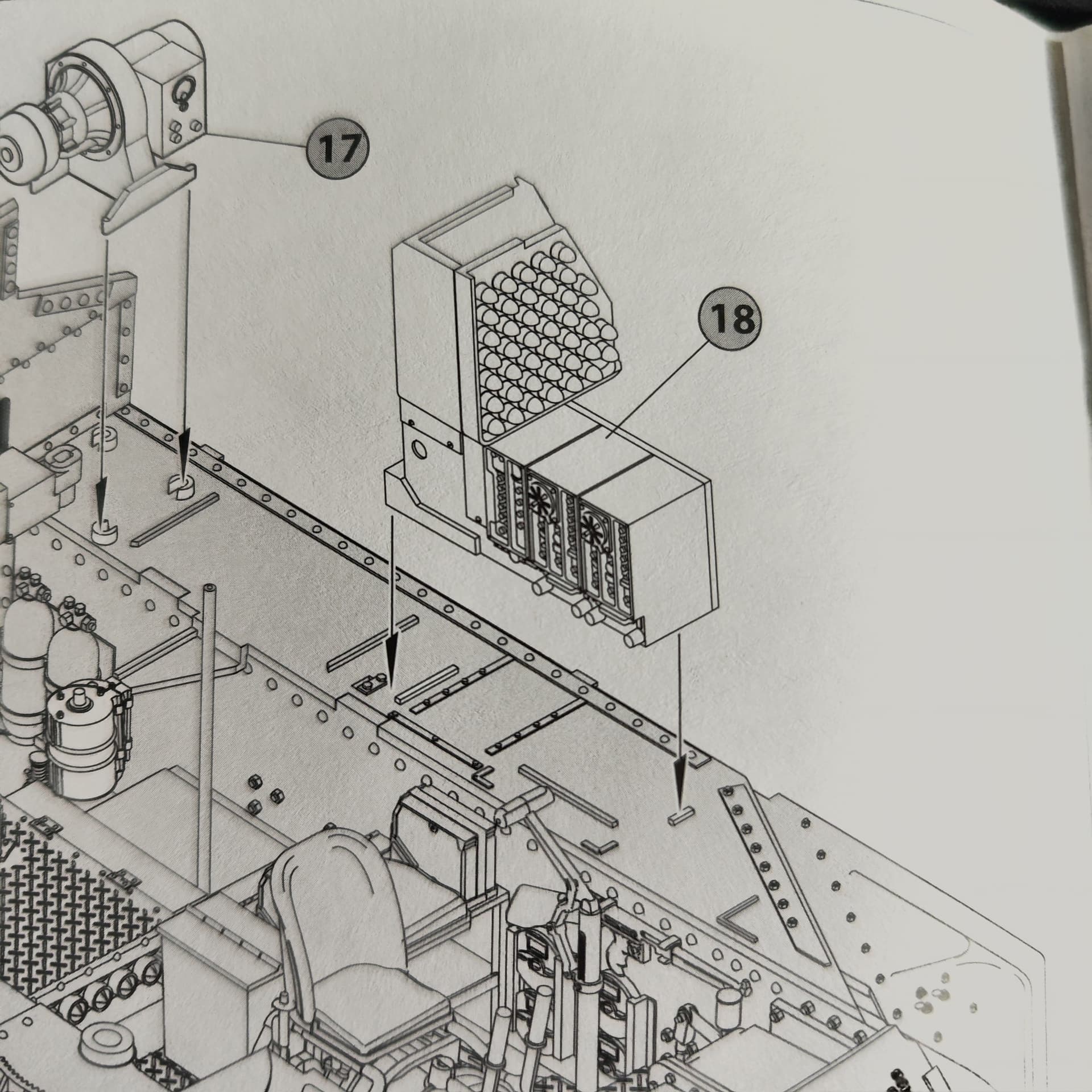

What is it, and maybe more important: what are the colours?
It is a device which sits on the port side of the tank, next to the driver, in the sponson, below an ammo rack.
It might be a radio, but I have not been able to confirm this, let alone find an image of the device.?
Maybe any of you have more information?

Yep, it’s the SCR-508 radio in the kit. The set in the photo:
is the British radio, I think its a MK 9.

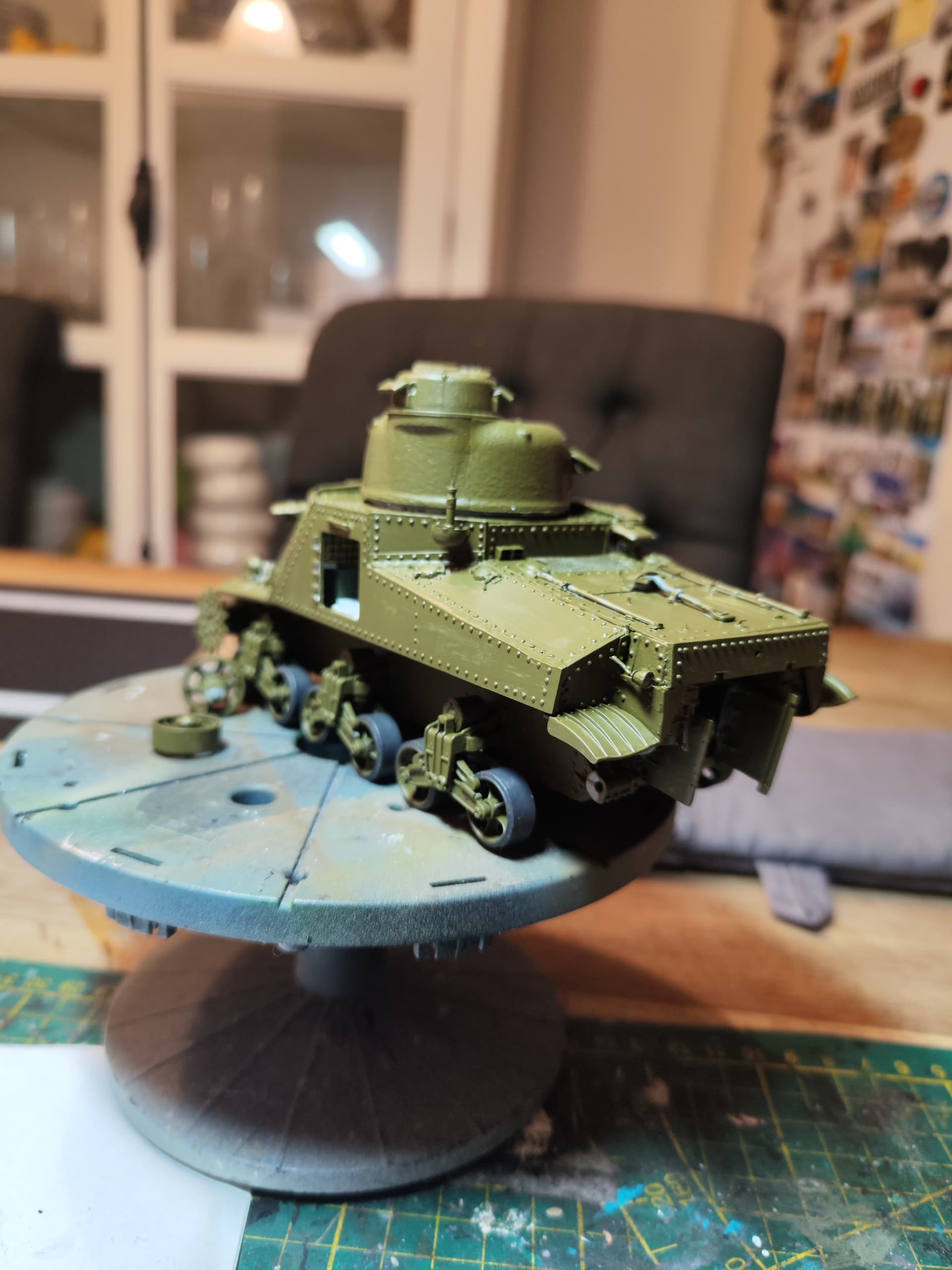

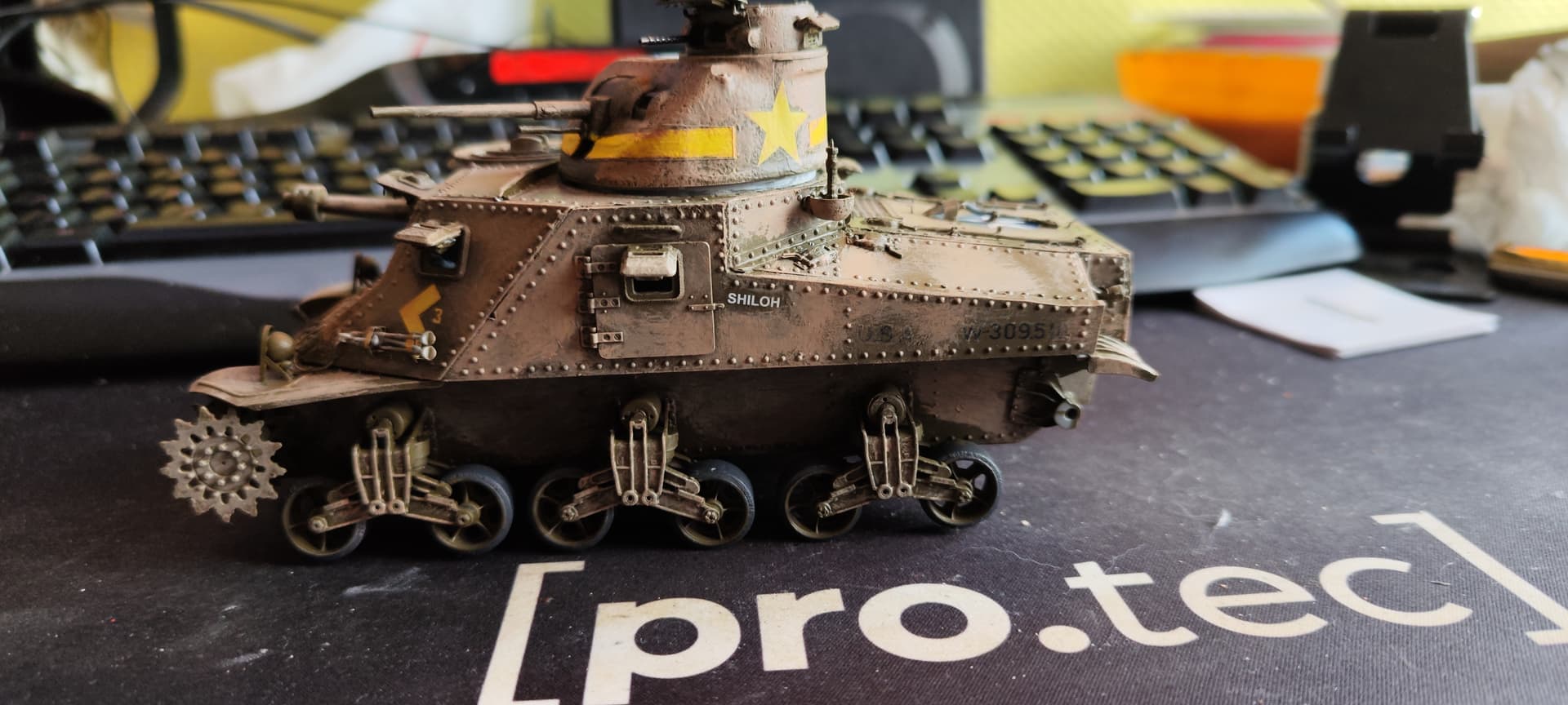

Well the build phase has been mostly finished. The idlers will be glued on when I will also mount the tracks, so I can tension them with the idlers. Base coat is also on. I will have it with a sand coloured camouflage sprayed on. After that weathering and the painting of tools etc. Enough work to do
That is what I did ![]()

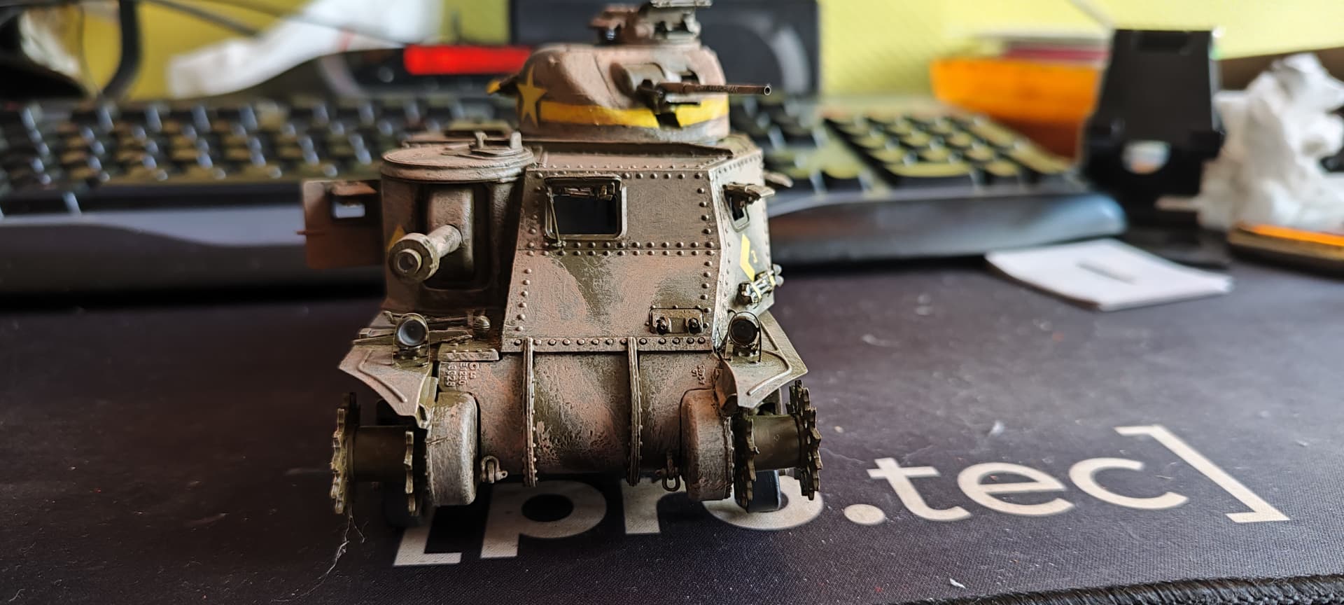

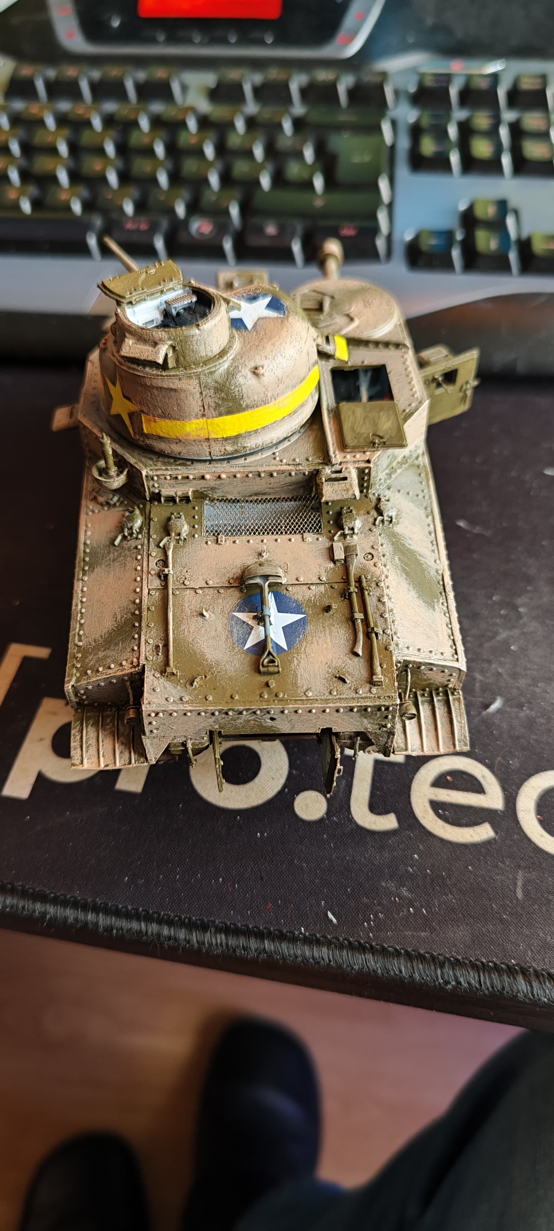

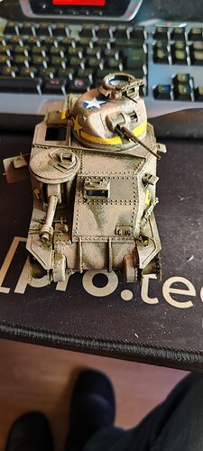

The decals are on… I discovered that the yellow lines on the the turret needed to be painted… Nice: getting yellow on olive drab without showing the base colour through…
After that came the sand coloured camouflage paint on.
On the instructions it looks like it was applied by brush or broom, so the airbrush could stay in its box.
I used dry brush paint to get the wanted effect…

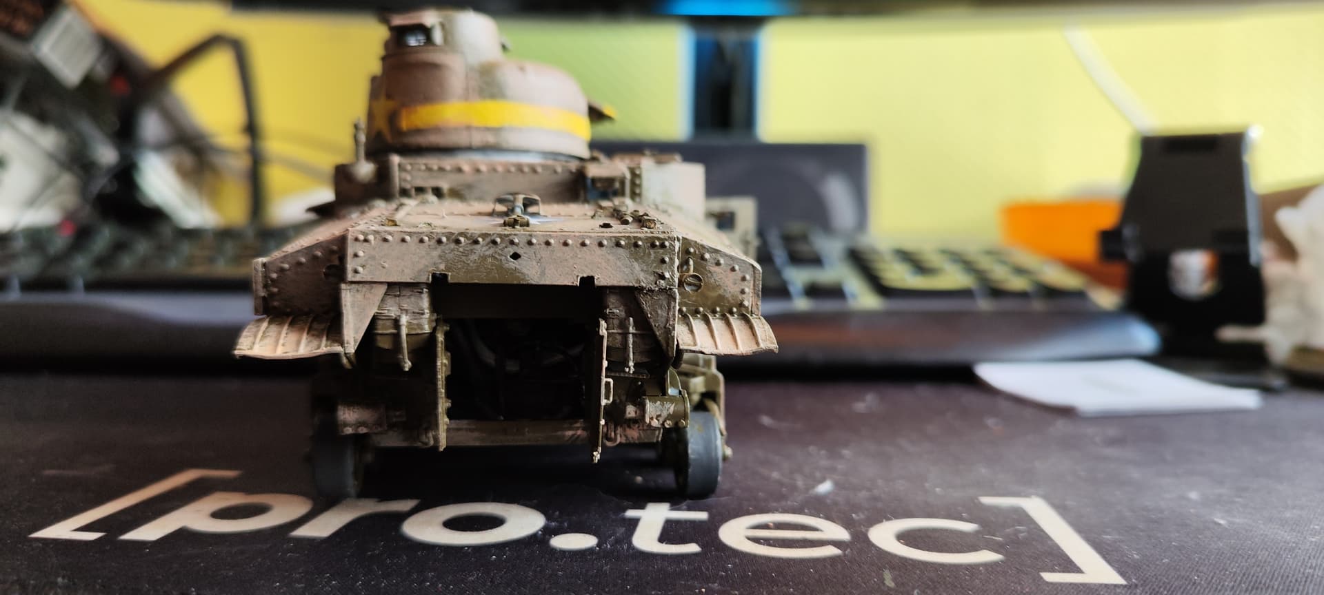

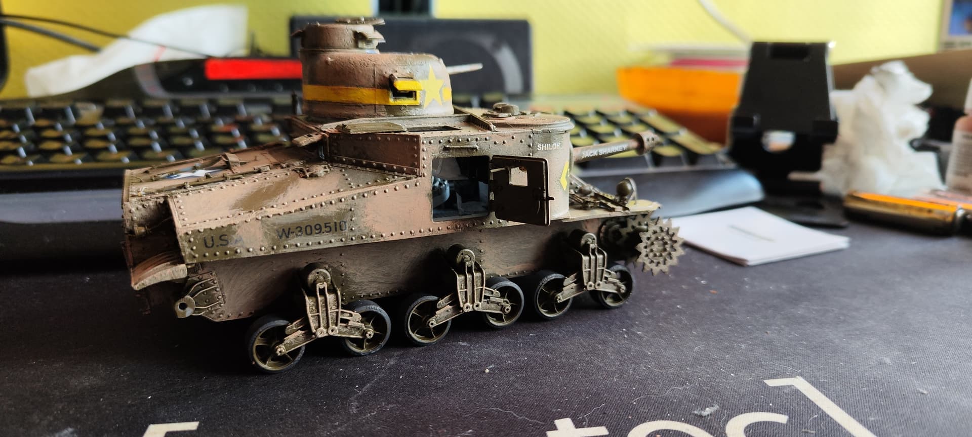

Now for detail painting and adding the tow cable…
Nice work Erwin , lookin good !!!

Looks great. Love the faded look as well.
Coming along nicely Erwin. ![]()
Thanks @Johnnych01 and @Tank_1812 . Enough work remains to be done, yet the end is in sight…
I managed to screw up one of the tracks yesterday… So much that there are not enough spare links. That means I will have to resort to AM tracks. These T-41 tracks are only available from Masterclub, which is not available overhere. BNA has them in pre-order… But how long will that take?
