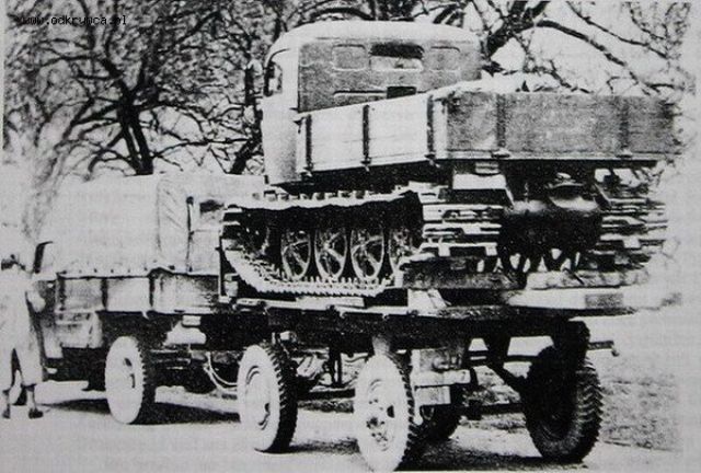

Variant :
From this thread
https://forum.odkrywca.pl/topic/568589-raupenschlepper-ost–steyr-rso–cz%C4%99%C5%9B%C4%87-ii/
The top photo looks like some kind of trials/prototype version.
Happy smiling faces, uniforms and civilians, reg-nr looks civilian
Indeed…It shows trials of the third preproduction vehicle.
