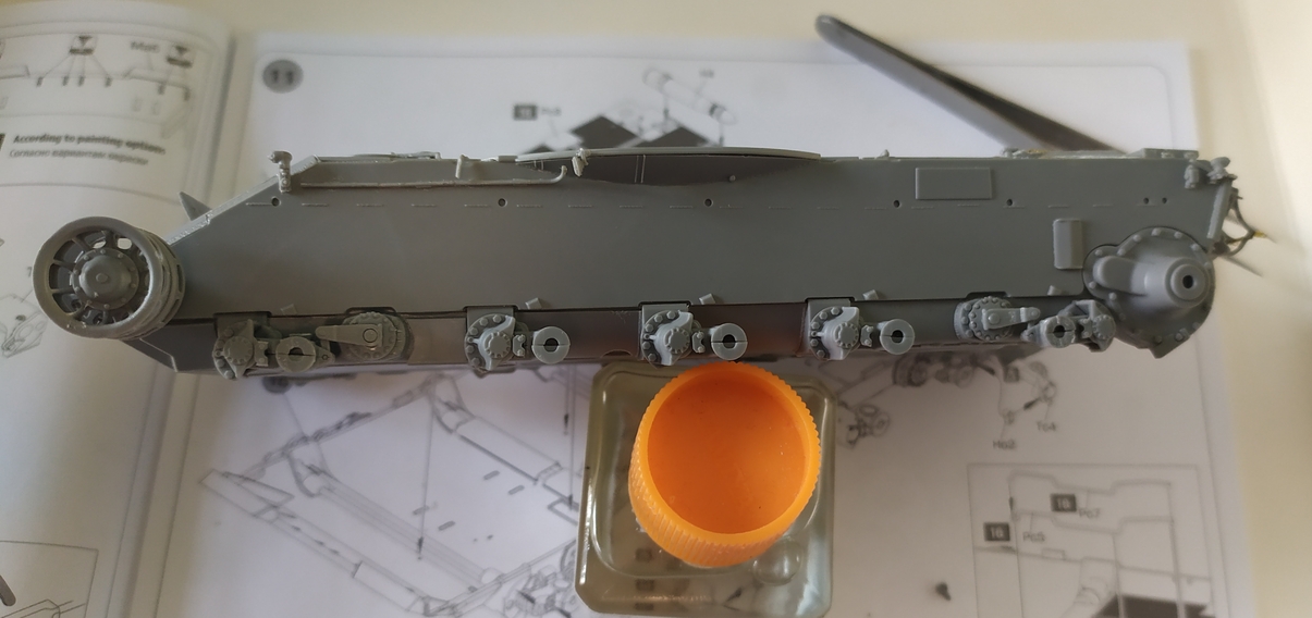

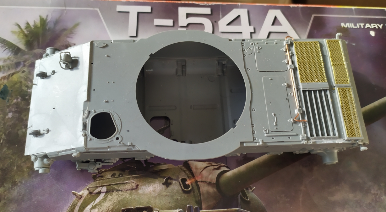

Hi, I have another one on the bench, worked on the hull.
I won’t do the interior on this one.
Some work done yesterday and today,
I didn’t work on the PE little bits, I will leave that for later.
Working on the fenders
There is a ton of PE to add on the engine deck.

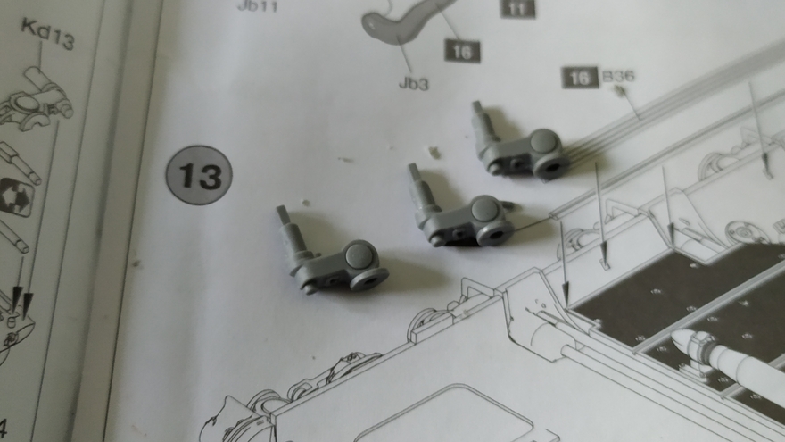

To keep some of my sanity , I only added these 4.

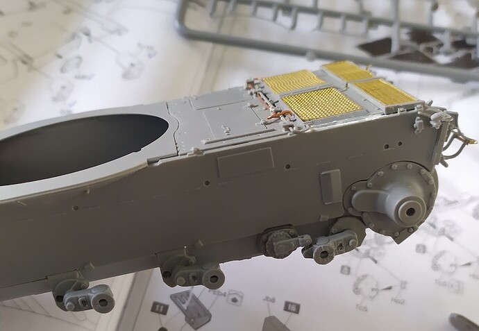

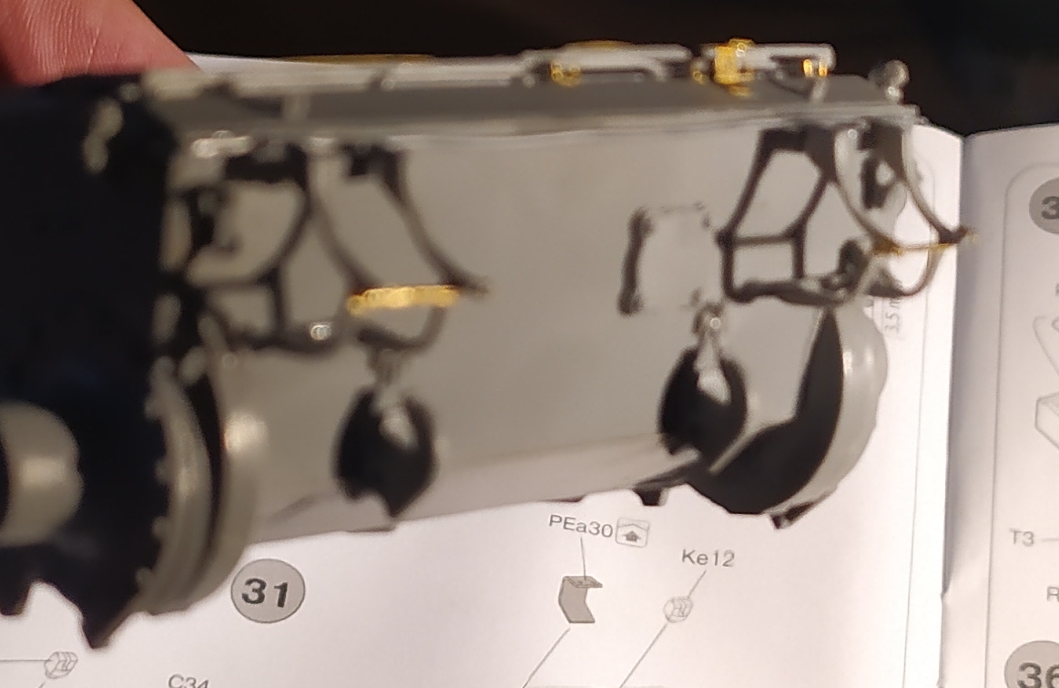

Yesterday I added these :

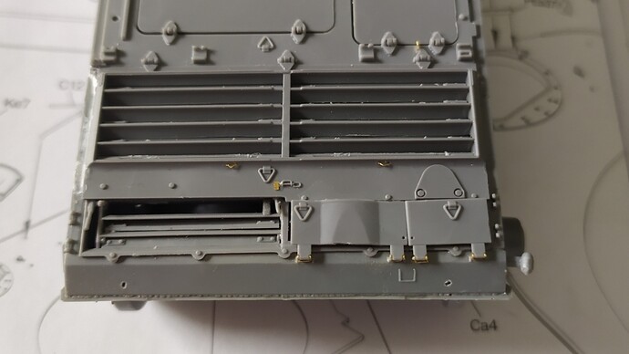

More work on the engine deck, more PE… still a lot to work to do here.
More details added.
This is a very detailed and difficult kit, very small thin parts.

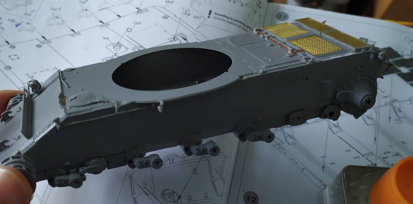

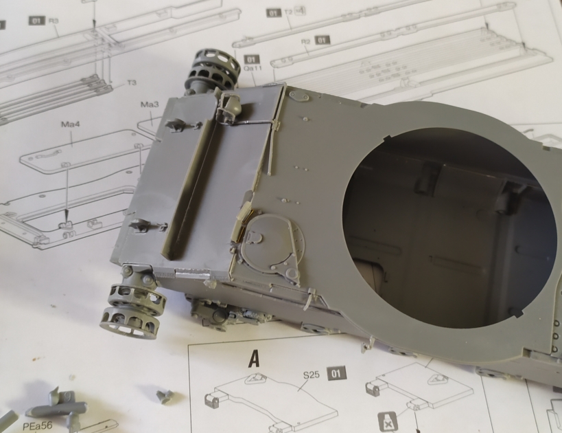

This one has been away from the bench for some weeks.

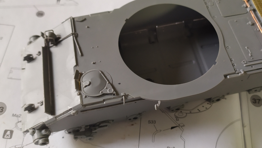

Adding details to the side and rear plates.

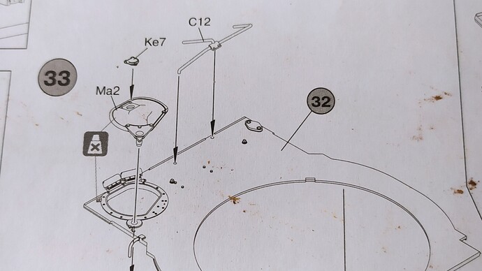

I forgot to make some holes along the way, I’ll manage…

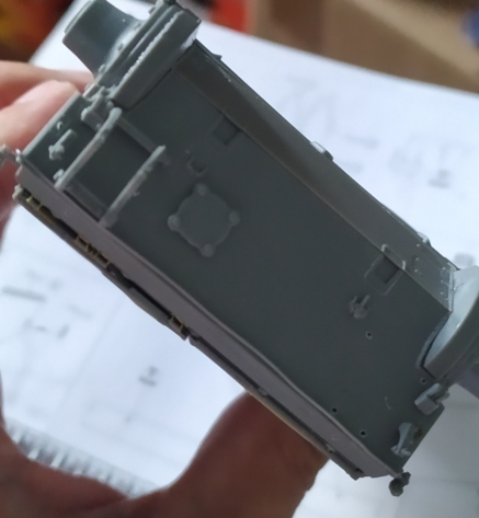

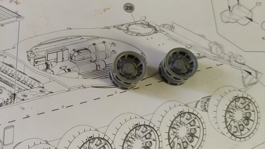

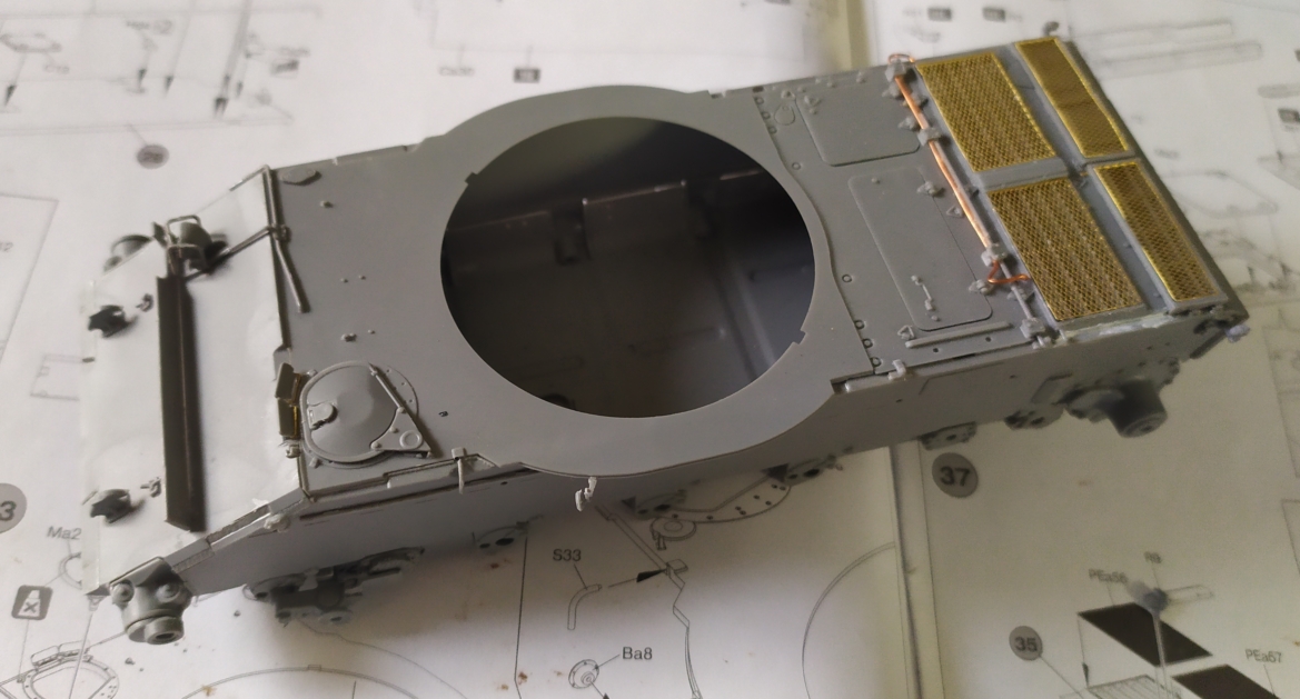

Been working on the fender,
Thanks for the preview of my future when I will tackle this kit.
:smiley: :wave:
Watch it for the thin plastic parts, you can see on my kit, near the engine deck, I had to scratch with wire, while cleaning it up it broke into 3 or 4 parts…
Anyway I’ll keep posting my progress here.

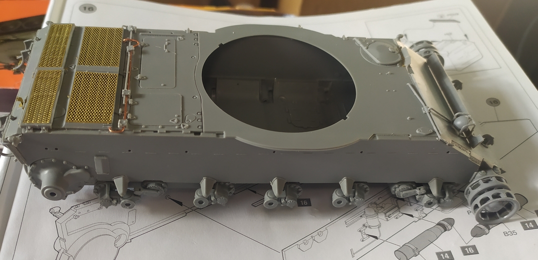

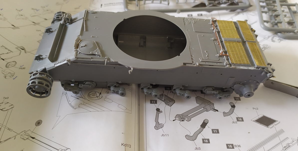

Long session working on the T-54 A,
and the rear deck :

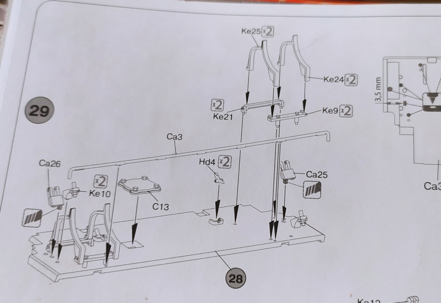

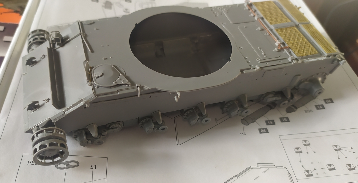

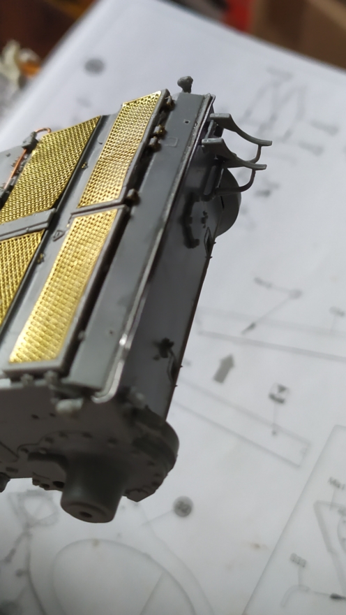

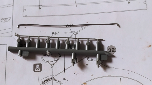

Ca3 part is very,very fragile, cutting and cleaning it broke nearly instantly and I was very very gentle… anyway replaced it with some wire.

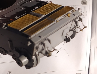

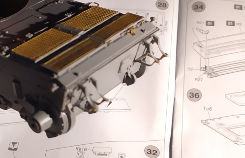

After a little over 3 hours, I got the rear deck done.
Just need to check the engine deck, front and sides if something is needed, but I can see a Primer Session very soon.
