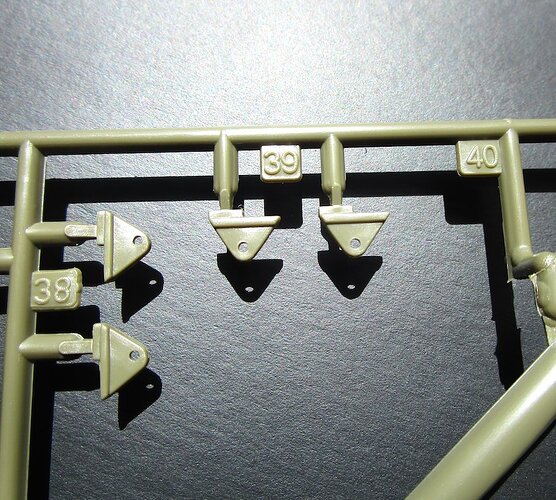

Michael, did you lose both H39? Could you make a copy if you still have one of them?

I have this part but cannot part with it. Please consider @Uncle-Heavy suggestion of making a copy of the other H39 in the kit, if you haven’t lost that one as well.

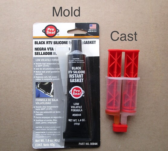

They are flat on one side so a single part flat mold can be made using gasket making material. Brush it on no thicker than 1/8" at a time. Let that layer cure then another layer until you have a mold with the thickness you can work with. Then cast a new part with epoxy adhesive. Both of these products are inexpensive and available.
Unfortunately I just pushed on and kept building (I prebuild models at work) and used the other one already I should have thought about that.

Hell, bring the the opposite part on the 26th and I’ll make your missing part while you wait. I’m thinking some .040 and a small length of half round, which I have in several sizes.
