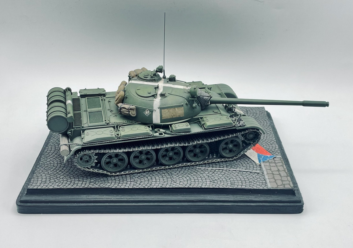

I do so like that T55 in Operation Danube guise. Excellent!
The others are fins too but that one stands out to me.

Thanks Brian! I’m going to do a few more Operation Danube subjects from the Soviet AFV kits in my stash. The white markings do give a distinctive appearance. More so than just the usual Cold War Soviet Green with ID numbers and possibly a cryptic unit symbol…

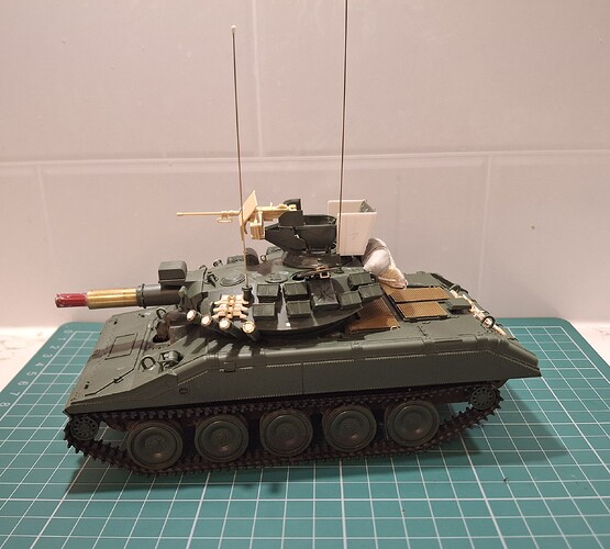

That Robin, is exactly my modus operandi! Sad to say of course. It sums up nicely what happened with a Sheridan I bought what? Twenty years ago; it was the Academy kit, much reviled since, but back then, an advancement on the ancient Tamiya kit (I never knew the Jaguar resin version) so what was not to like? I wanted to do it justice and bought some etch. That was where the problems started; etch is difficult (as we all know).
I was ploughing along quite happily until the first installment of etch. then the second one, then the third. Then I thought, this is a bit dull, why not buy/look at another kit, and that was that for the poor old Sheridan, until late last week, when a foray to the attic to check on my stash of Commander Models’ MBT-70s led to the serendipitous find of the Sheridan.
Whilst lamenting bitterly over the piles of warped resin that was now the two MBT-70s - due to the temperatures raised this last summer (though hopefully fixable) - I gave the Sheridan a quick once-over. By now, I was more than aware of the issues with the kit, as in the 2 decades gap, much has been identified, but you know, I hadn’t made too bad a job of it, and I was further along than I’d thought; I’d fixed the grossly over-sized main armament; the etch was still looking challengingly at me, albeit now tarnished a fair bit, but still useable, and I thought, “I’d always liked the Sheridan. Sure, it may not withstand much scrutiny these days, but sod it; I’m going to finish it”. And that’s just about what I’ve done.
Never mind the other projects that are screaming to me to finish them, the Sheridan has occupied me for around 6 days and it’s actually been great fun!
(Searchlight still being worked on)
