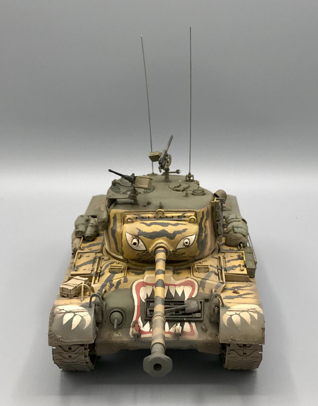

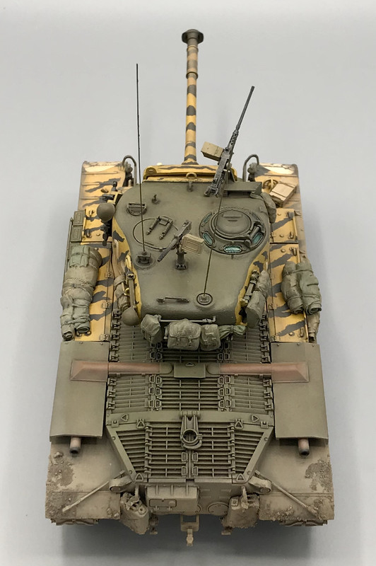

I like Mission Models paints. But I will add that they are not very good for really thinning down for marbling over a black base. Never had a problem with tip drying, and I haven’t tried it with their poly additive, only their thinner.
I used their OD 319 over a black base on this build
And their FS 33070 over a black base on this build
