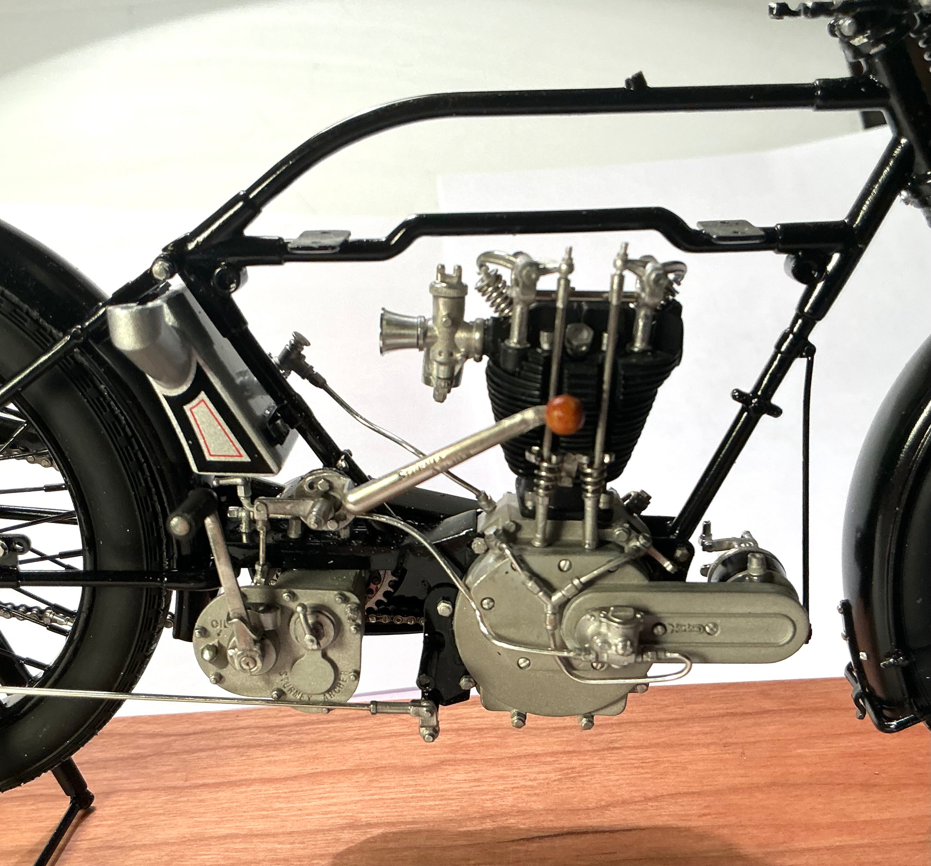

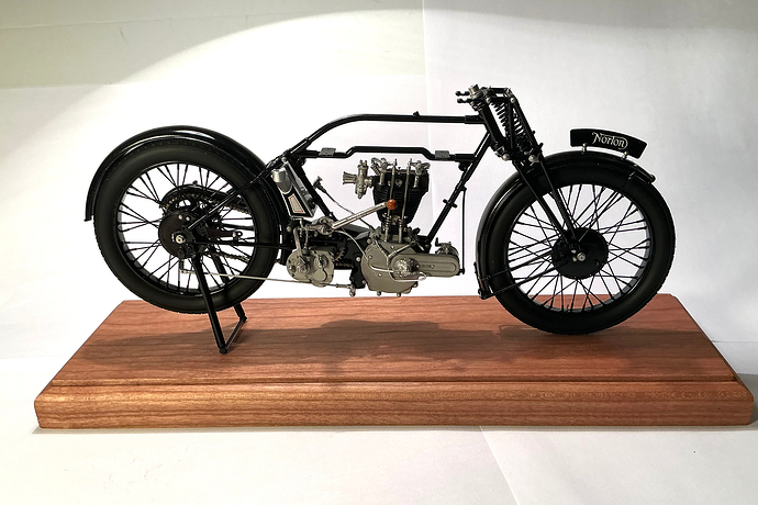

Here is a shot of the chains and clutch / primary drive before all is hidden by the primary chain case .
Masterful!
Your bike builds are just increadible, the precision, the finish…

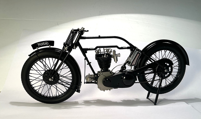

Progress milestone - front end joined up with chassis - primary chain case and chain guard installed.
External oil lines installed -
Next up will be adding handlebars and routing cables , then fuel tank .

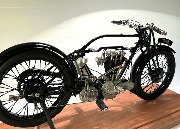

Base made of Cherry - rear brake and hand gear change mechanisms added .
Another museum-quality build in the making by you Richard, just exquisite. I’ve no idea how much is due to the quality of the kit, and how much is due to you. My inclination is I’d have botched it long before now so I’m betting it’s at least 75% you. A request – I get it’s 1:9 scale but could you include something that nails the scale in a photo, like a finger or jar of glue?
Thank you for the compliments Tim . Much of the credit belongs to Modern Factory Hiro. As this is their newest bike kit they have made some improvements. In particular, the center stand . The vertical parts are cast in two pieces each with photo etch reinforced pieces in between. The white metal itself was a weak point in previous kits . As requested , here is a shot with a glue bottle to give an idea of size -

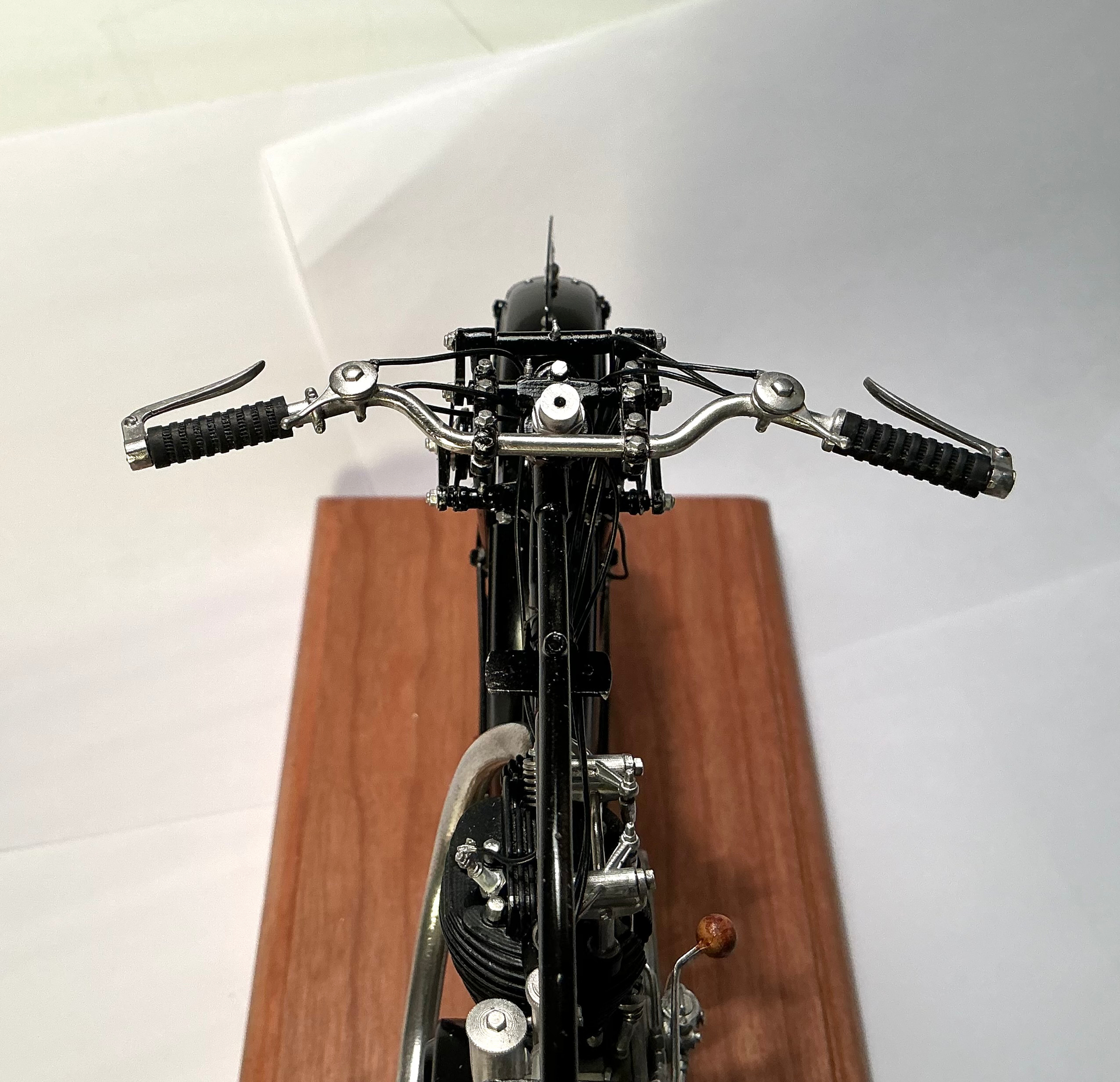

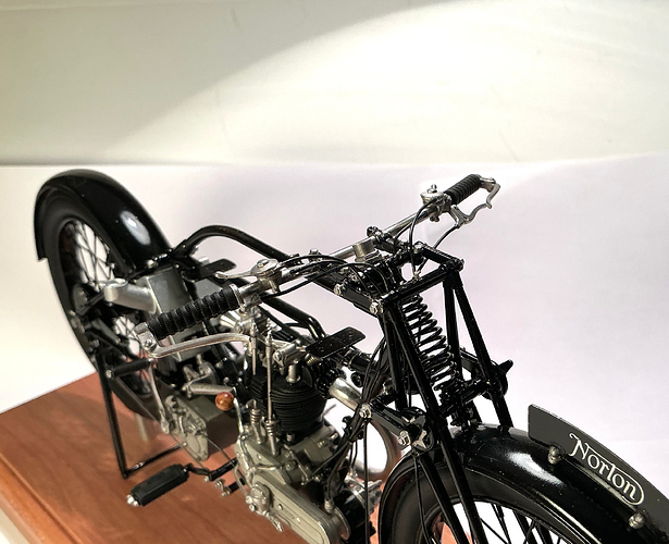

… and the recently completed handlebars …
Many thanks, funny how it’s always a slight surprise - imagined either smaller or larger! :+1:

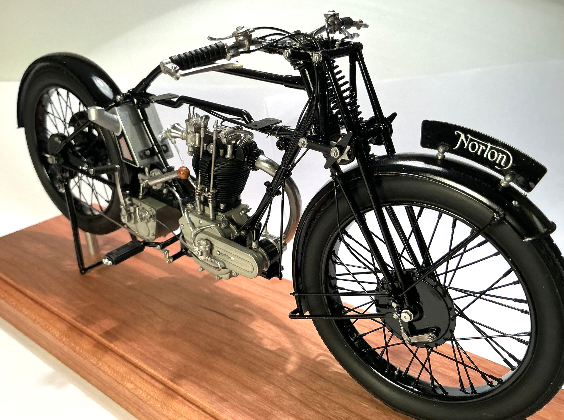

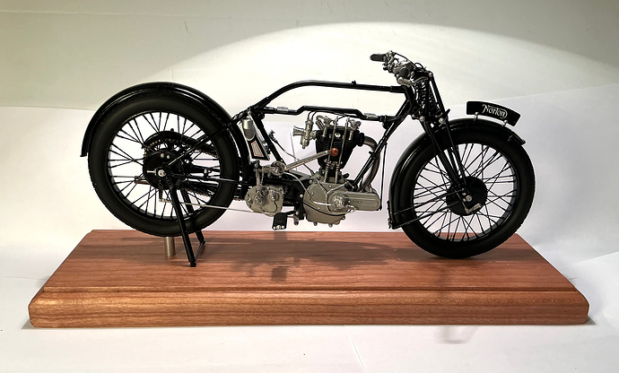

All cables , wires routed and installed. Throttle and choke from carb to twist grip and choke lever . Ignition advance from magneto to handlebar lever , high tension lead from magneto to spark plug, valve lifter ( compression release) from lever at timing chest to handlebar lever. Clutch cable from gearbox to handlebar lever and front brake cable from brake drum to handlebar lever.
And exhaust installed…
Up next - fuel tank.
Thanks for looking !
Cheers - RT

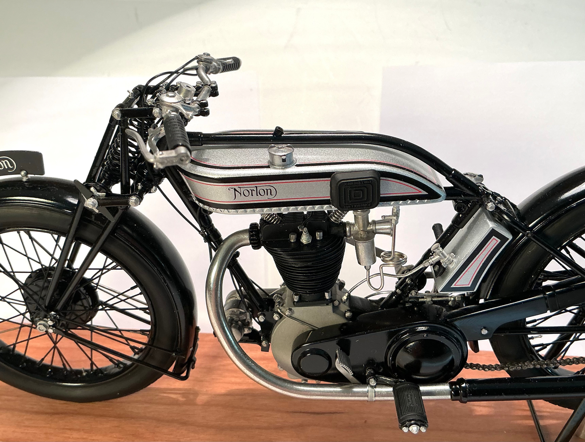

Fuel tank installation is a milestone of sorts on motorcycle builds and so we are at that point.

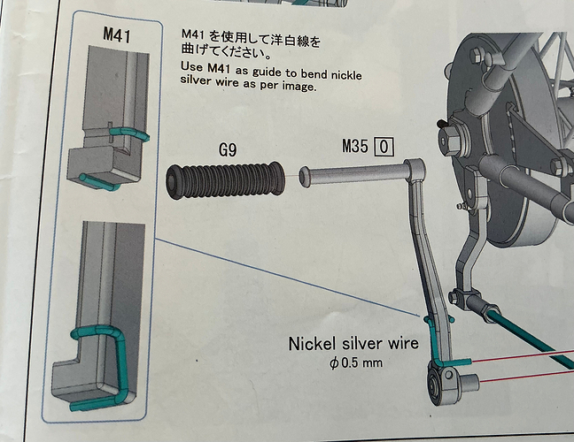

MFH supply you with fixtures for bending wire to size and shape for the kickstart spring and the fuel line from tank to carb.
Fuel tank and oil tank filler caps have been added.
More to come - thanks for looking ! Cheers
