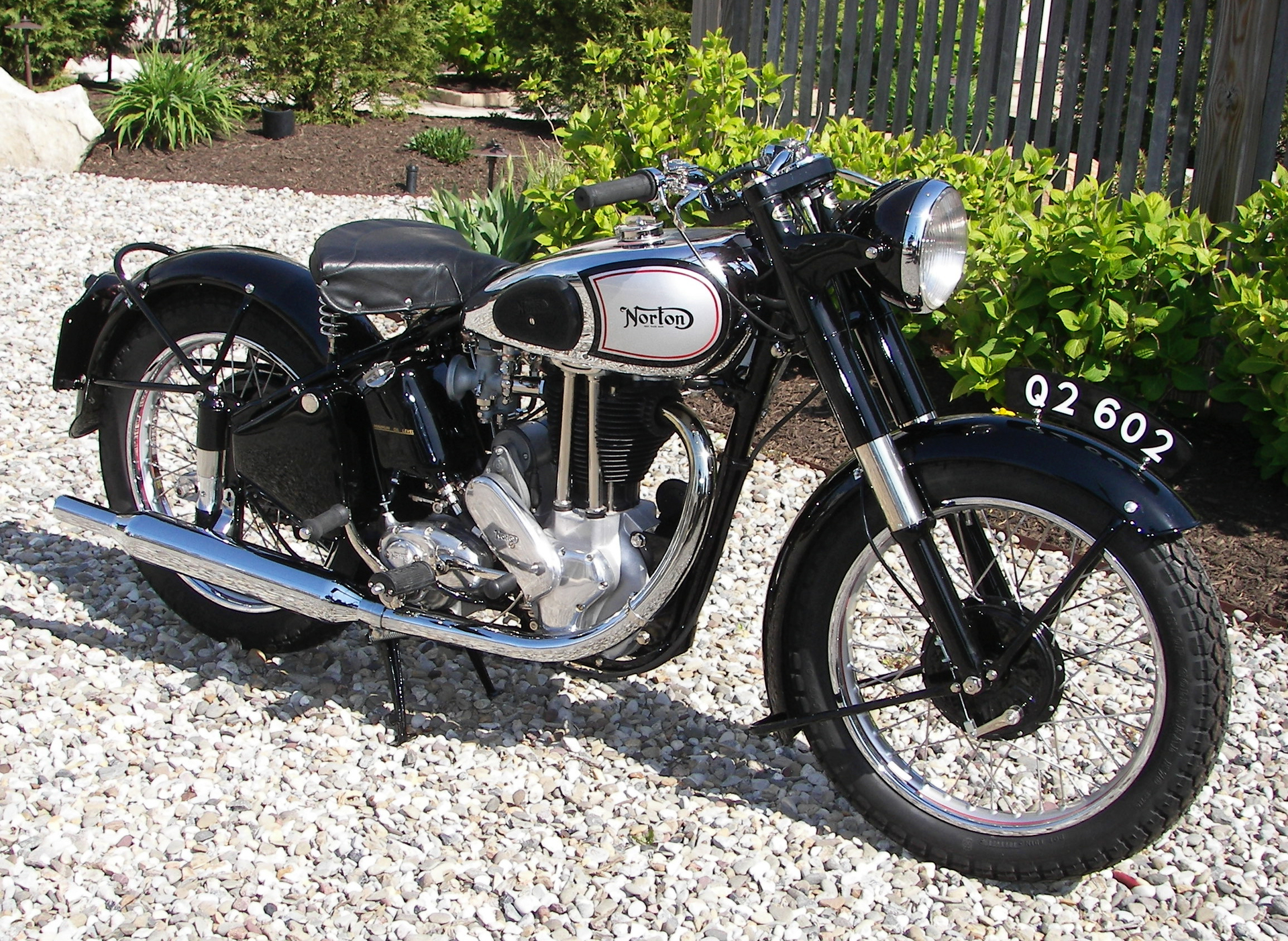

This time we have a Norton from their flat tanker era - this being a 1927 model year . The Model 18 was a 500cc four stroke OHV single which carried on in various forms throughout Norton’s production until the 1960’s . Here is what it evolved to by 1950 - my own ES 2 .

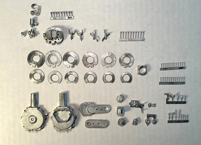

I’ve made a start on the engine by cleaning up the castings - approximately 90 pieces and drilling various holes - 80 of them at this point. This is my fourth MFH kit and I started using my Dremel to drill rather than doing it by hand with a pin vise. Works well but the problem is the speed control. This my third Dremel and all of them lose the lower speed capacity when they warm up . Come on Dremel - fix this .
Here is the progress so far -
Here we have the crankcase and timing chest , timing cover with magneto drive cover , magneto, spark plug , tappets, valve guides , cylinder fins , cylinder base , cylinder head , rocker towers , rockers , Amal remote float carburetor and various bolts , screws. All are now ready for a soak in acetone to remove any oils . This is one of the advantages of working in metal - don’t try this with plastic kits ! !
Not shown in this picture are the pushrods and their end fittings and miniature valve guides , springs and keepers , all of which are supplied by MFH .

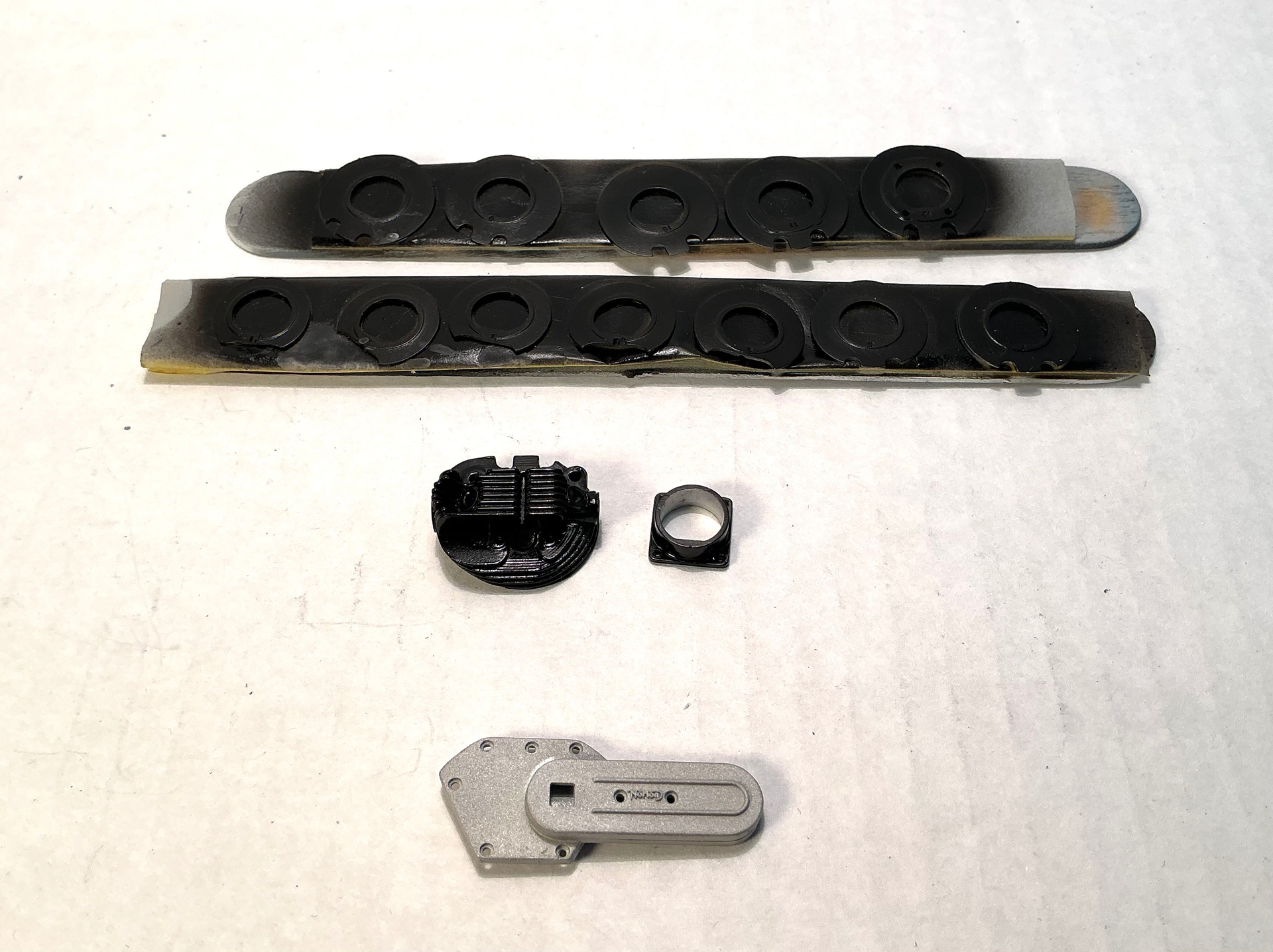

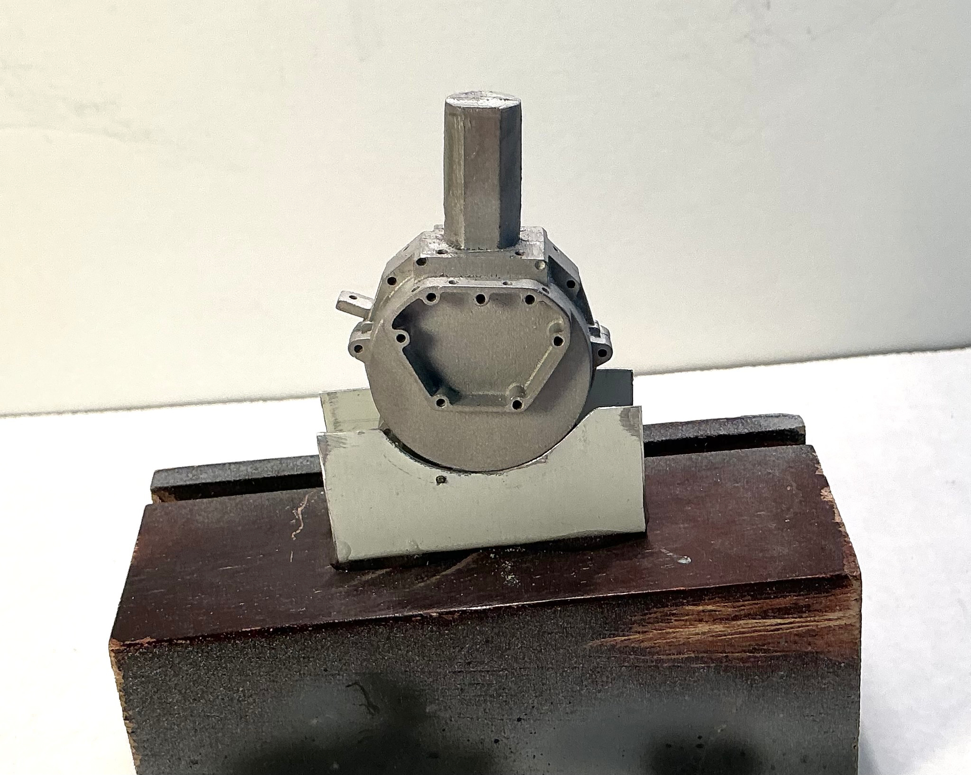

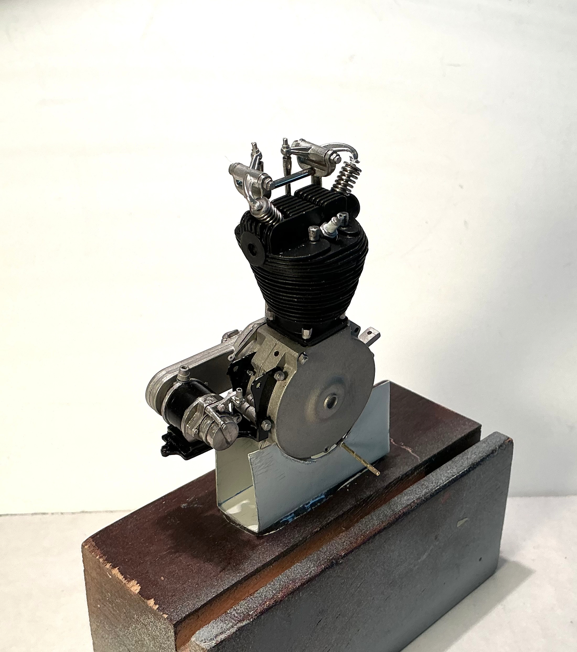

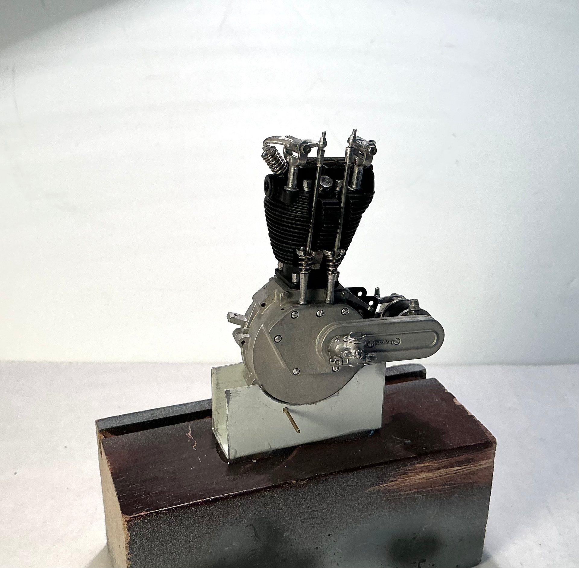

Thanks all for the compliments ! A bit of progress to report - crankcase and timing chest and cover assembled and soda blasted - quick and dirty assembly stand made up of flashing…
Cylinder fins , base and head painted -
Cylinder base , fins and head assembled…

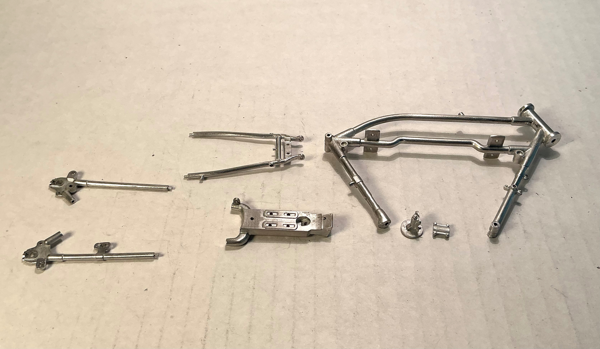

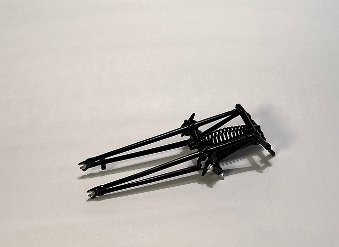

Main frame ( chassis) components cleaned up , holes drilled and ready for assembly..
Next up will be assembled chassis/ paint and pairing with engine.

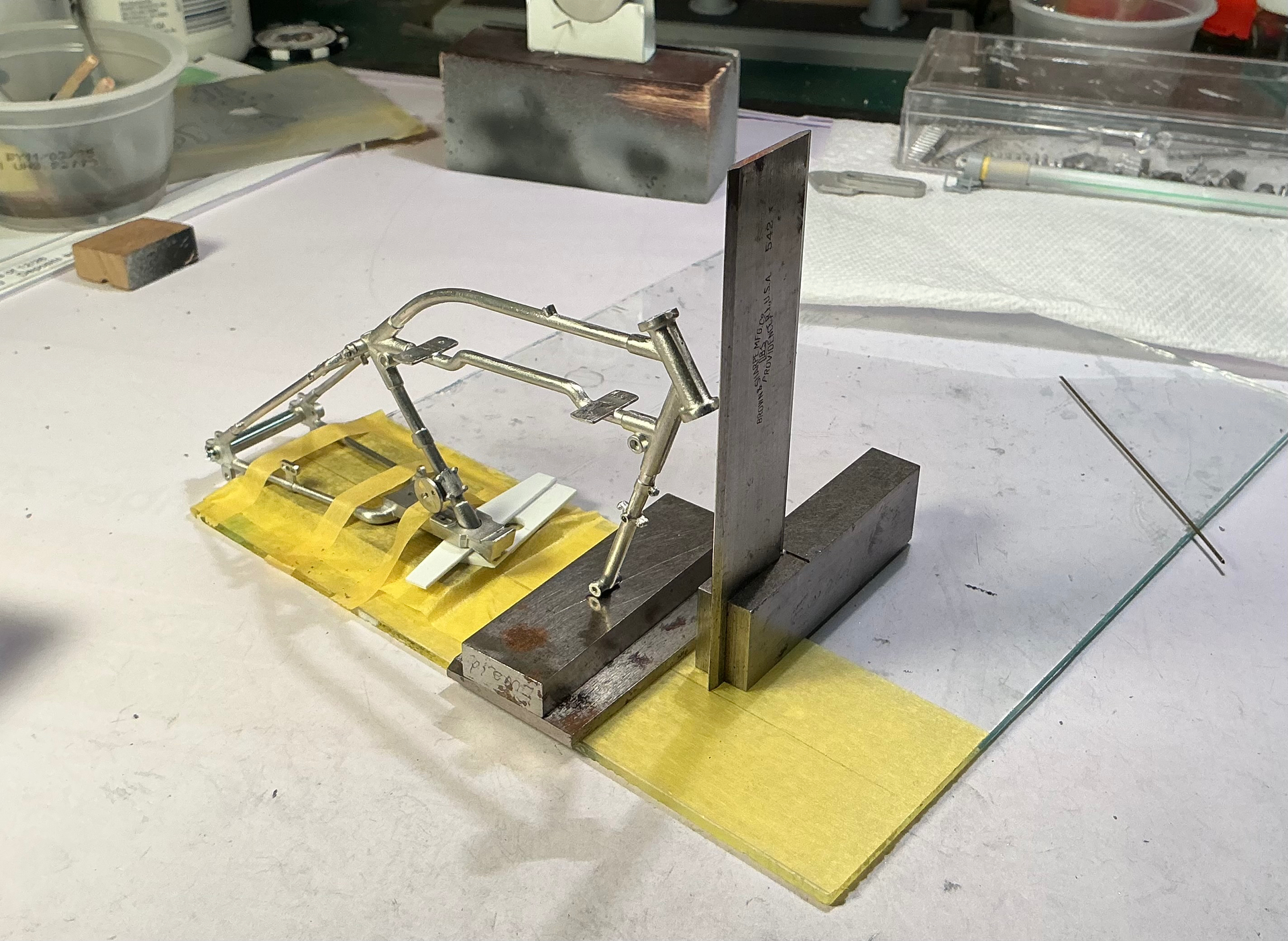

Frame assembled on the glass plate in an effort to keep all square -

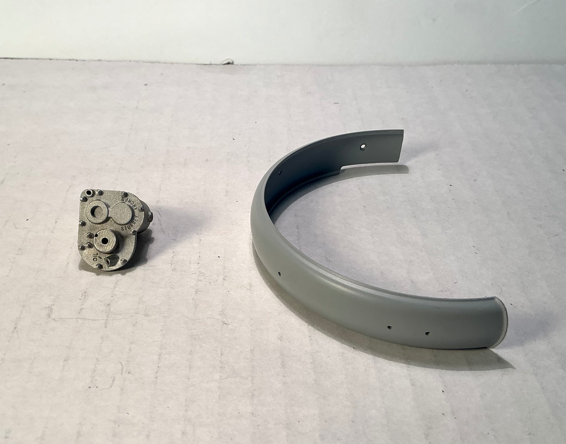

Gearbox built and rear fender in primer -
Engine largely done - really a kit in itself.

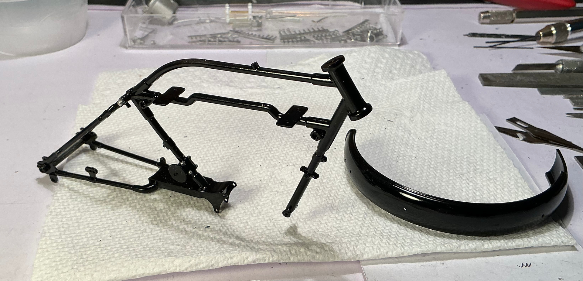

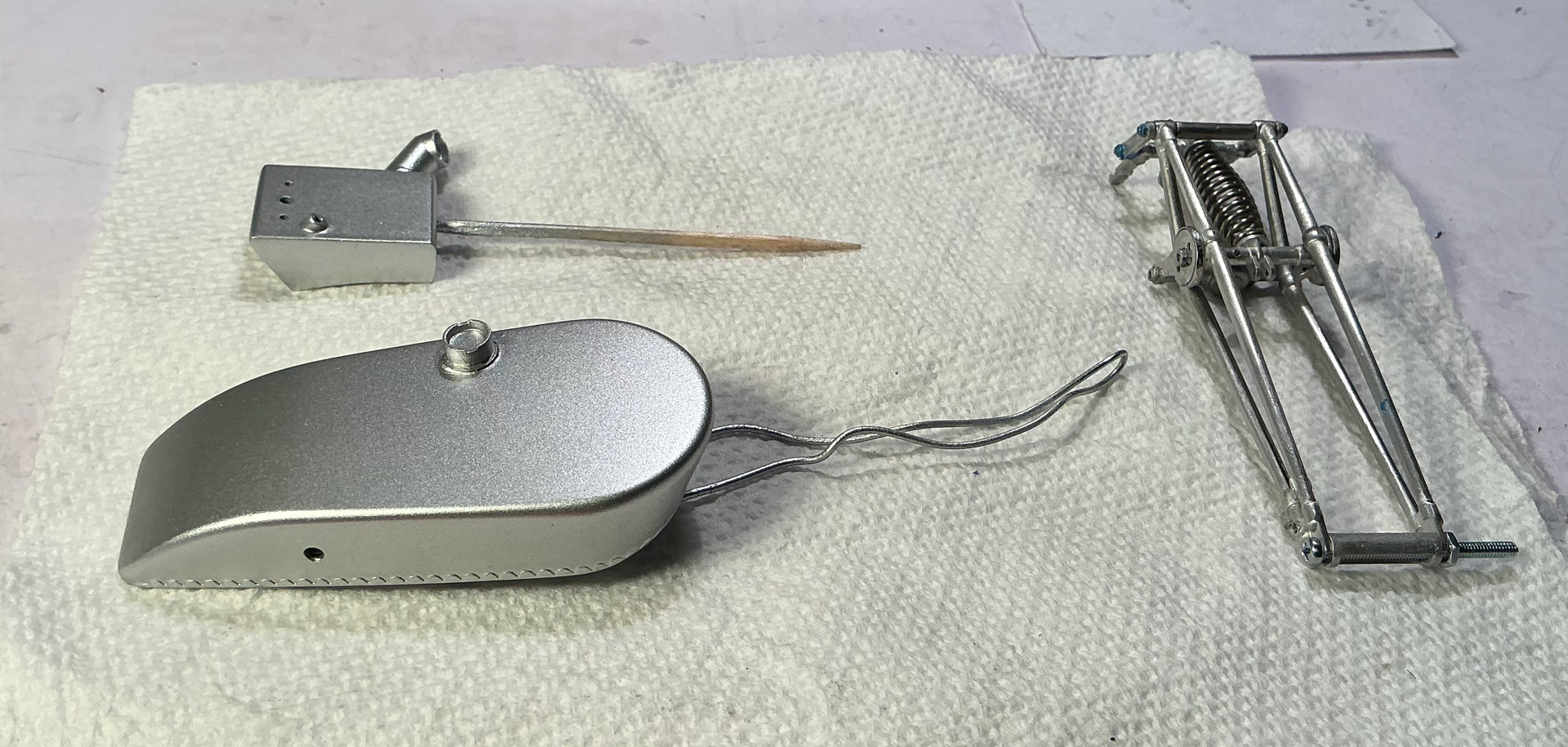

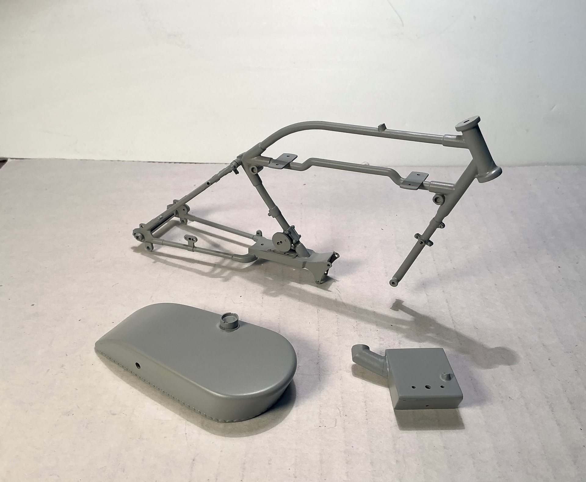

Frame and rear fender ( mudguard ) in gloss black - Tamiya gloss black / Gunze leveling thinner.
Fuel tank and oil tank in two coats Tamiya Chrome Silver / Gunze leveling thinner. Forks built .

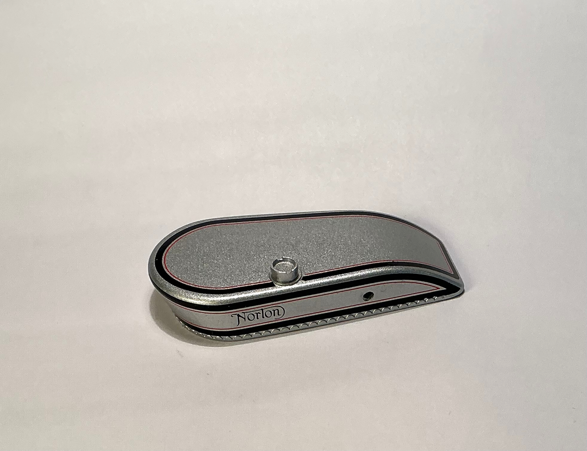

Fuel tank and oil tank painted , decaled and clear coated. The metal flakes on the fuel tank do not look that large - something in the photography makes them appear that way .

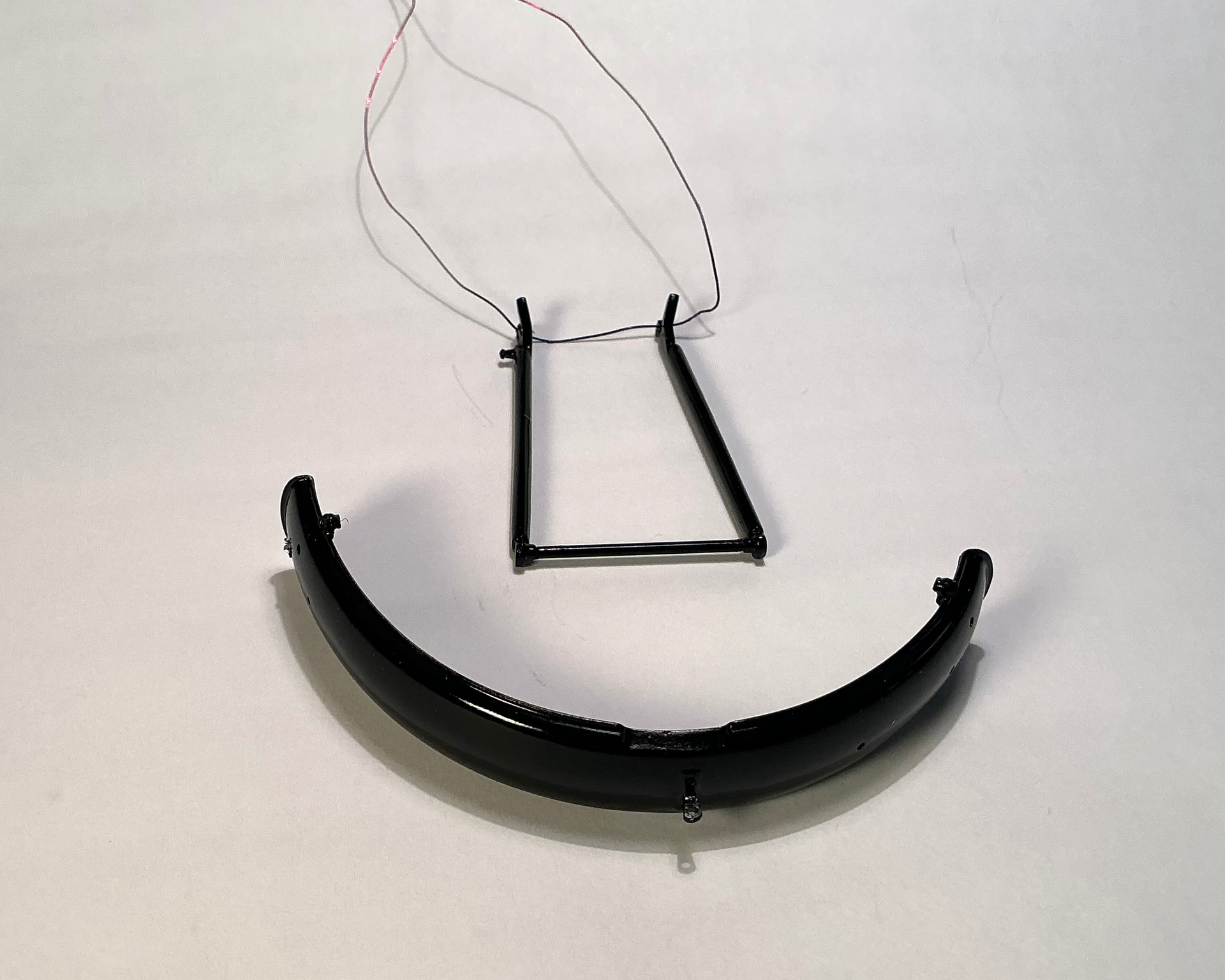

and front mudguard and center stand -

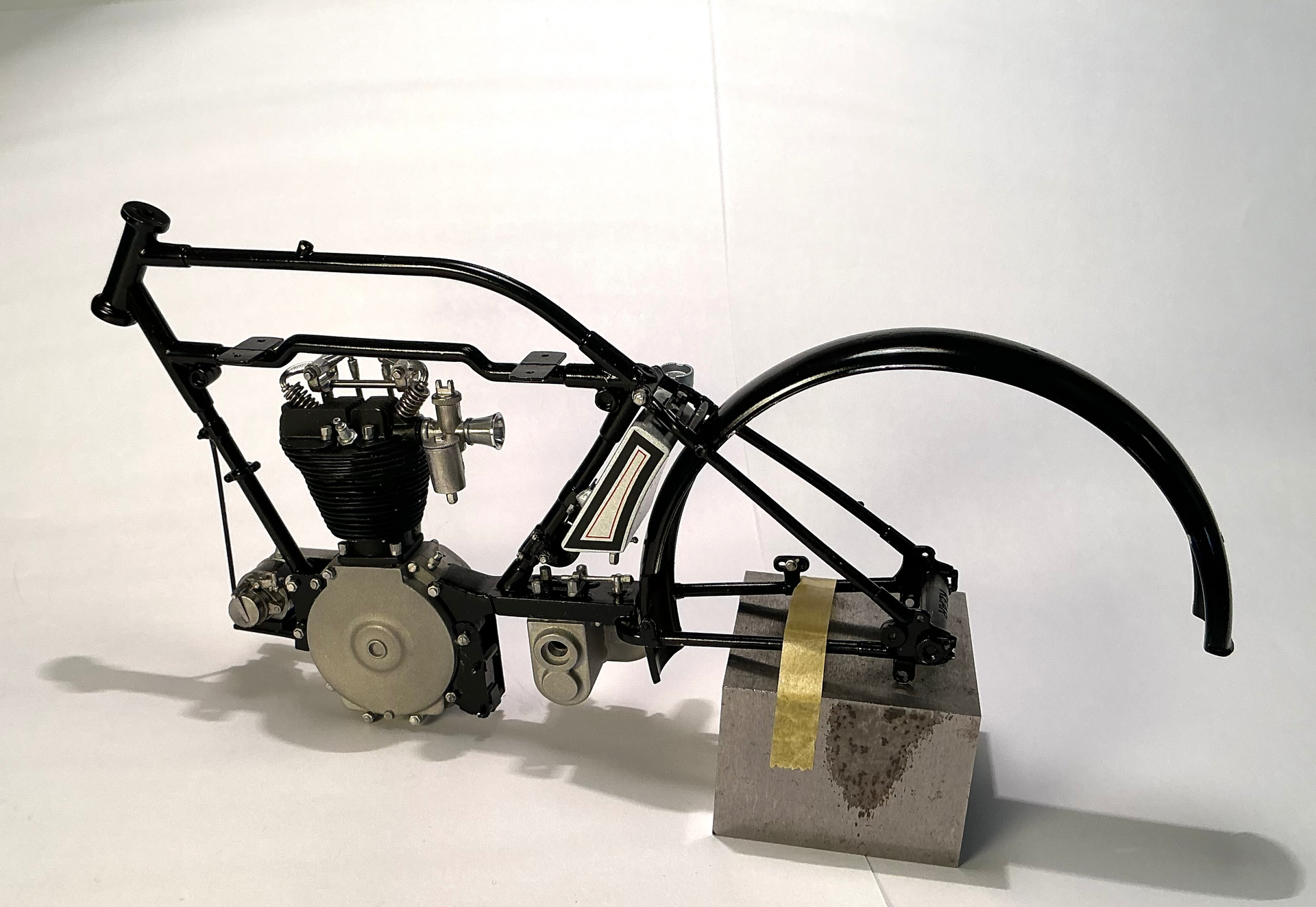

Frame with engine , gearbox , oil tank and rear mud guard .
MFH even include rubber pads for where the oil tank bolts up !

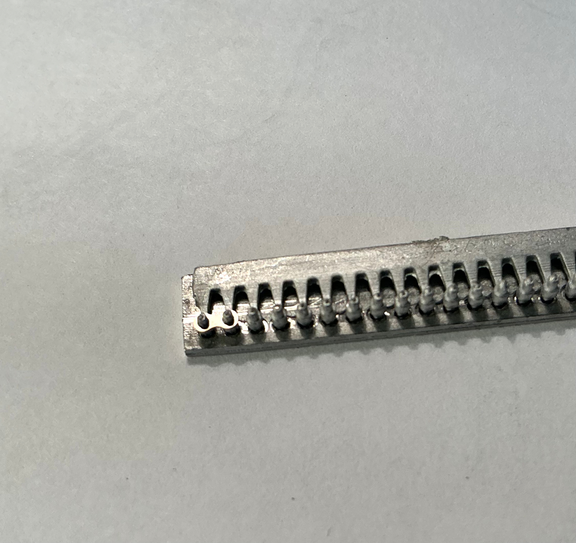

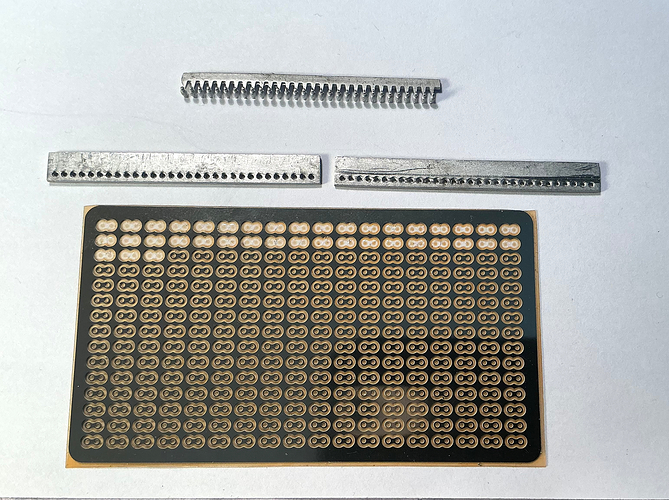

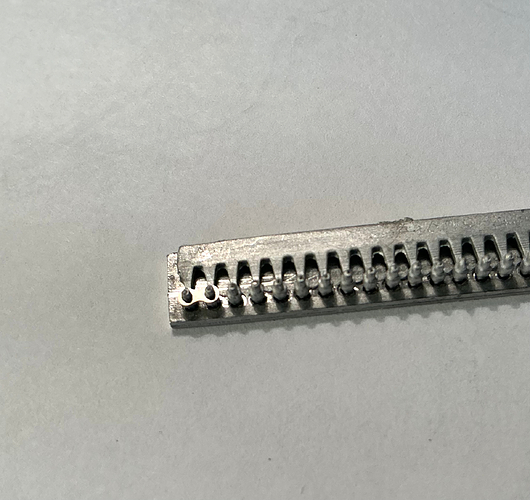

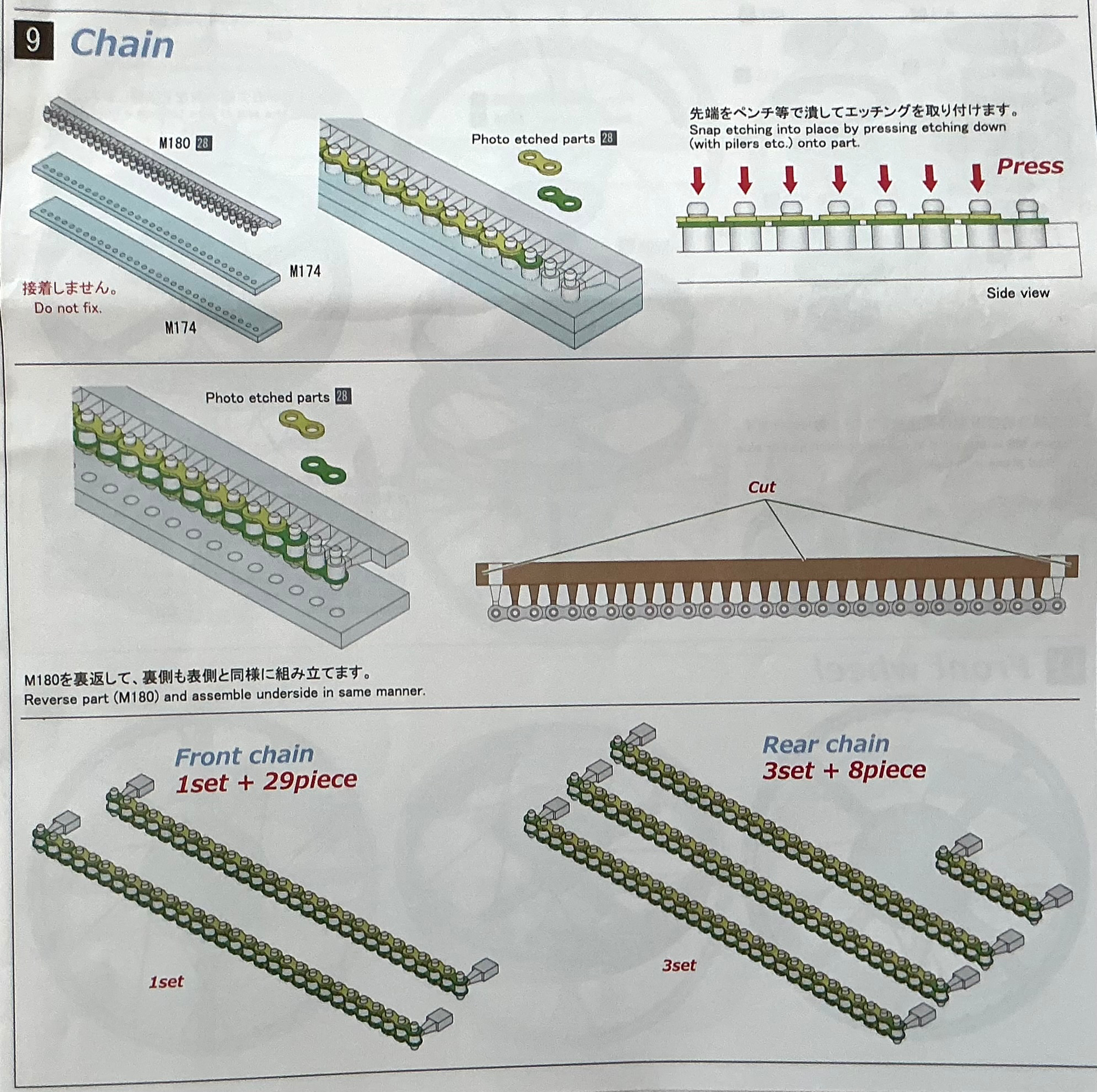

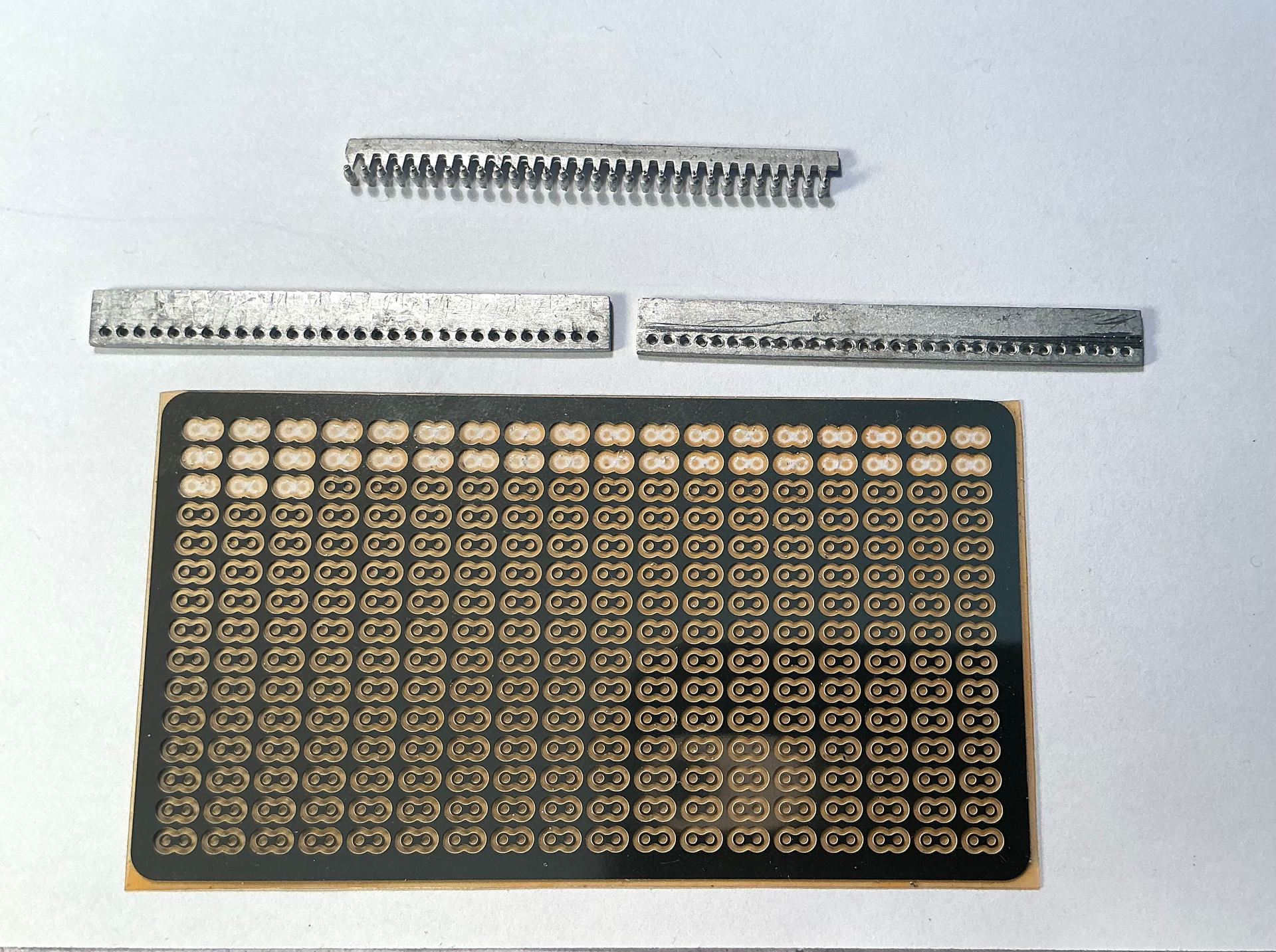

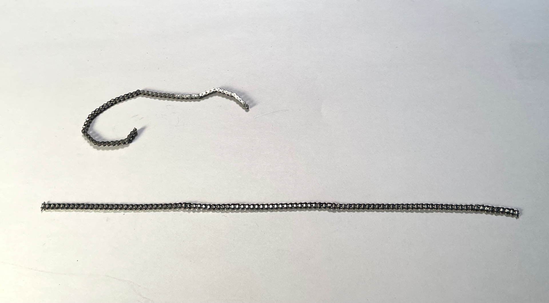

I’ve been working on the chains - primary drive ( from engine to gearbox ) and final drive ( gearbox to rear wheel. MFH supply rollers cast in groups and fixtures to hold rollers while photo etch links are assembled to the rollers . The pins on the end of the rollers are then squeezed with plain jaw pliers forming a rivet like fastening . The sprue on which all the rollers are attached is then cut away . Very tedious and repetitive work but now it’s done.
Glad to have this phase behind me.
Cheers - RT

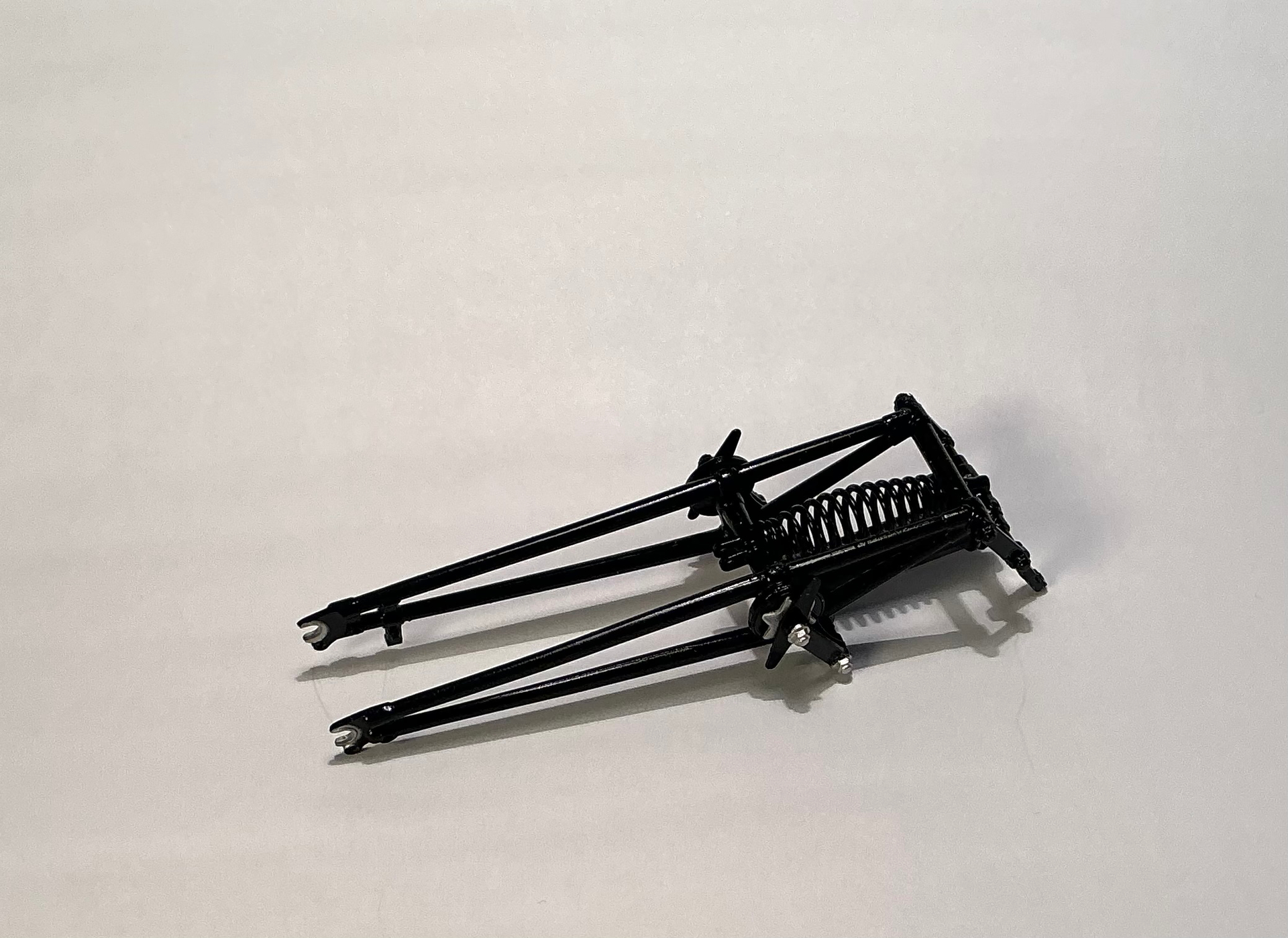

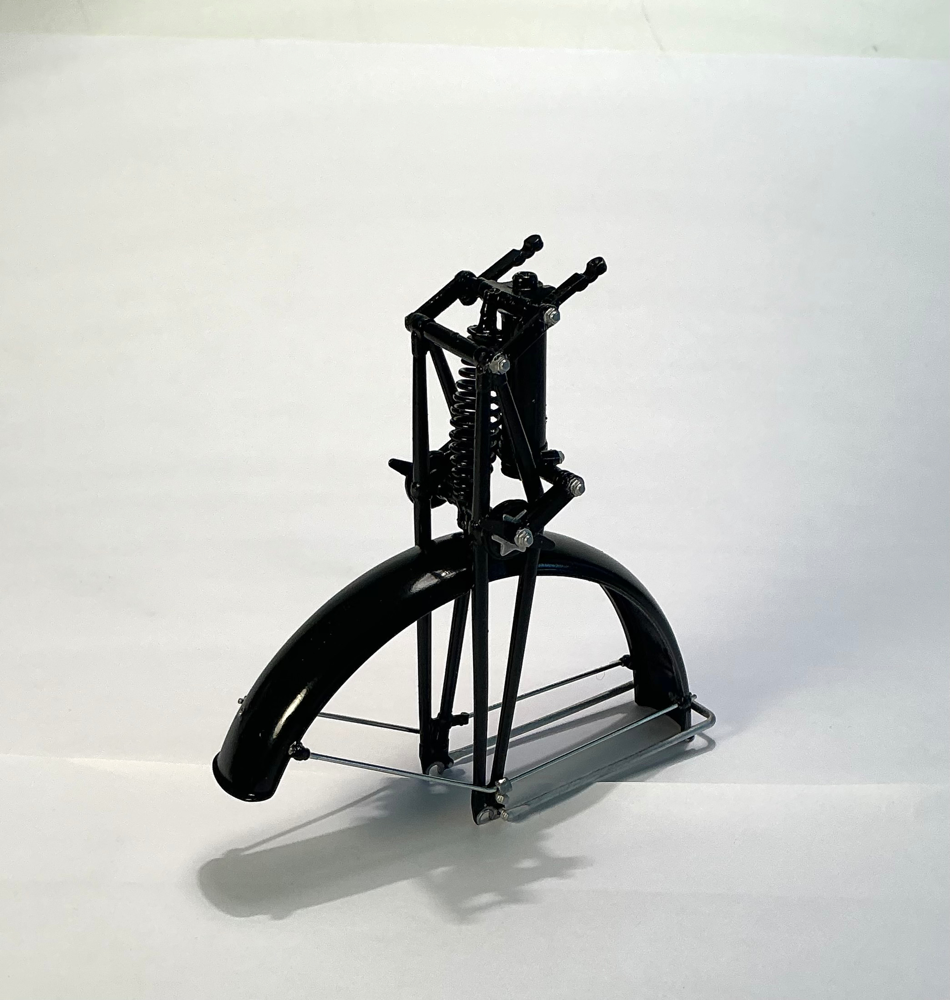

Front end work - mudguard and stays fitted to forks -

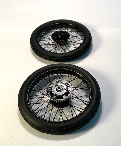

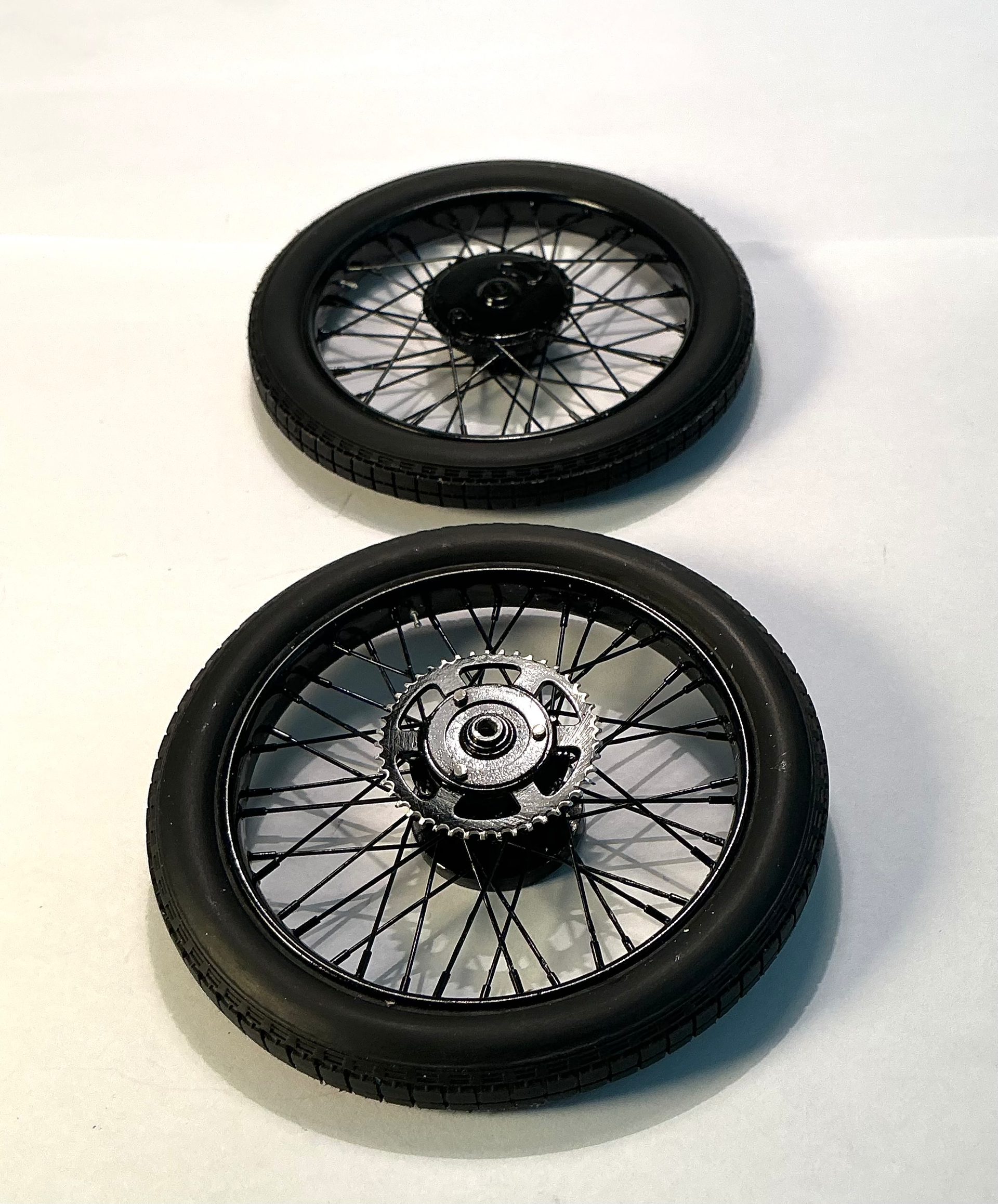

And wheels built and painted , sprocket and brake drum added to rear wheel.
