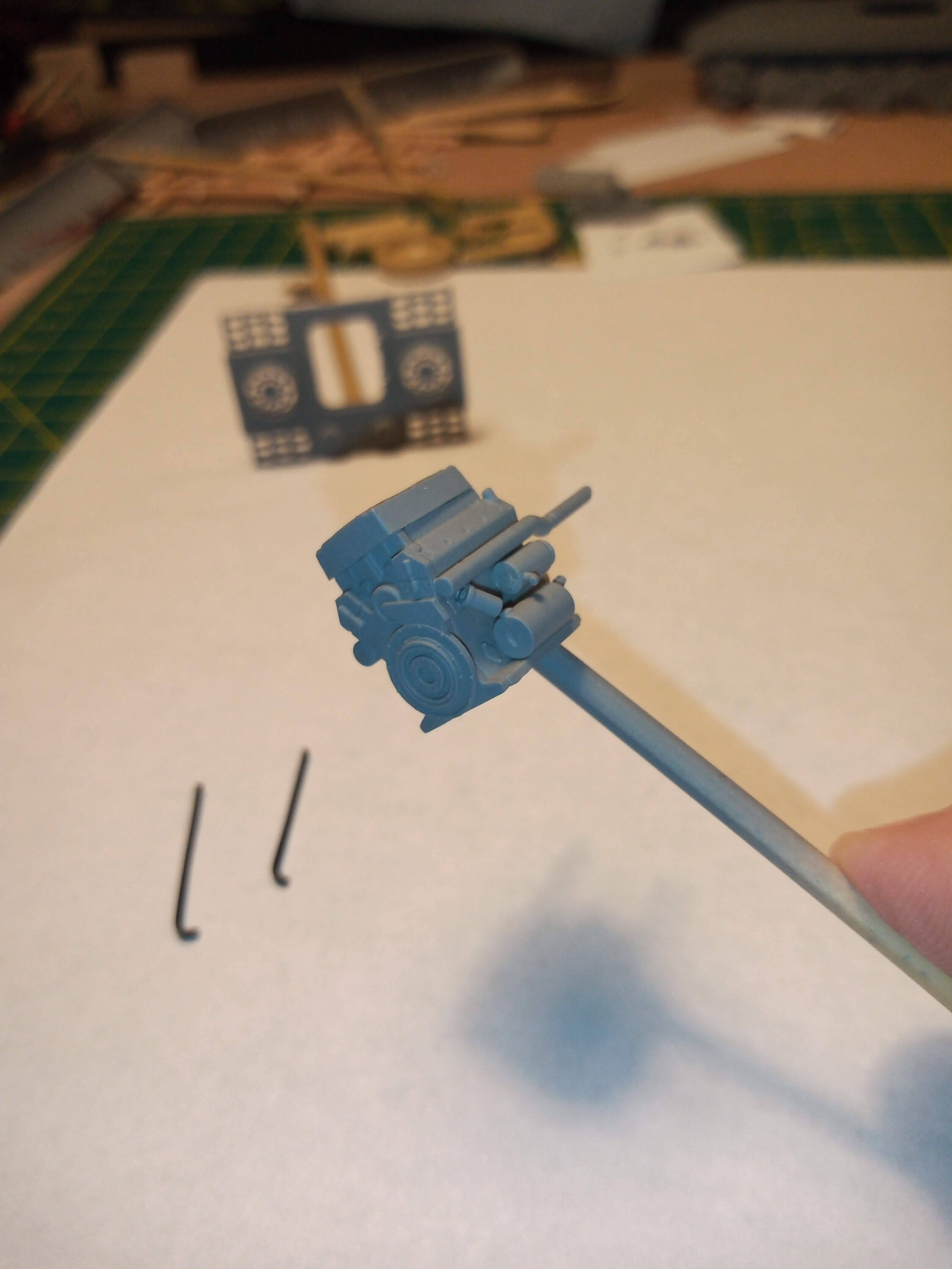

Engine is ready for paint and the 2 black bits in shot are small diameter electrical cable to act as coolant pipes once engine is fitted.

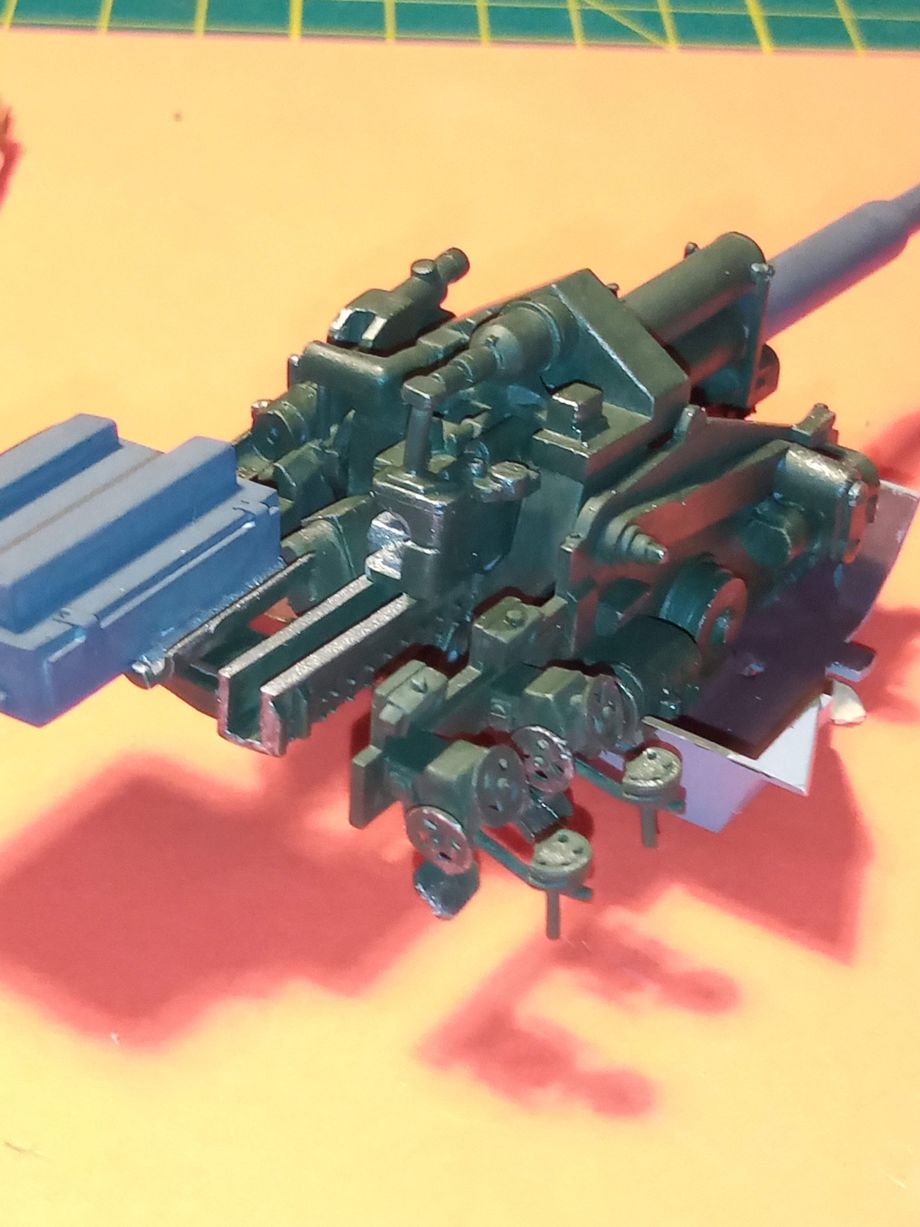

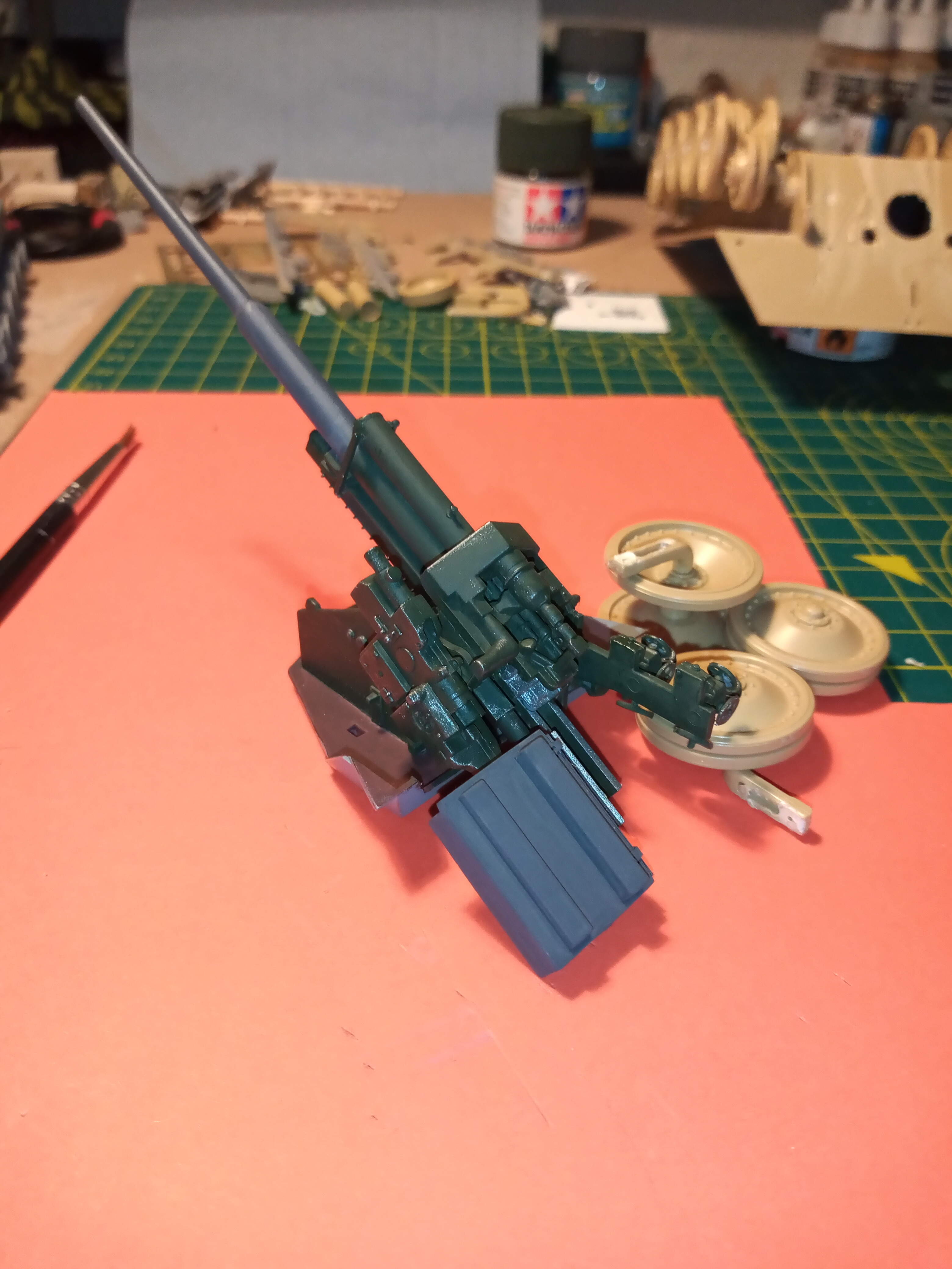

I decided to go a bit mad with the gun.
As it’s going to be in theory semi automatic, I thought about trying to make a large ammunition ready box to feed in ammo…
The ammo box is actually an old radiator from the spares box. With a supposed feed door added on the side.
I quite like the ammo feed box, doesn’t look or sound to crazy does it ?
Just need to figure out the best colours to paint the gun assembly now. Barrel will be finished in dark grey.

Have also painted up the engine as much as it needs if I do have the deck up. And will fit that in later.

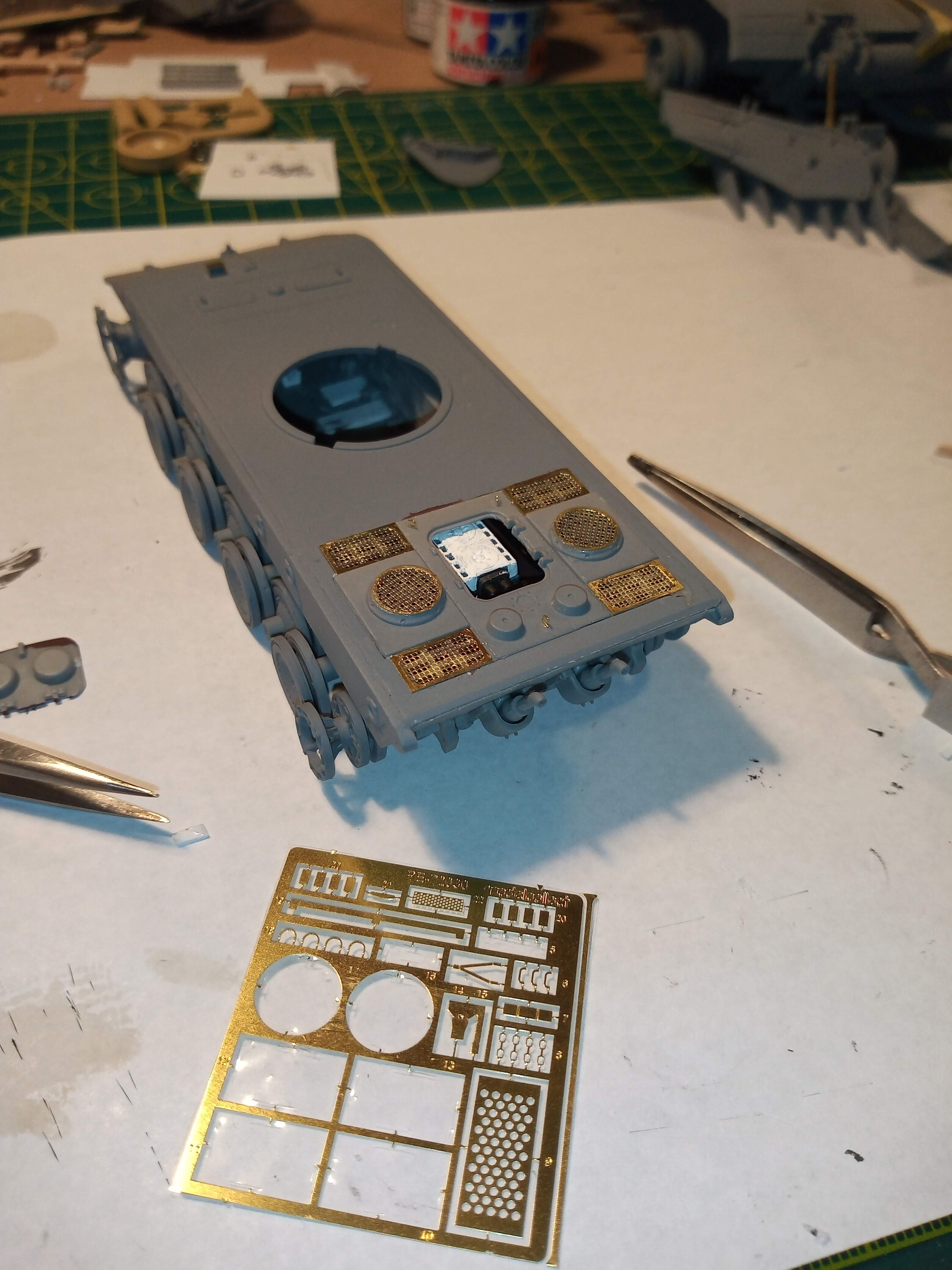

Engine in and engine deck down. PE grills and driver’s sight cover fitted from the PE fret.
Got some paint on on the gun assembly and inside the turret.
The last 2/3rds of the barrel were meant to be dark grey, but I may have to redo it and mix some black into it as I’m not happy with how light it is. The ammo ready round box is German grey and the gun assembly is one of the Japanese greens.
