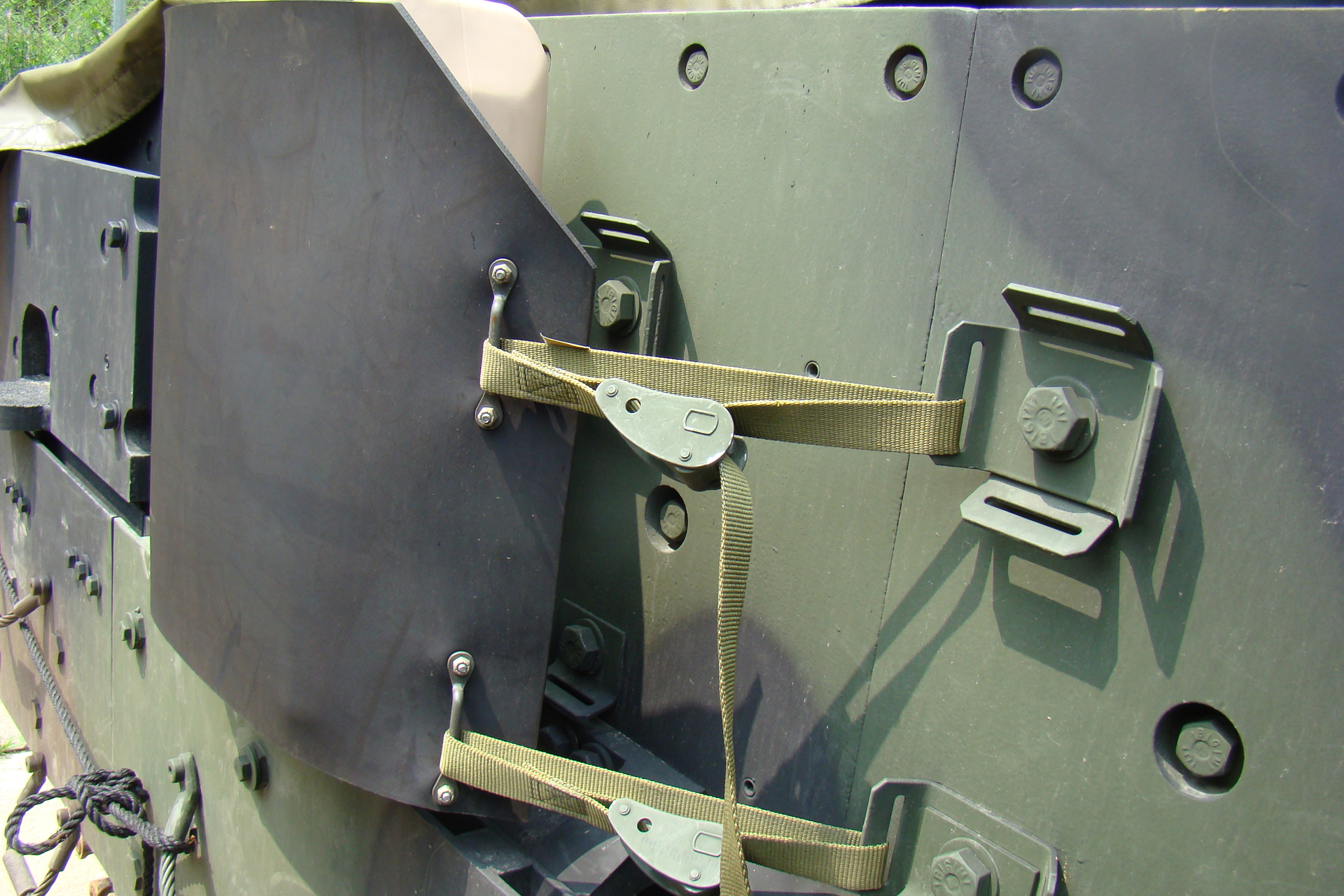

Straps can come in various shades of OD. These are almost a yellowish shade:

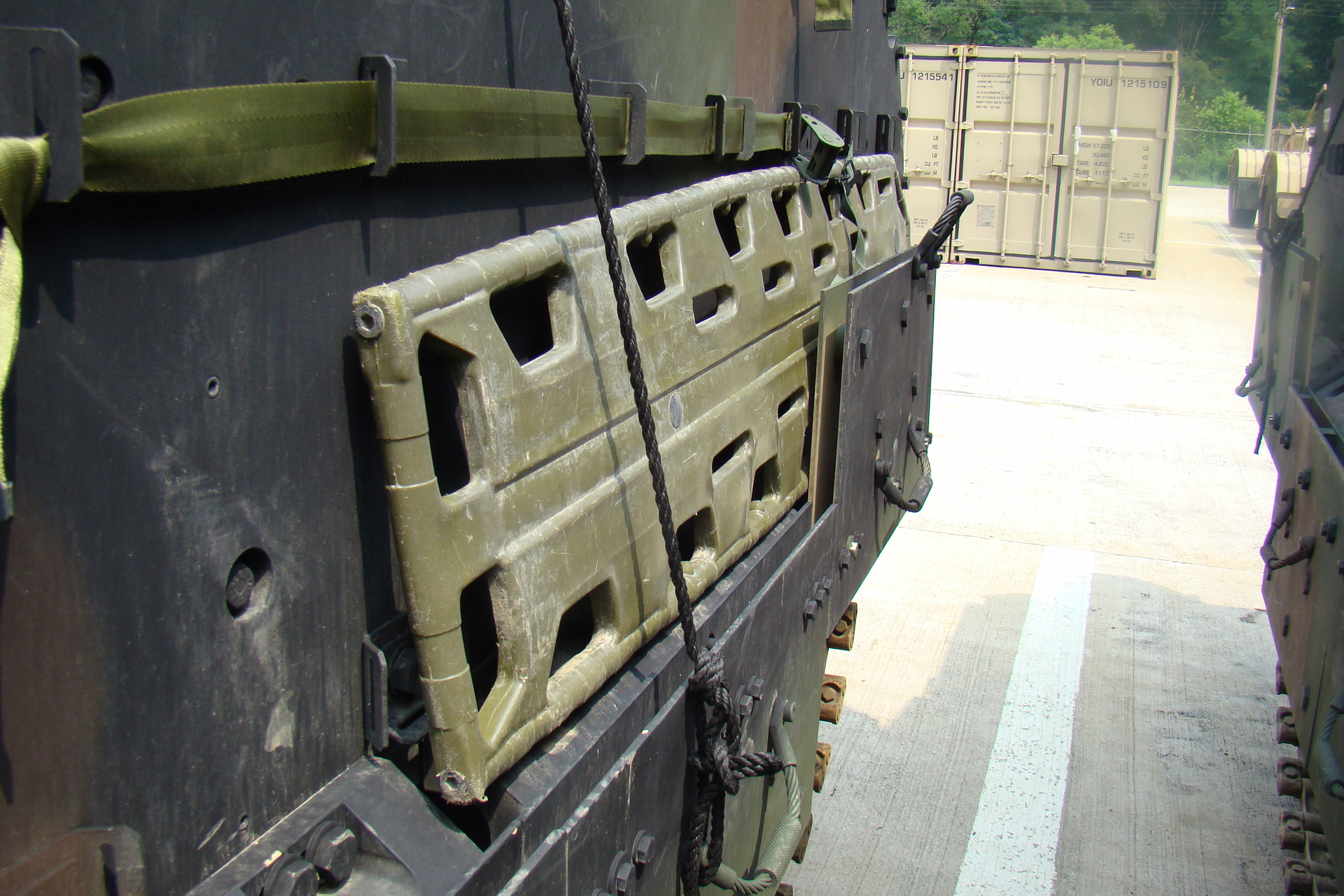

I never saw any black ones myself. But I did retire back in '07. But the green ones, yeah, after starting out as olive green they took on multiple shades… often getting soaked with diesel fuel or motor oil, then absorbing whatever local dust is in the area, never to be olive green again.
Black, tan, and green all in one photo.

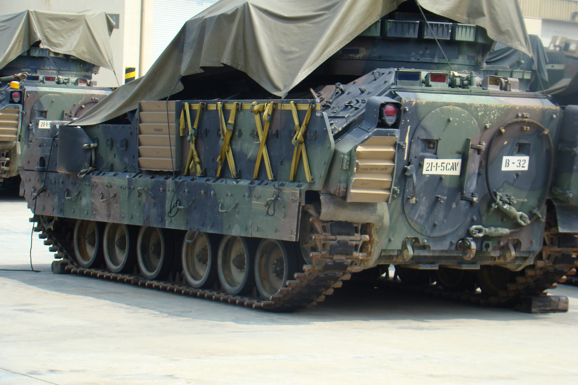

They also fade like hell in the sun. Many straps remain attached to vehicles such as the Bradley or Stryker.
There’s also yellow…
