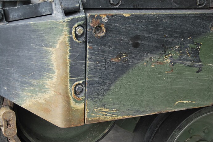

Sand / yellowish tone for basic anti-rust primer
My thanks to CAVTrooper, SableLiger and Chnoone regarding additional clarifications on the bag inside the hinged external armor, and the photo showing the worn away camo paint and the yellowish primer underneath…something I have not yet addressed. My Leopard 2A7 has been on hold since prior to my first post of this thread, and this info can be used when I restart the build! Great stuff, gentlemen!
