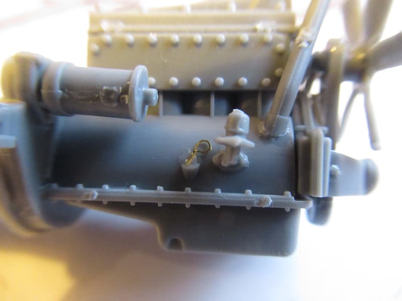

The Engine is, as usual, the start point. it’s conventional assembly.
one little nugget is the PE dipstick, perfectly correct, in fact it looks the same as the one on my Morris Minor Pickup, nice little detail. There’s a fair amount of cleanup here, the attachment points to the sprue tree are quite substantial.

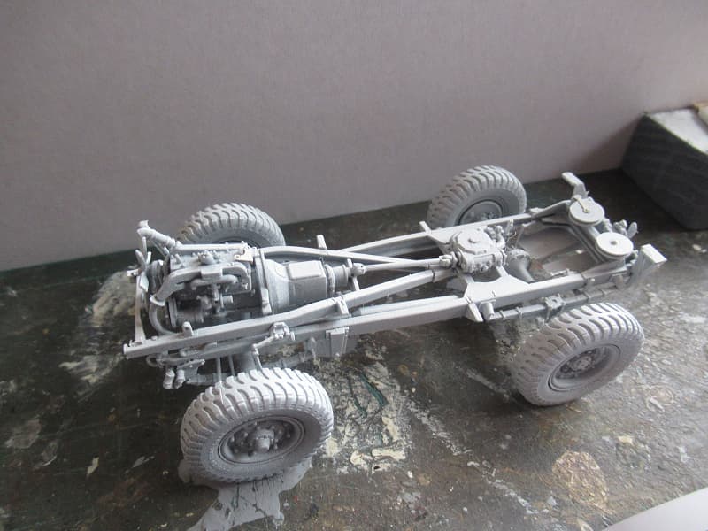

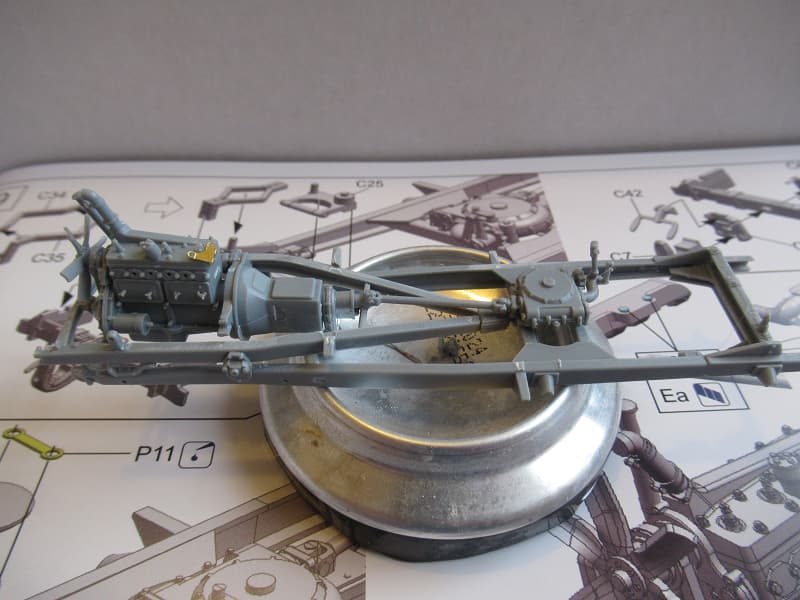

Here’s the chassis with the first prop shaft installed.
Great start

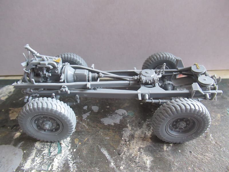

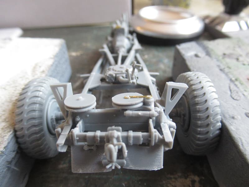

the rear of the chassis is a busy place, with wheel chocks stowed underneath. the first two wheels located, with wood blocks holding them straight while they set.
I will look forward to seeing the end result if this is the standard of build so far .

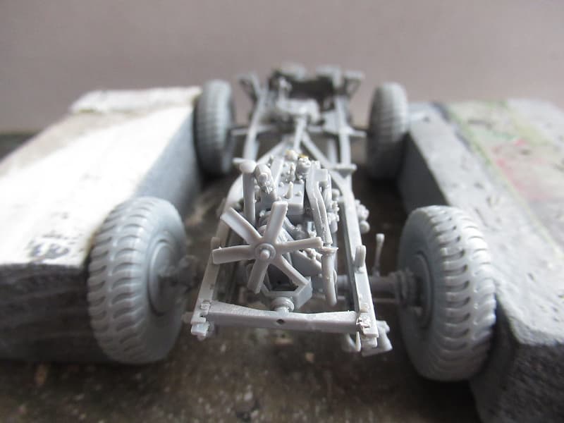

The front axle needs care taken to ensure it lines up ok, the wheels held in position here while they set hard, then there are still a dozen fine parts to fit around the front hubs including the steering linkage and hydraulic brake hoses.
the short sturdy chassis and large wheels gives this truck a solid look.

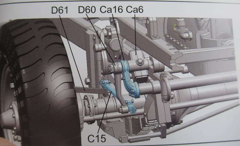

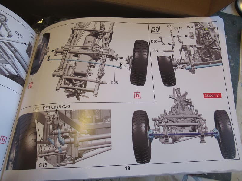

The instruction book is excellent as I’ve said, great confirmation schematics as follow up on build check.

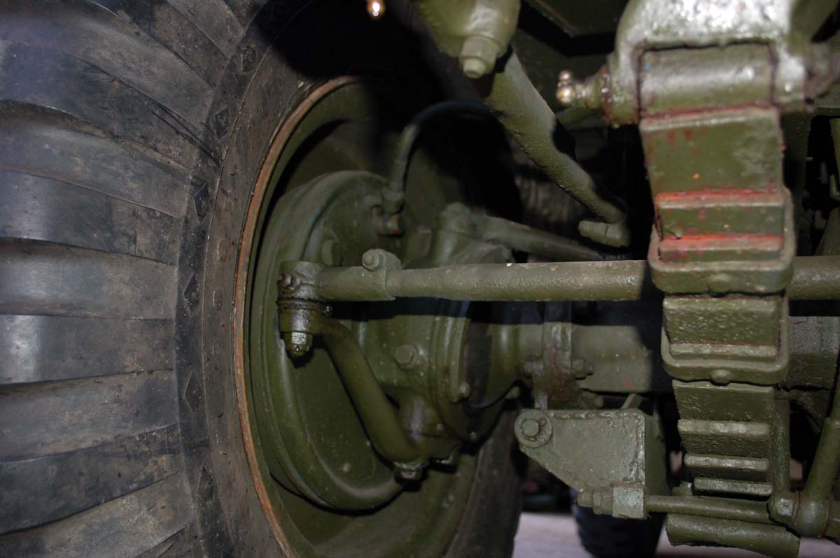

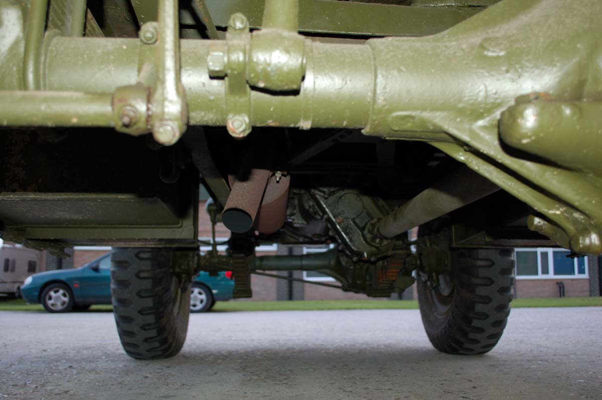

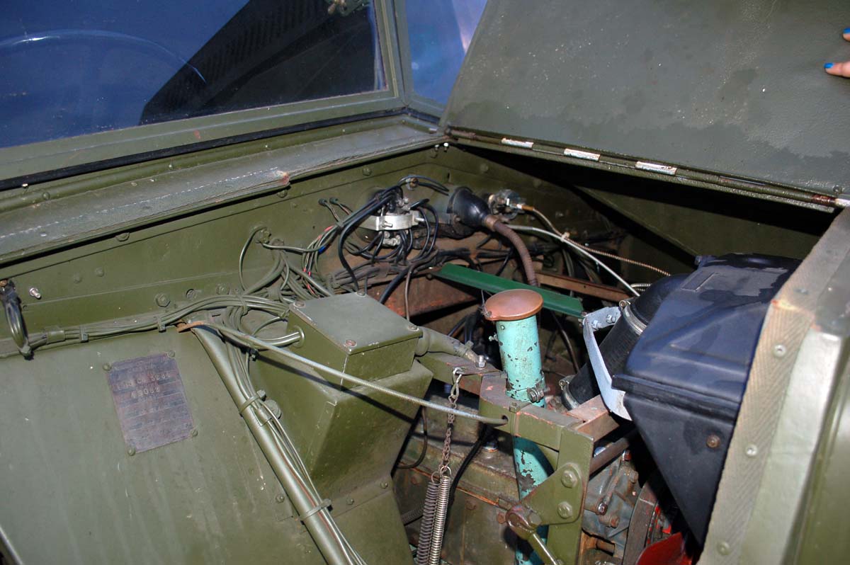

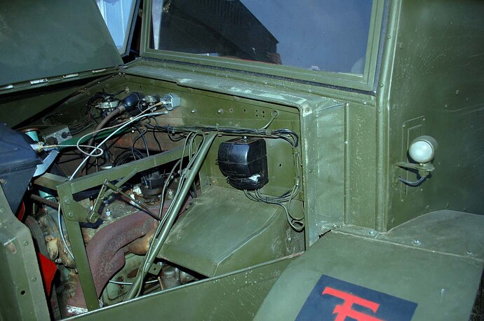

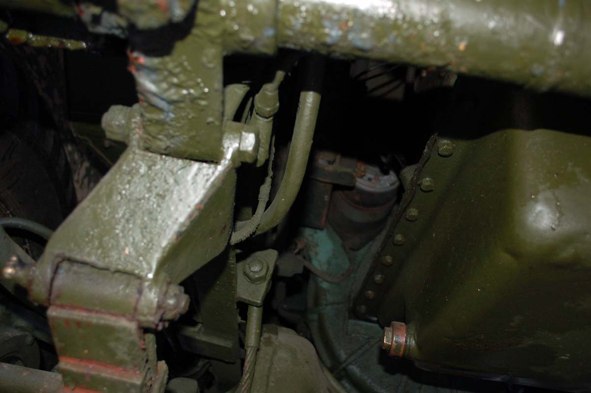

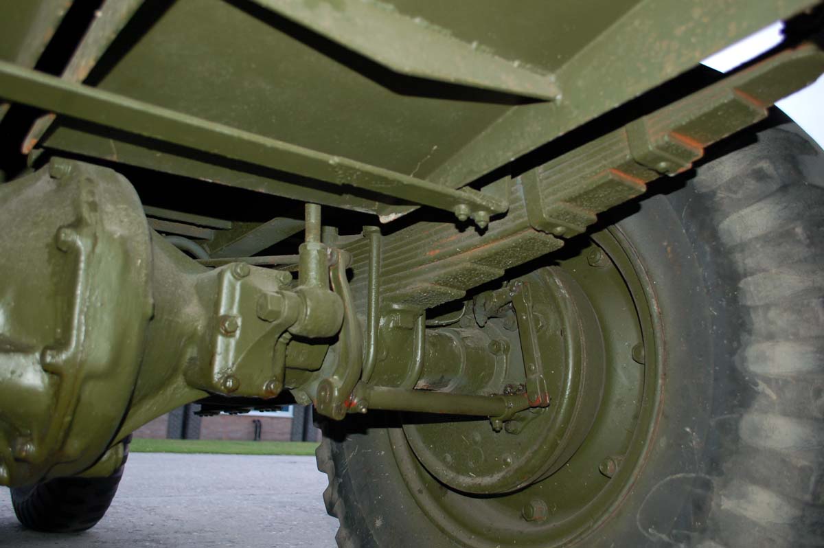

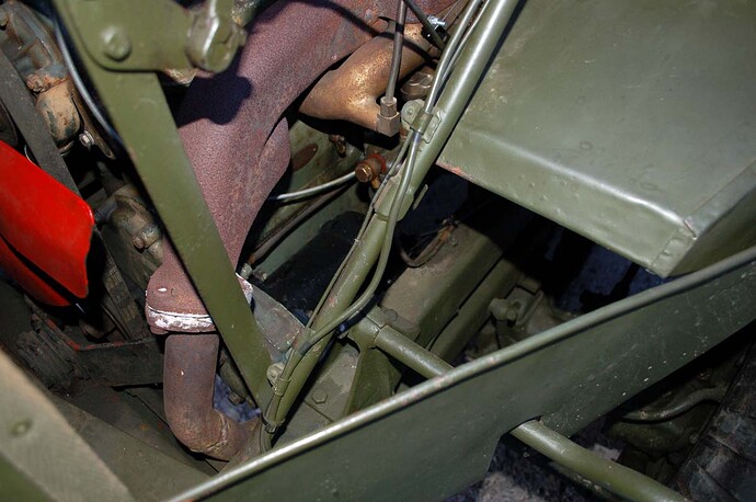

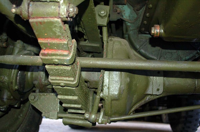

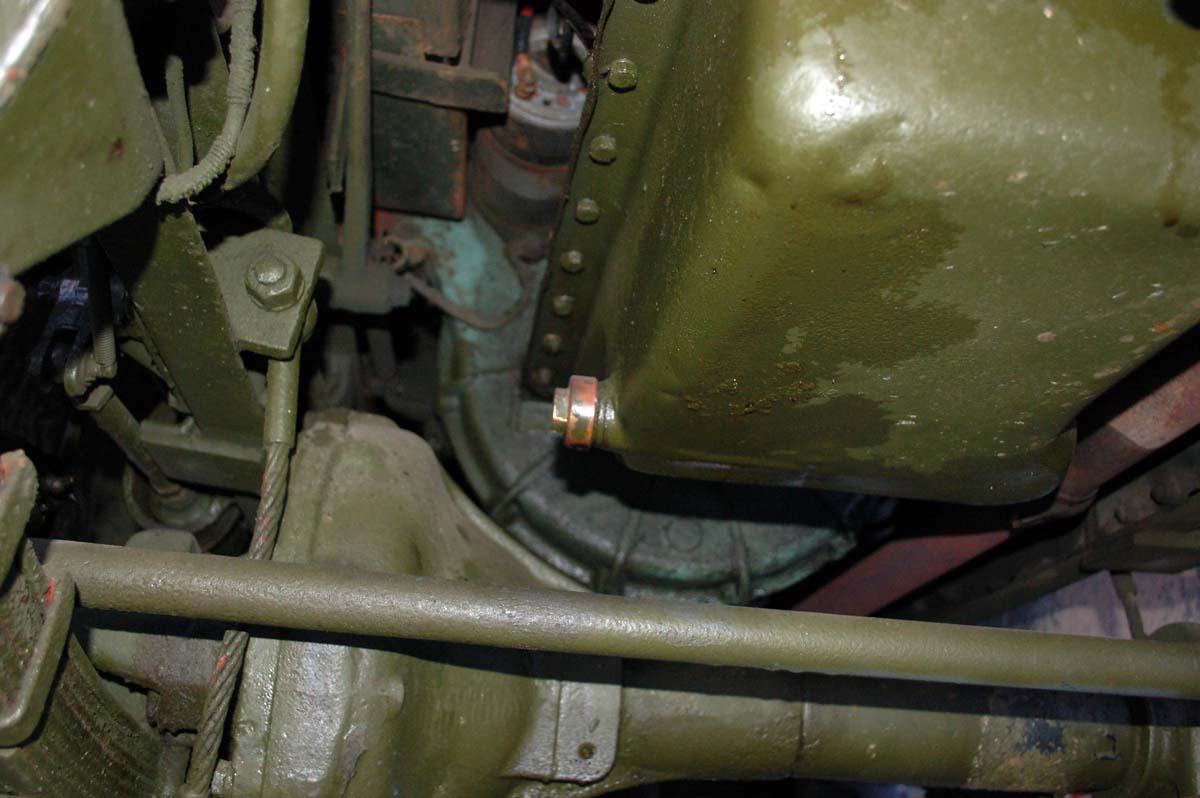

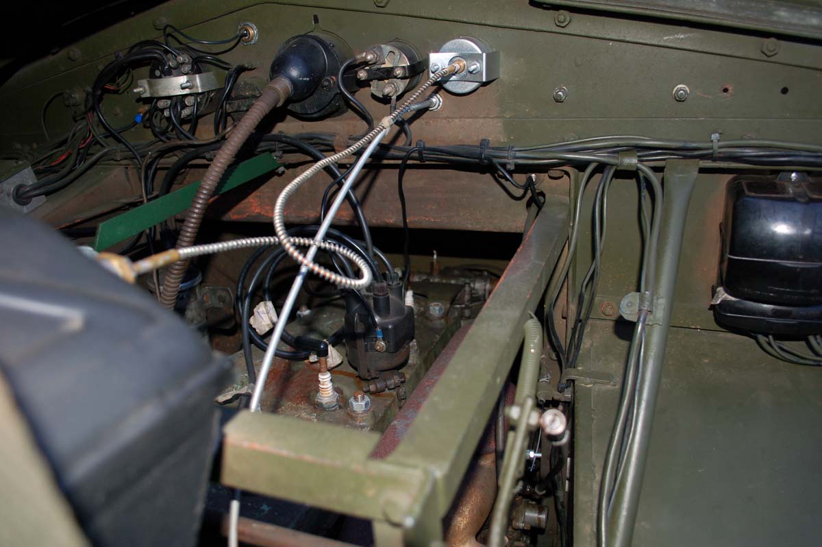

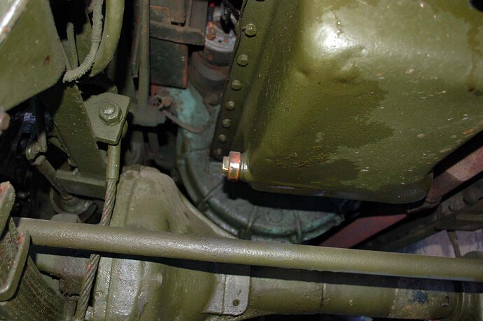

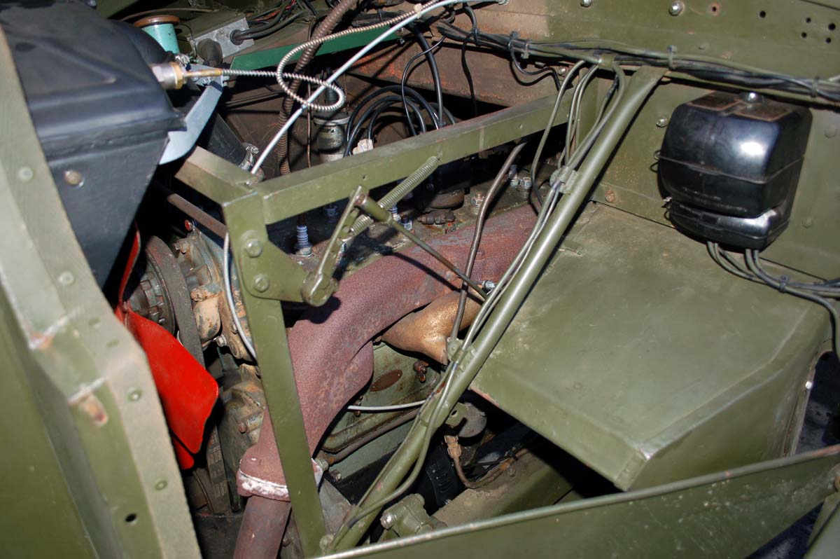

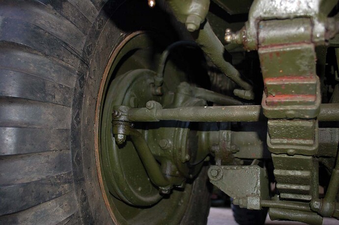

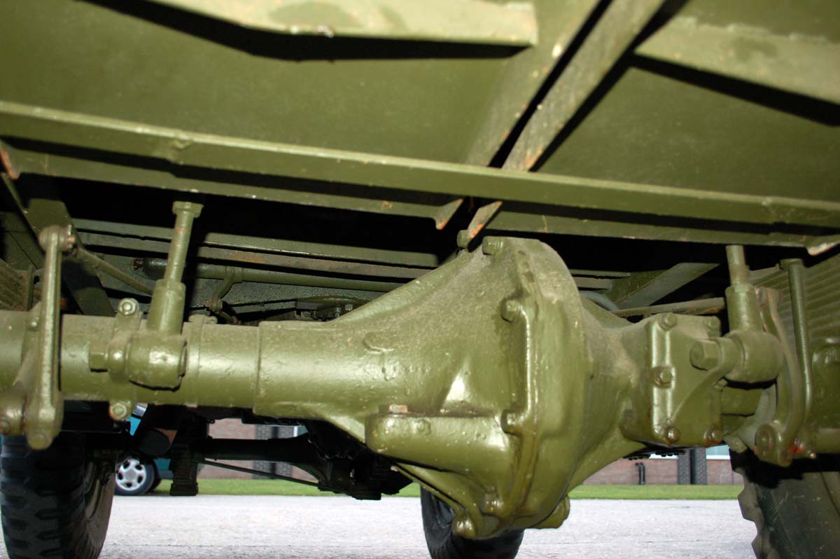

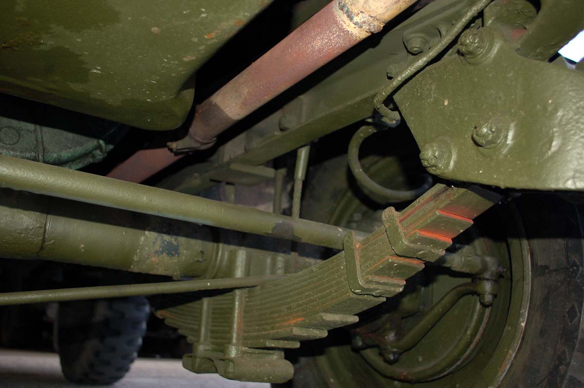

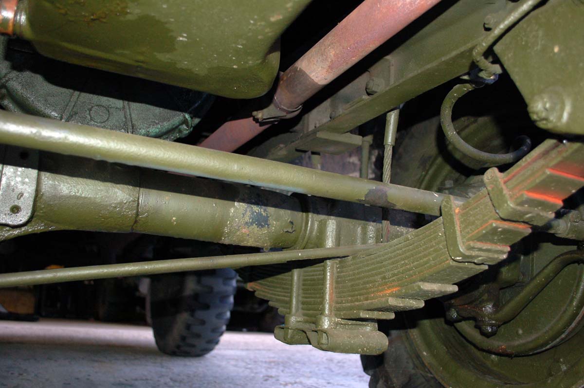

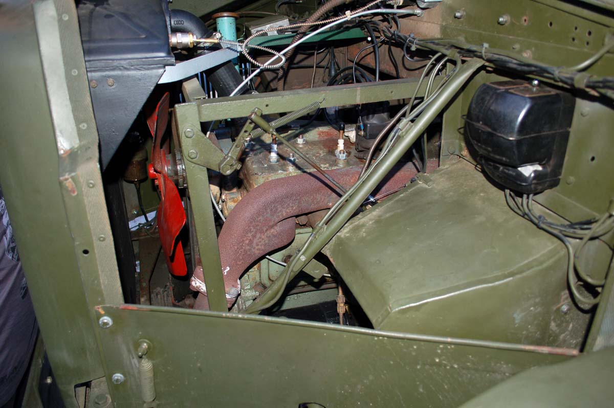

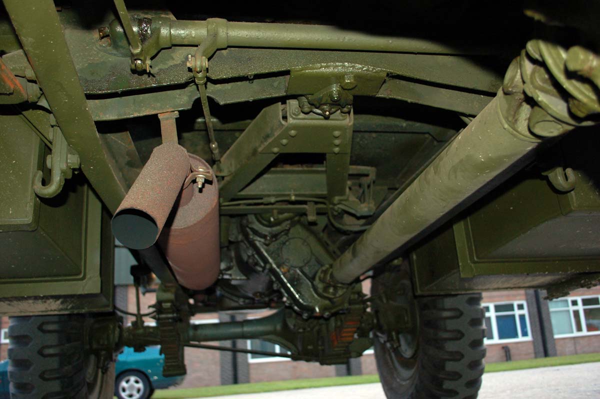

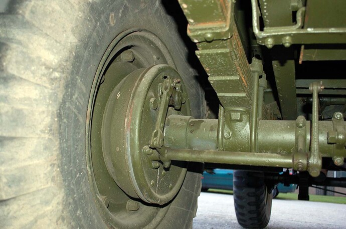

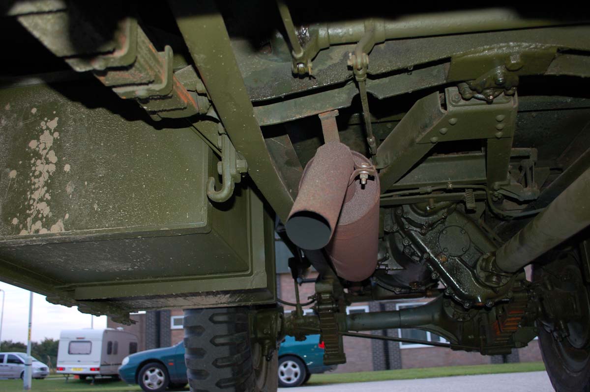

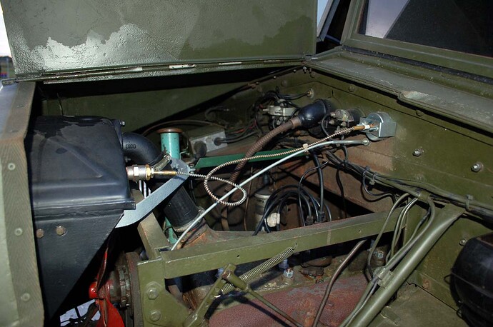

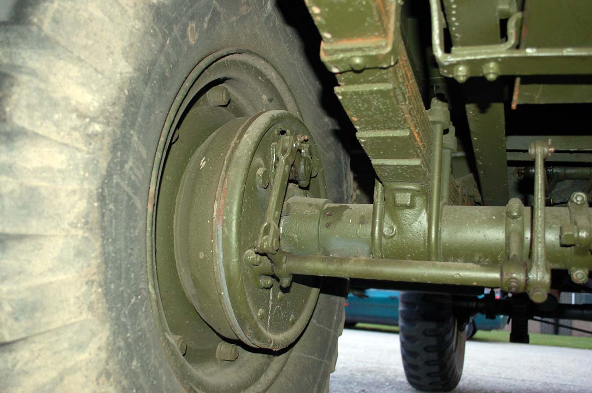

These may help
Very helpful CMOT, nice clear views, just what I need right now. Cheers for taking the time and effort to post them.
Note the front axle over the leaf springs the rear axle is under them.
Glad they are of use.
Yes front over, rear axle on below the spring, complex build this one, I have to let each stage set properly before moving on or it could get messy rather fast. Painted in a light coat of white primer, when it’s dry I’m going green chassis, light stone Desert coloured body.

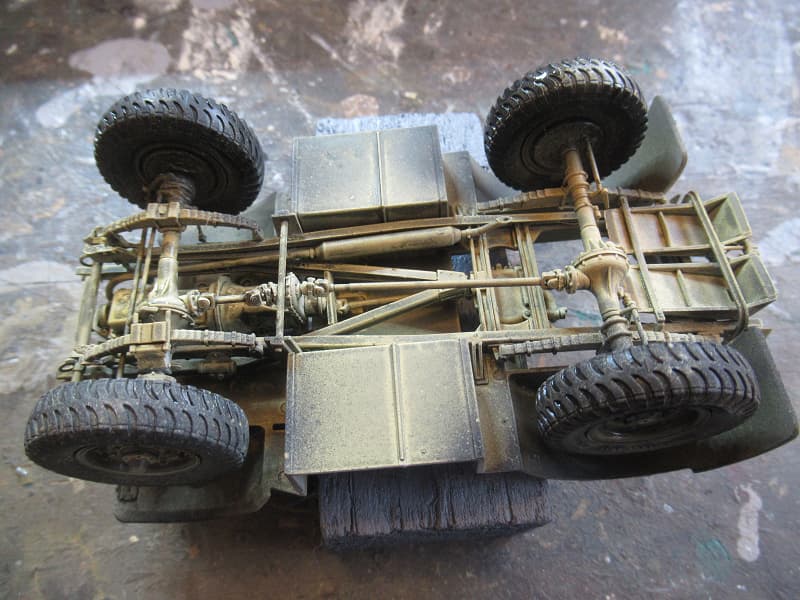

I’m using an over thinned airbrush coat of green to fill in the lower areas followed later by a less thinned light coat of Desert sand, to appear as sand staining under here.

building up base coats, allowing the thinner yellow to stain the white areas.
Wow. That’s a really excellent effect! Nice tones.

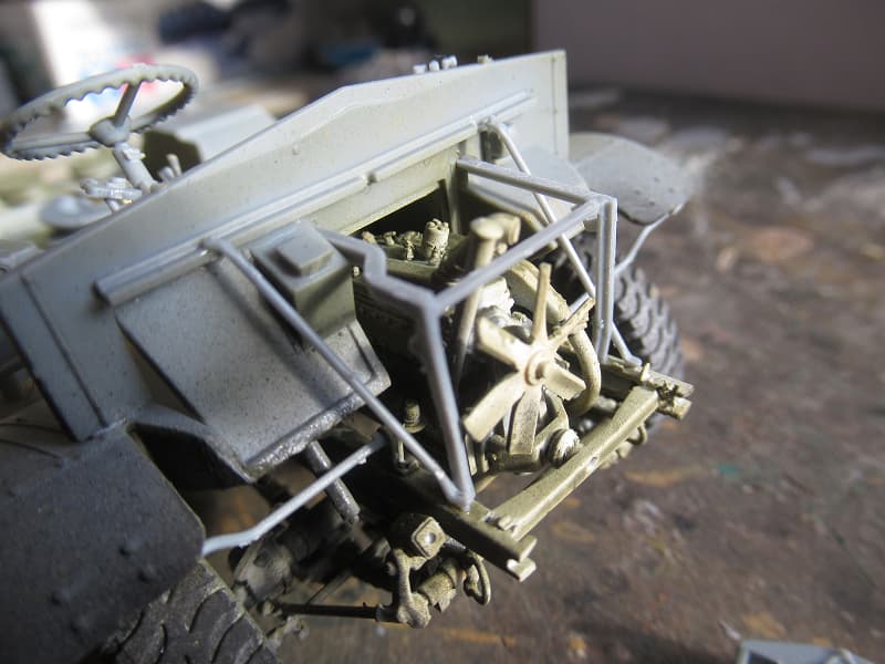

adding the framework around the radiator

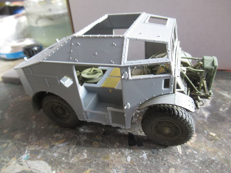

never too early for a test fit, just to make sure everything is lined up right.
So what is the purpose of this odd body shape?
Nothing odd about it Dan, it was a vehicle of it’s time, it’s Purpose was to tow a gun and limber, for that it needed to be sturdy and powerful with excellent traction, it had to transport the gun crew and all their personal kit and small arms, it wasn’t a general purpose truck, so the body was closed off. Keep watching the build, your question may answer itself.
