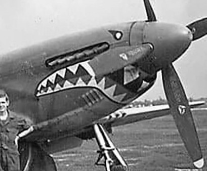

What is the story with the vents on the nose of the P-51? Most have a perforated cover (like P-51K.). Mustang IVs have a louvered/ gilled one. If they were just L-L 51Ks why the difference? And, from what I have seen (hardly exhaustive research) it was just the Mk.IVs that had them. A Brit mod? Limited NAA/Dallas quirk?
“The perforated cooling vents on both sides of the nose are often associated with Merlin Mustangs, but these panels could be replaced with solid ones for cold weather conditions. Also, many Mustangs supplied to RAF and Commonwealth had these vents covered with louvered panels.”
Thanks. Those solid ones must be for REAL cold weather! Photos of F-51s in Korea and J-26s all have the perforated covers. And neither locale is known for its “balmy” weather.
