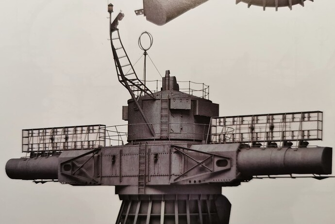

Final plastic works continues with the top 15,5 mtr. Rangefinder with the Type 21 Go Dentan Kai 3 Air search mattress type antenna and top Type 94 Hoiban low angle director. Here I stumbled into some small problems: The railings around the top of the rangefinders had the top half bended 45° outwards to create more space for the turning rangefinders below the fixed Hoiban turret.
KA-Models provides you nice crisp railings but they are just even. Tamiya´s Premium kit includes railing stanchions which have this bending but they are looking way too thick in my eyes and all the efforts which installed these and fiddled thinnest lead wire through them didn´t look too convincing in my eyes. So I had three options at hand:
  1. Leave everything even - the rear extension arm of the Hoiban turret will interfere with the even railing…
  2. Use Tamiyas thick stanchions and try my skills with making railings out of thin wire
  3. Partly bend and alter the rear railings so that the Hoiban extension do not interfere
  4. Bend and alter all the railings around the Rangefinder
I finally decided for Option 3 as Option 4 will be very difficult. It was difficult enough to correctly bend this railing around the Rangefinder platform as KA-Models does give you just vague informations (just two small photos which show the installed railing…) how to bend this irregular railing. I did my best but had to add one small piece of railing later…
At the beginning the even railings look like this
After fixing the rear railings to an about 45° list it looks like this. The missing top rail connections were closed with superglue gel.
Time to finally finish the Hoiban turret. The missing diagonal top radar device near the top lamp of the Hoiban turret was installed from the KA-Models update parts. It was not mentioned in the instructions but the parts were there and it was mentioned in my reference book. The top periscope was the last spare one from my YX Model update set.
In the end now everything looks this way and the two sections are awaiting painting

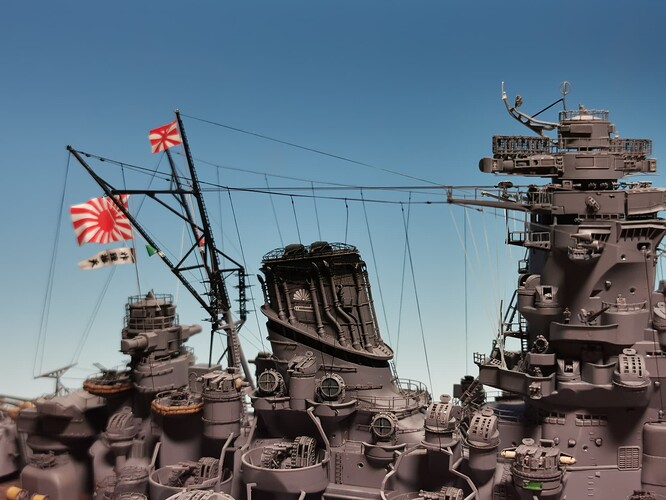

I found time and motivation to start some small rigging and I already raised the flags. The flags were made out of paper and both sides had to be glued together and shaped with in white glue diluted water. After drying the flags retained their preformed shapes :yum: :+1: The inner, finer rigging wires were made out of INFINI Fine Black lycra rigging 70 denier, the thicker main rigging wires and the flag ropes were done with fine EZ Line rigging wire. The red and green speed cones were taken out of RAINBOW´s etched Feeder and Speedcone set

Gentlemen I did finished the rigging of the late Yamato. The work was going straightforward and with no problems at all. I just had to look and to match my reference book with fotos and other builds. My small cruiser Emden some years ago was way more difficult to rig as this Yamato. Here are the pictures
So now there´s not much more to do until this build is finished; just the outer railings are missing, then Yamato can launch her last cruise into my cabinet :innocent:

Thank you so much Jan! Doing the rigging is not so much difficult as it seems. It depends which kind of material you do use for this job and how you do it. I started with EZ line rigging wire which I still use until today. They are just a bit thick for me now, I just use them if I need thicker wires. Mostly I use now INFINI lycra rigging in different thicknesses. They are very flexible and one can cut the superfluous wires over the end comfortably with a fresh sharp modelling knife blade. If the wire tension is accidently too low you can heat a metal rod with the lighter and carefully get near the loose wire. Because of the heat the wire will tighten.
I also have superfine metal rigging wire from MODELKASTEN but I didn´t used them so I can not say anything about them.
One important lection which I learned here is to start rigging from the middle to outside just because it will be much more difficult to make a proper rigging if the outer wires are already installed. Just try it, it can be fun!
