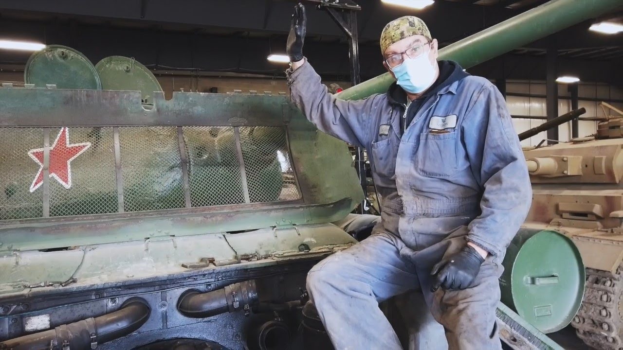

Good images, thank you. But looks very different from instructions, the walls seem dark grey and not hull red. The filters look dark steel with traces of black paint, I’ll look for something lighter than gun metal.
