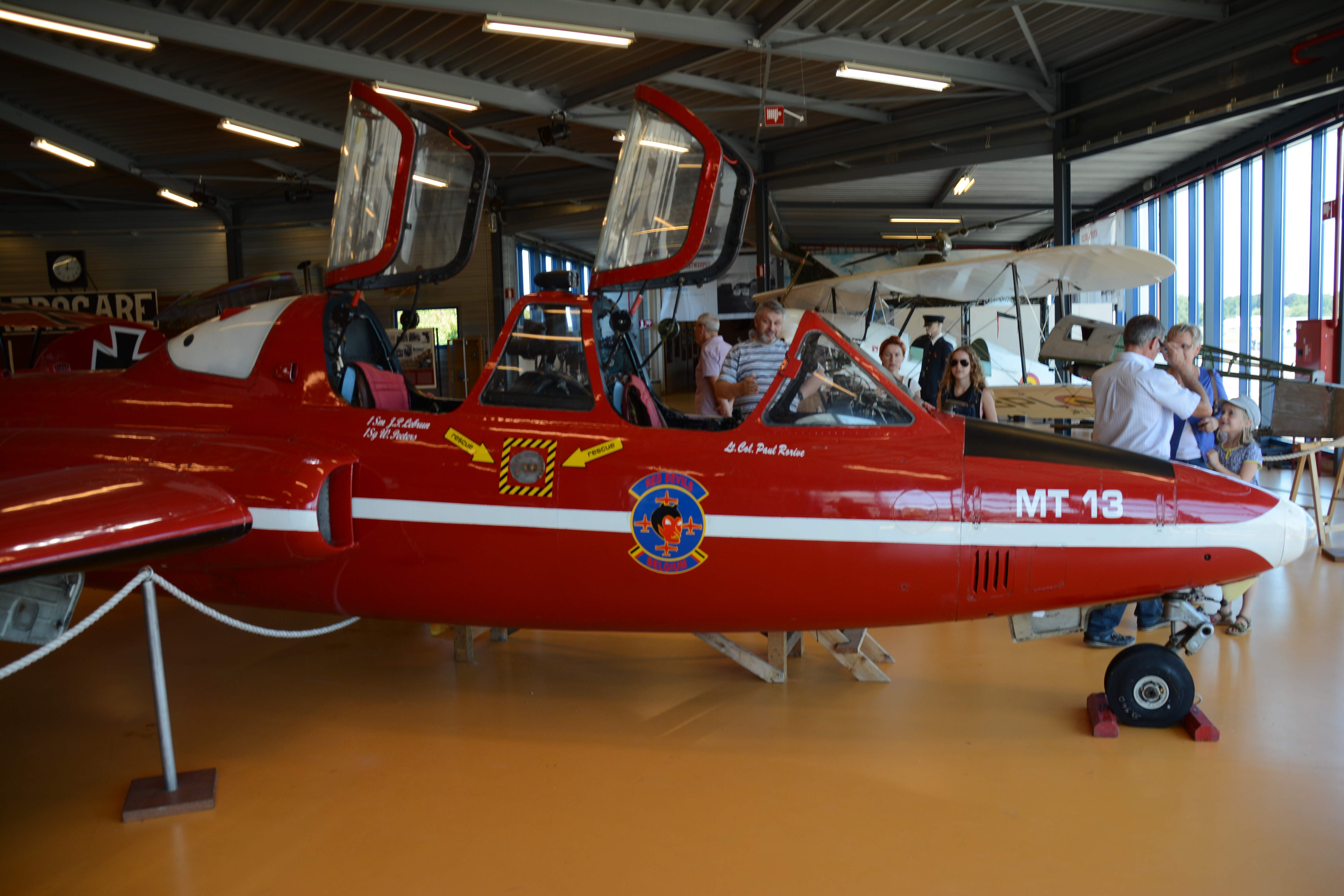

and then there are those planes with a double canopy like a trainer:

I am building the Belgian “Red Devils” , an acrobatic team flying 6 shiny red Fouga Magister in the 1970’s.
I have 3 Kinetic boxes (1/48) and got a set of extra decals from a friend. I still miss two sets of decals.
