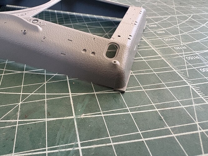

I like the 75mm version better, I think it’s a better kit overall than the 76mm kit…on the 76mm kit, I think that the rear hull on the 76mm version has a very obvious angle in the back, I was under the impression that the rear hull on the large hatch should be straight up and down without a slope, I was hoping that the Sherman experts can weigh in on this…
I know there were different foundaries that made these castings so am wondering if there was one in particular that made a casting with a an angled rear upper hull plate? It’s the type of rear hull casting that goes straight across without the small cutaway on the rear plate like on some A1s

You guys, did a version of the M4A1 large hatch feature an angled rear upper hull casting? I’ve been looking at period photos and I’ll be darned, some of them seem to have that angle while others don’t…is it an optical illusion or did some of those M4A1 hulls have an angle in the rear?

Just did some extensive research and searching just to make sure - all M4A1 hulls have a vertical rear hull side.

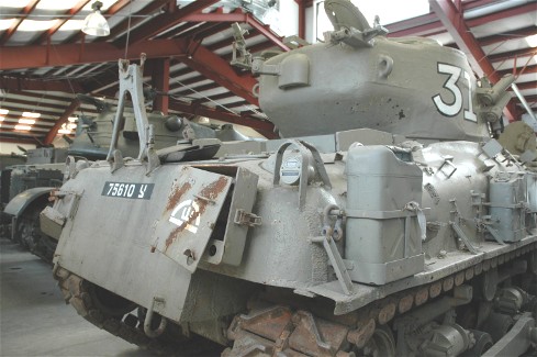

Yep, the ones modified in Israel for better airflow over the radiators for the retrofitted Cummins diesel engine.
(source)
But, of course, these had the back of the upper hull cut off and then re-attached at an angle. You can see the weld fillet for that below the tail light, where the rearmost stay for the mudguard sits against the hull.
Most likely.

I hope you guys can see the angle on these two photos. Pretty sure it wasn’t molded like that at the foundry. Yes, I’m aware of the Israeli modification but they also added an extension in the middle part which hung over top of the filters like in the photo that Jakko posted.

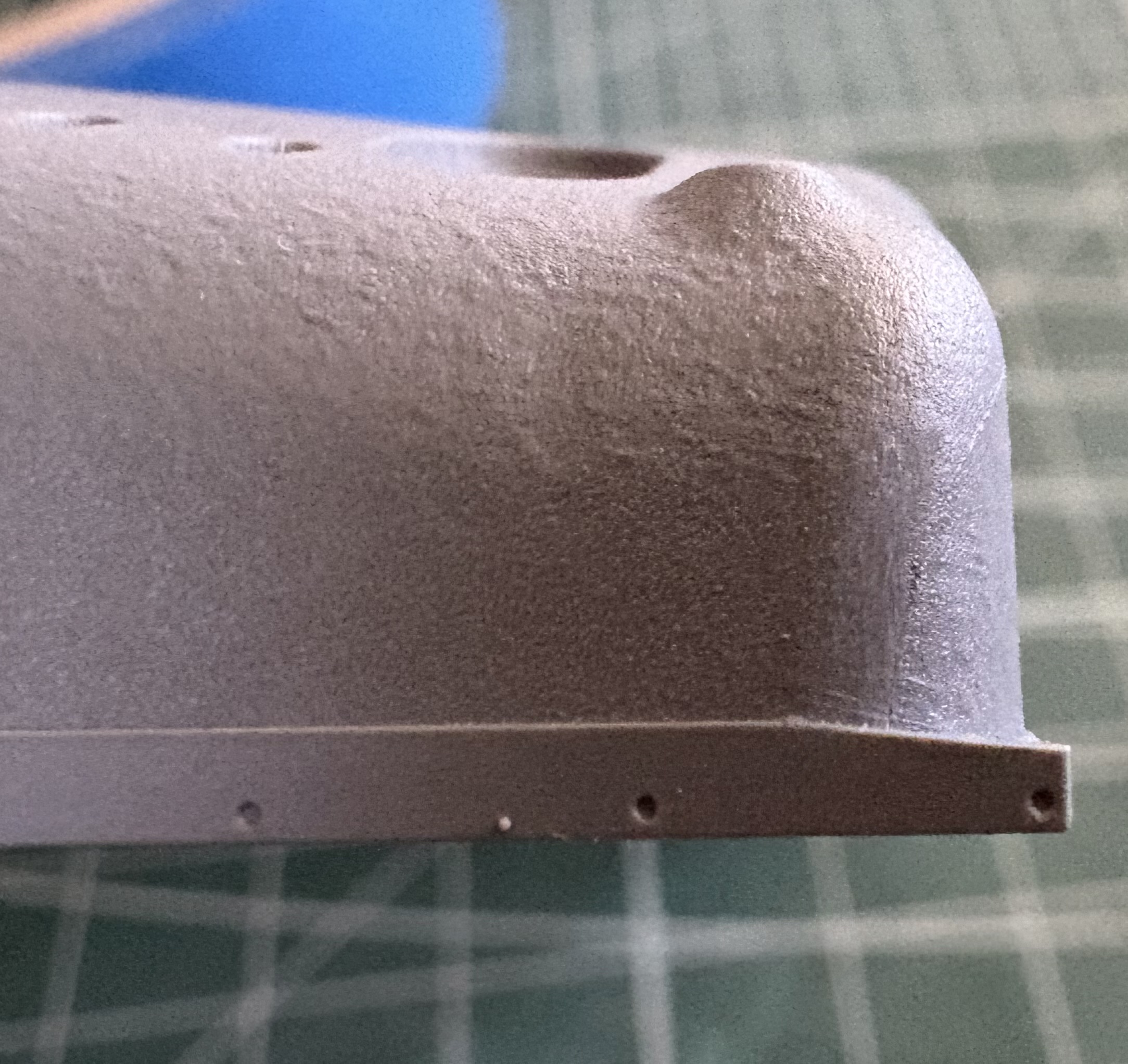

Here’s the 75mm version, no angle…
And you can see how they molded in the sand shield bracket.
