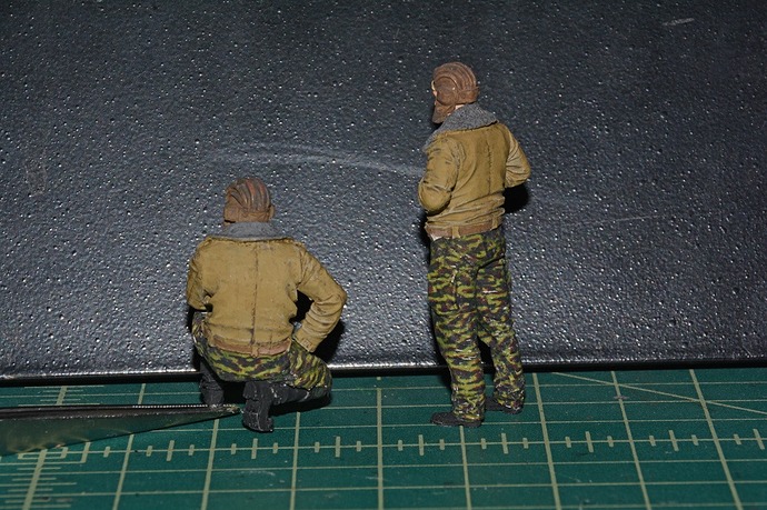

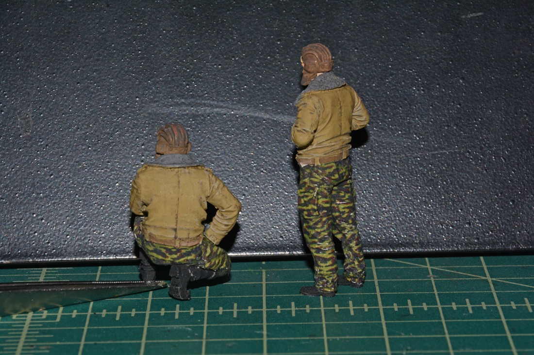

The CrossDelta decals are opaque so I prime the figures in either black or gray but then I gloss coat them so the decals stick. I also use Microscale Micro Sol for the decals to conform to the creases and folds. The CrossDelta decals also need a protective coating over them as the ink does crack and peel off over the sharp edges of the creases and folds. I coat them with Microscale liquid decal film with just a paint brush. Even though I do coat them to stop the ink from cracking and peeling off, they still do but less with the Microscale liquid decal film protective coat over them.
The Trumpeter figure camo decals are opaque as well so black or gray primer is fine if using the Trumpeter decals. I also use the same techniques as described above for the CrossDelta decals as some of the ink will also crack and peel off but much less than the CrossDelta decals.
Some other decals like FFSMC are transparent so you must prime the figures white first so that the decals show the actual colors of the ink. If you do not prime them white, the decal colors will not show properly the actual colors. The FFSMC decals are home printed so you definitely need to have the protective coating to help prevent the cracking and peeling of the ink and again, even so, they still crack and peel but the liquid decal film protective coating helps.

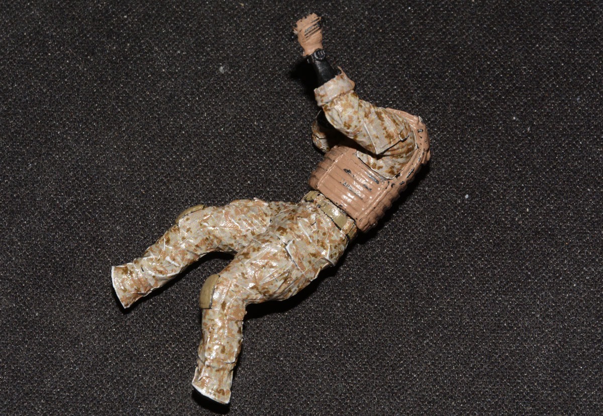

These were done using the FFSMC decals. I used the Microscale liquid decal film over the decals before applying them. There was still some slight cracking and peeling of the ink which you can see if you zoom in.
These were done using the CrossDelta decals. You can see the sharp edges where the ink cracked and peeled from. I touched them up later with a brush. This was before I knew to coat them with the liquid decal film. Even after using the liquid decal film on different figures, the decals still cracked and peeled at the sharp edges but less.

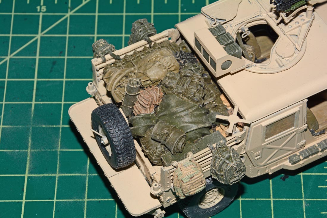

I used the Trumpeter figure camo decals on the three color desert camo backpack. The Trumpeter decals are actually very nice to use. They conform very well even without the Micro Sol. For this one, I didn’t use the Microscale liquid decal film over the decals before applying them and very little to no cracking and or peeling of the ink. I have had issues with other Trumpeter figure decal sheets cracking and peeling though so you should still use the Microscale liquid decal film over the decals before applying them to be safe.
One thing I do with the figure camo decals is, I cut them into small pieces to fit around other parts that will not be decaled. Those areas will be hand painted. It is much more time consuming and tedious but looks better overall when finished as the decals don’t cover a lot of the details. In this photo, you can see where I cut the decals into the small pieces and fit them around the areas that will be hand painted.
